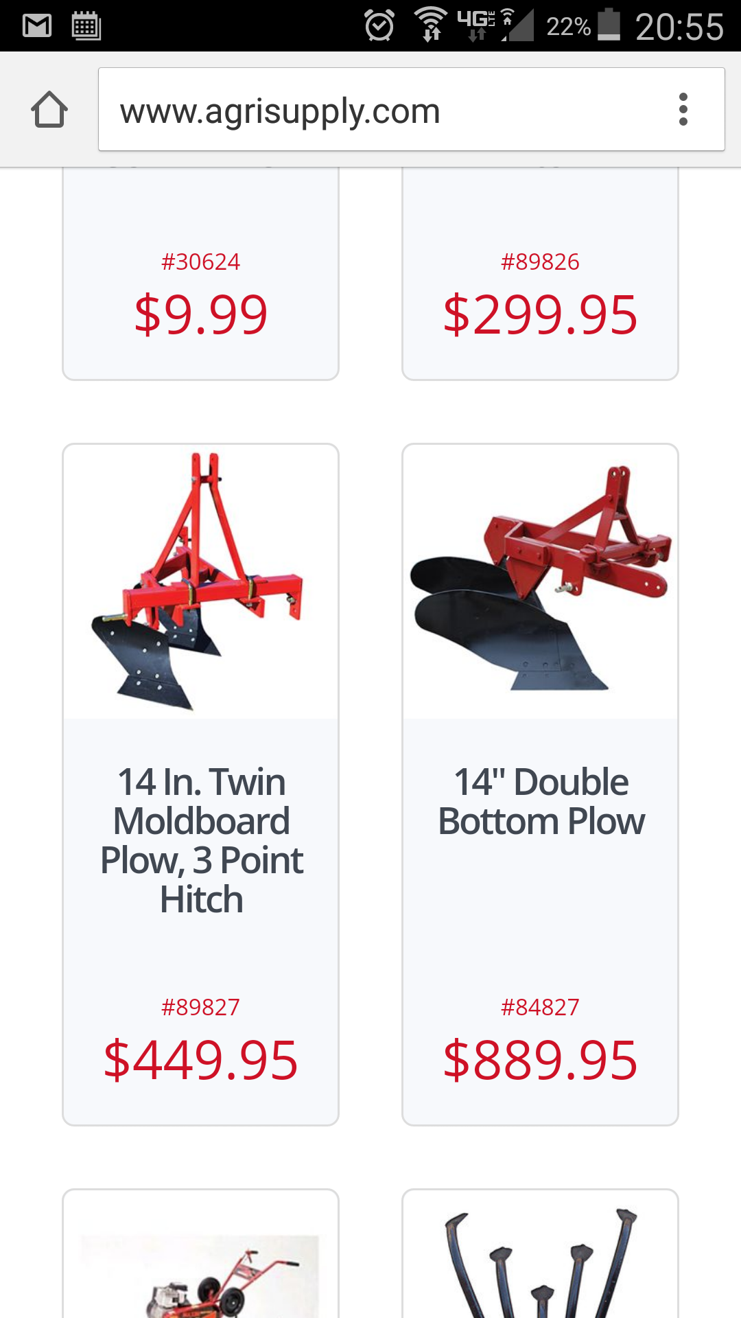

I'm in need of getting a plow for use around the property, and was browsing Agrisupply's website tonight. When looking at their plows, I found 2 similar plows, but they're extremely different in price. I'm new to the tractor world and not familiar with all the ins and outs yet. Could someone explain what the difference in these are to me and what the benefits of both would be? I thought moldboard plow was just a different name for a bottom plow, but maybe I was wrong about that? I've got a ford 2000 3 cyl gasser and plan doing some small amounts of plowing in the 3-4 acre range.

I bet that's a typo I didn't see that a year ago when I was looking as to the difference the 900$ one looks like it's built better but I imagine you would be happy with either with the small amount your talking about working.

I have been looking around some to try to find a decent used one for a fair price, but haven't had any luck yet. All I've seen so far have either been just as much as a brand new one or in very questionable shape.
I don't think it's a typo cause they have the same thing going on with the single plows. They've got one for 289 that has holes in the plows like the cheaper of the doubles that I posted, and then they have another single plow that's for 589. I'm really interested I what the differences are, but the make it hard to tell as only the cheaper of the plows has a product description, while the more expensive of the plows doesn't have a description.
I'm almost thinking if I can get a double plow that's a decent quality one brand new for 489, I'd almost rather do that. But the real question is how well made thsee are.

I am also in the market for a plow. I just have some small areas to plow, maybe 3/4 of an acre. I was also looking at the Agri Supply plows. One model is a 14" single Moldboard plow for about $300. Another model is described as a single bottom plow for about $590. They are obviously built differently but I am wondering why "Moldboard" was used in the description of one and not the other. Does anyone know if there is a difference between a single "Moldboard" plow and a single bottom plow?
/ Plow question #15
rbtjr, The OP asked the same question and I have been waiting for an answer. I have been a member on here for quite a while and always assumed they were one and the same - "bottom" being just a USA expression for a mouldboard.
Note the difference in the share shape of the two ploughs in the OP. There are numerous variations on this shape, and choosing the right one for your purposes and land is not easy. Experienced advice is highly desirable. I have not used a mouldboard plough since 1979 and never really missed them. I do everything with tines now, but used disc ploughs in Australia - 14 and 18 discs. Not enough hp for the bigger ones.
/ Plow question #16
Probably two different manufacturers, and two different descriptions of the same thing. Around our region, a 1 bottom, or how ever many "bottom" plow, is meant as a moldboard plow. Chisel plows are usually described by the number of shanks.
What I'm wondering is, do these manufacturers use a common share, and moldboard that fit other more well known manufacturers such as John Deere, Ford, Case/IH, etc. And will those wear items still be stocked 10-15 years from now..?? More than likely, the average person will never wear out either, but there's always the chance of hooking a rock or root, and breaking one, or the other.
/ Plow question #17
I was thinking the same thing. The less expensive version has less bulk, length, etc., and a little different shape. That might explain the lower cost, but then again--me knowing nothing about plows--I thought that there could be two designs of the turning-plow concept, one being called a Mouldboard.
/ Plow question #18
DJ54, The short answer is the wearing parts are specific to a model of plough from any manufacturer. As I posted at #15 there are numerous different shapes of share, and different widths of the same manufacturer's ploughs have different sizes of points and shares, even if they look alike.
/ Plow question #20
B&D, I agree that for popular ploughs the parts will be available - for the same plough. DJ54 was asking whether parts were interchangeable. The JD 2 x 16" parts will not fit the 2x14". I assume you do have 16" ploughs in N. America. Nor will any other manufacturer's 2 x 14 parts fit the JD unless they are clones of the JD.
