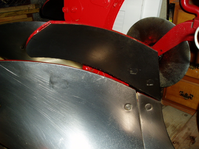

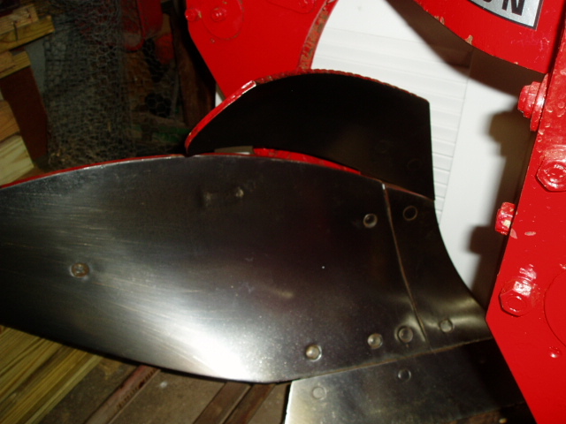

Myself? I prefer the results that can be had with a good coverboard set-up. They bury trash (ie grass, weeds, crop residue) simply by curling it into the open furrow just before the moldboard throws the next furrow slice in on top of that trash. So long as you have a plow with decent throat clearance, tall weeds aren't the end of the world. (But....Many older plows didn't have as much clearance as they often needed...)
