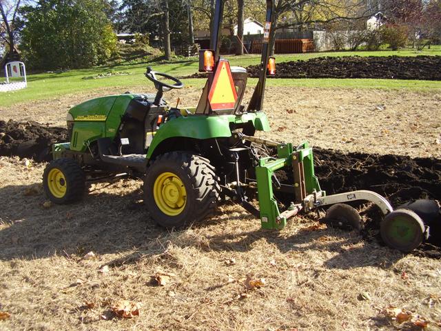

Here are some plowing pics. I bought a used 12 inch Brinly plow but it had a category 0 hitch. JD still has in stock the cat 1 mast to fit this plow but it was way too much money so I made my own to fit the I-match. This makes it easy on and off and just a few seconds to adjust the right lift arm and top link. I was plowing 6 to 8 inches deep in this garden in low gear at 2300 RPM and never had a problem. I never knew plowing was so much fun!

That is A good Looking plowing Job !

Great setup and great pictures. I'm happy to say that your ground looks very similar to mine here in MN. :)

Nice job. I noticed it looked like the grass was dead where you were plowing, and the perimeter is green. Did you use roundup or something before you plowed?

The grass that looks dead is just garden weeds and quack grass that went dormant and was mowed before I plowed.
