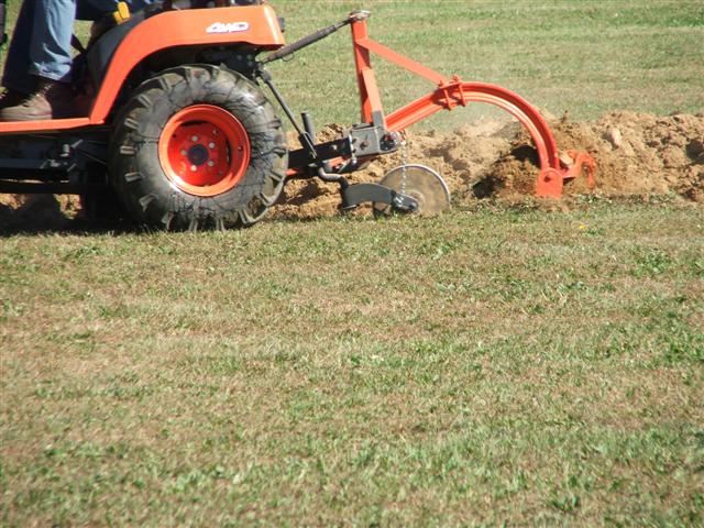

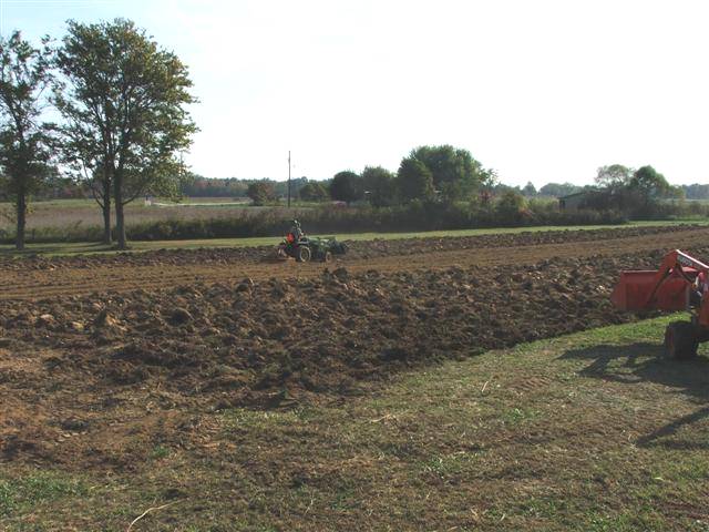

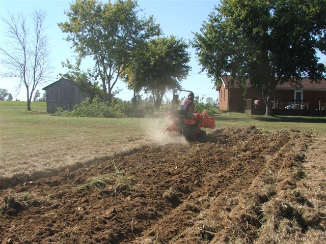

You shouldn't have any problem pulling 2 12's with your 30hp and ag tires, the old myth that you can't plow with a hydro trans sure seems to die hard, and the front axle won't break if you plow with the loader attached. Some pics of 22hp hydro w/14" single bottom.

While I agree that he should be easily able to pull 2 12s, and probably 2 14s with that tractor, I think the "myth" you refer to is that a hydro will not pull as hard as a gear tractor with the same engine, which is something I agree with. I know my hydro DX29 seems far less willing to work hard than my old Kubota B7100 was, despite being a couple of sizes bigger. It's not an apples to apples comparison, but it just seems the engine/hydro bogs down quicker than the engine/foot throttle/gear tranny did.
I know there are power to weight ratio issues here, so that is not a definitive statement by any means. Does anyone happen to have two tractors of the same model, one gear and one hydro, to compare outright pulling ability when hooked to a plow?
   / Plowing with a 30 Hp Compact tractor #20
I used mine with a TC33D with Hydro and it pulled it fine. There were times when it would bog down and comparing it to a gear driven tractor, I would have to say without a doubt, the geared tractor will outperform.
