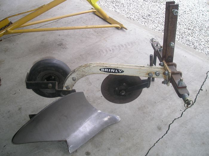

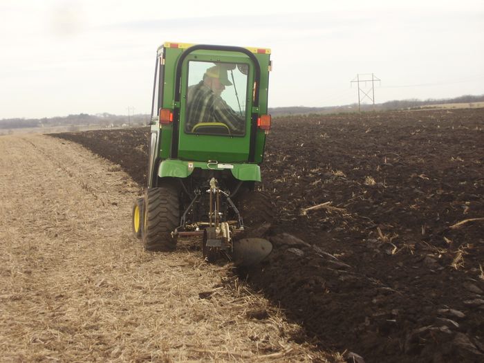

/ Plowing? #7
Your little ford is about the same size as my old JD 2305. They love to pull a 12 inch Brinly plow in the spring when the ground is soft. Later in the summer when the ground is dry and hard, the plow sometimes struggles because it doesn't have enough weight to sink deep into the ground.
