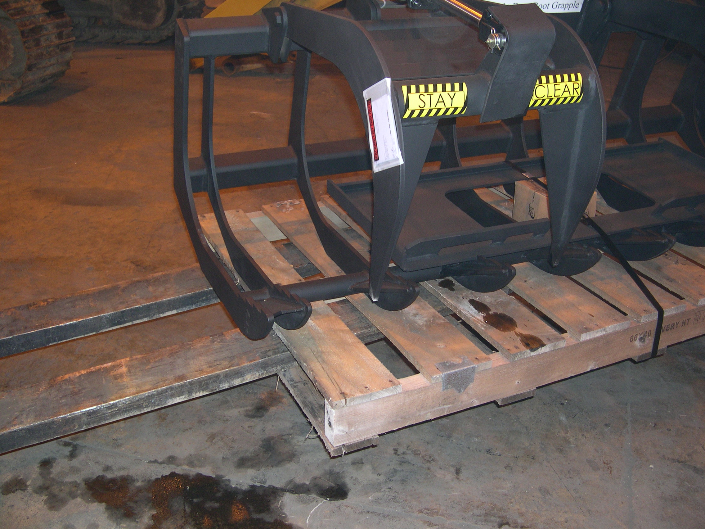

I was quoted $1,041 for the LD48 with JD mount. Shipping to nearest terminal (over an hour away): is an additional $245.

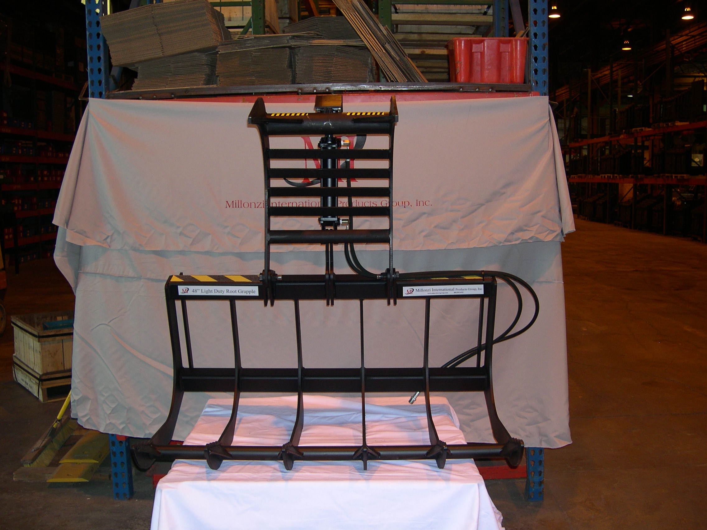

More info and pics from Millonzi on "new" LD48, etc:
On our 48" as well as with all new grapples produced, are now manufactures with several new features
1. Protective louvers to the arms, greater support strength and cylinder protection
2. Front Mount cylinder guard to protect cylinder head
3. The Grapple arm support brace has been lengthened to add rigidity to the arms.
4. The outer tines on our 60.00" and larger sizes are in essence doubled to protect the end tines in prying and carrying long or off balanced loads
5. Outer arms are now 1/2" ASTM GR50 plate for great strength and rigidity on all models.
6. Cylinder pins now have enclosed grease able fittings.
All other frame material except the louver (3/16") are 3/8"
Pics are of the new LD48, new LD60, and Millonzi's JD Mount -- nice green color :)

Island, I just got off the phone with Jim at Millonzi. He recommended the LD60 for my 53HP tractor... he thought I might be able to lift something too heavy for the LD48. He did not strongly recommend the LD60 over the LD48 -- he said the 48 would be fine if I am careful not to over do it. I had already mentioned tractorbynet to get a discount... he asked if "Island Tractor" was advising me (they should pay you a commission :) ). He has seen your uploaded pictures.
Given that the current LD48 is even beefier that your older version (it now weighs about 325 lbs.... LD60 weighs 425 lbs with two arms) I am still inclined to go with it over the LD60 which costs about $600 more. Both are made with same material and metal thickness, etc. Any final thoughts?

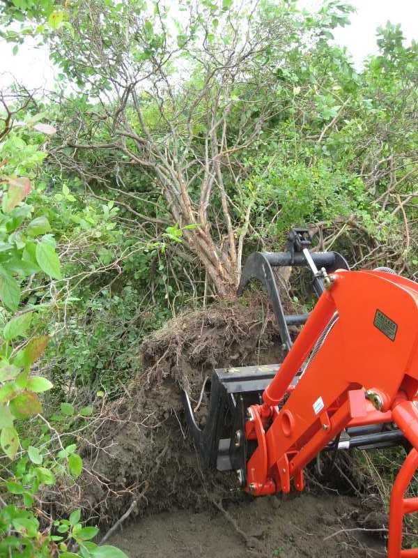

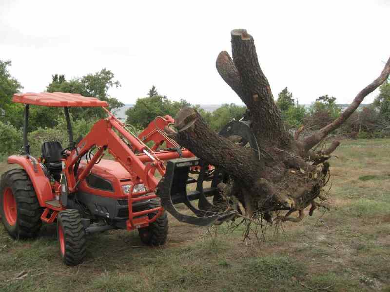

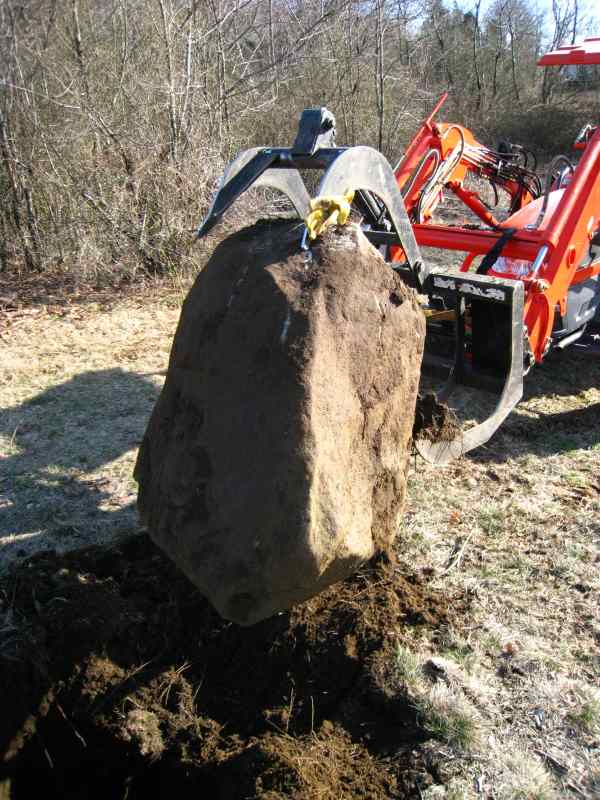

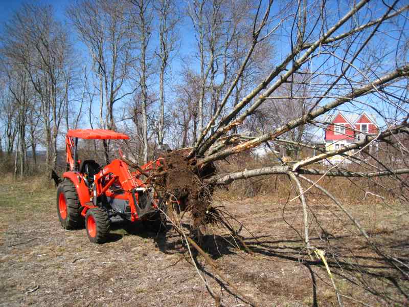

What is your loader lift capacity? That is more the issue than tractor horsepower. Again, my loader is rated at 2700lbs lift at pivot pins. I have used the LD48 pretty aggressively and except for some "cosmetic" damage from scratches etc, one busted hose (snagged it) and a snaggle toothed top jaw (from lifting a boulder with one tooth only and using it as an anchor around a stump while using the backhoe...neither likely to happen now that they have increased the support for the tooth tip), there has been no issue at all. I personally don't like the double jaw set up on the larger ones as it adds too much weight and more hoses and also because I like having the single jaw centerline so I can just center the grapple on my target and clamp. I'm sure the 60" is a fine grapple though. However, I believe most grapple size recommendations are made either by incorrectly assuming that the standard bucket width for a tractor si the same as the appropriate grapple, or that grapples for tractors are sized the same way as for skid steers. Both of those (false) standards tend to lead people to buy bigger and heavier grapples than make sense for a tractor. We (tractor guys) don't tend to use our grapples the way a construction crew would use one on a skid steer. Our loaders are also not as strong as skid steer loaders (by and large). Width of a grapple should be determined by what you are going to do with it, not by the horsepower of your tractor. Two upper jaws may make sense for picking up construction debris. It doesn't have any advantage I can find when grappling brush or roots or trees however. Bottom line for me is that I just don't see the advantage of a wider, heavier, more expensive grapple than what I have. If someone stole my LD48 today, I'd order another LD48 tomorrow.

That makes the two loaders pretty much equal if the published specs are to be believed. The JD 4520 has significantly more horsepower (53?) than the DK40se (41) but the two tractors weigh roughly the same and as the loaders are pretty well matched I think the "impact" on a grapple would be about the same. In that case, if it were me, I'd order the LD48 because I just like the size and style of that grapple.
I'm sure the guys at Millonzi get a bit itchy being concerned about proper sizing but again it is the loader strength, not the tractor horsepower that matters and it is also the intended use on a tractor vs commercial skid steer that needs to be taken into consideration (skid steer loaders are underrated for safety purposes...don't think that is true of CUT loaders). I may be a lone voice on this point but a 48inch grapple with a single arm is simply a very versatile tool. Bigger isn't always better.:)

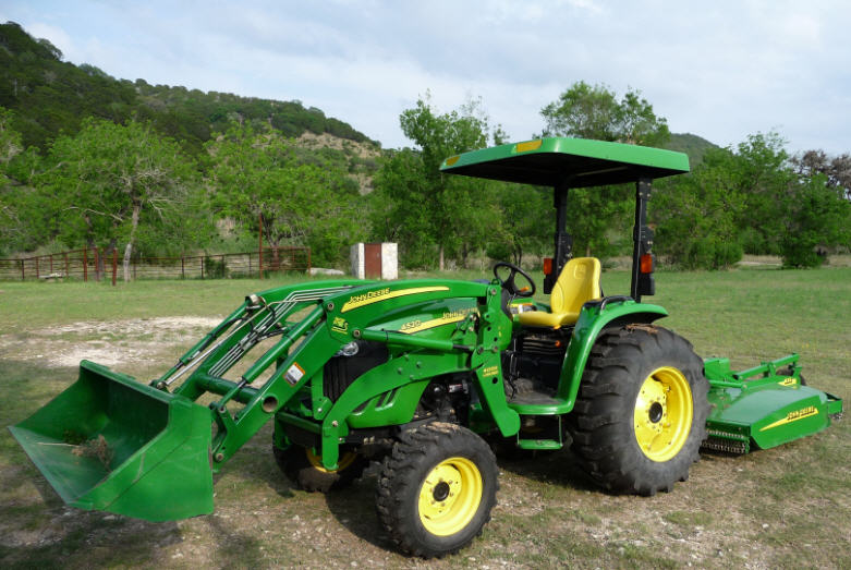

Well I got the tractor, MX6 cutter, and boxblade delivered today (see pic below)!!! Sure is a nice rig. The cutter and the boxblade both hook-up so easily with the I-match. I have a friend who will sell me a barely used posthole digger, which apparently will require that I remove the I-match before hooking it up.
Next month (after I save a few pennies) I will order the Millonzi LD48 and hook it up to the 3rd function rear valves. They'll paint it green for $75, but I think I'll save the money and get black -- I kinda like the black anyway.
Thanks to all who have advised me -- much appreciated!! I'm sure I'll need more some help down the road.
