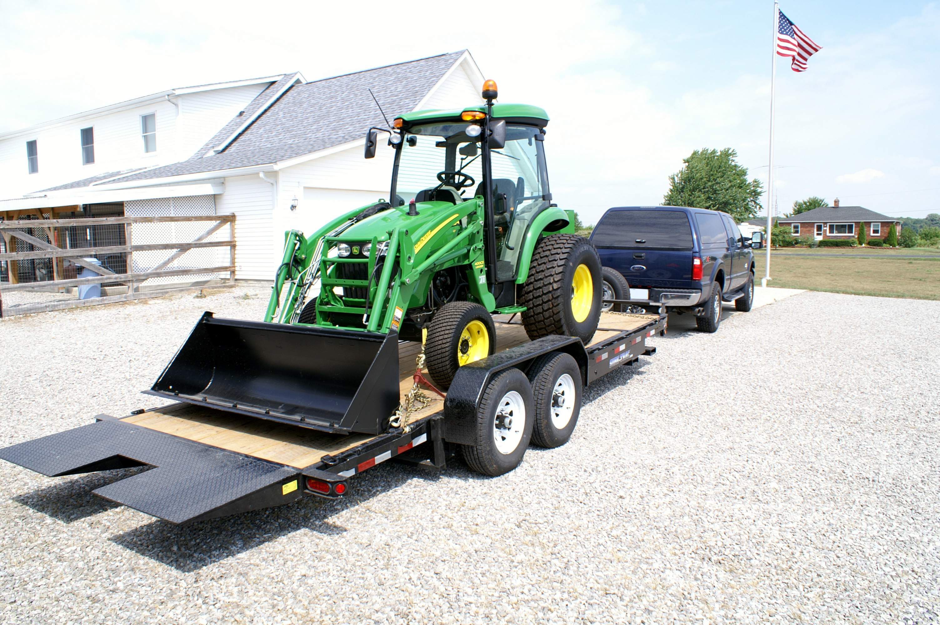

The manual indicates I should plug the exhaust on my 3720 while trailering to prevent spinning the turbine in the turbocharger when there's no oil supply. I suppose it's possible the engine could shut down with some overlap. Whatever.
So, is anyone actually following this guidance and if so what are you using to plug the exhaust?

The 3720 manual is unclear, leading the owner to think that practice should apply regardless of configuration. I don't see where it applies to vertical exhaust at all. For tractors that exhaust under the left front, it should not apply if you're towing it facing rearward. For loader-equipped tractors, the bucket blocks the wind. So it shouldn't matter which direction it's being towed. Apparently the manual addresses the worst case issue of a non-loader equipped tractor with bottom exhaust facing forward on the trailer.
