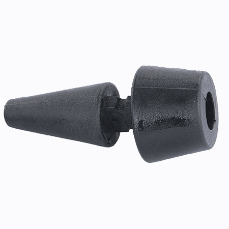

One of these on order. Helix Racing My exhaust ID is 1.65" and the plug accommodates up to 1.95". I was surprised how close the exhaust comes to the plastic hood.
Amazon.com: Helix Racing Products Muffler Plug 350-2770: Automotive
