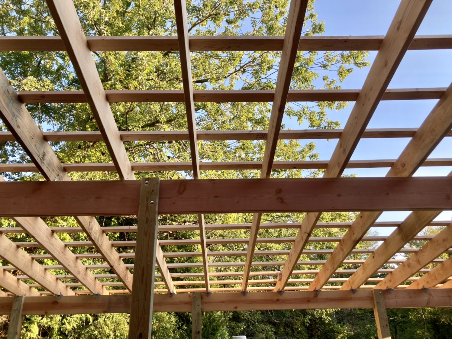

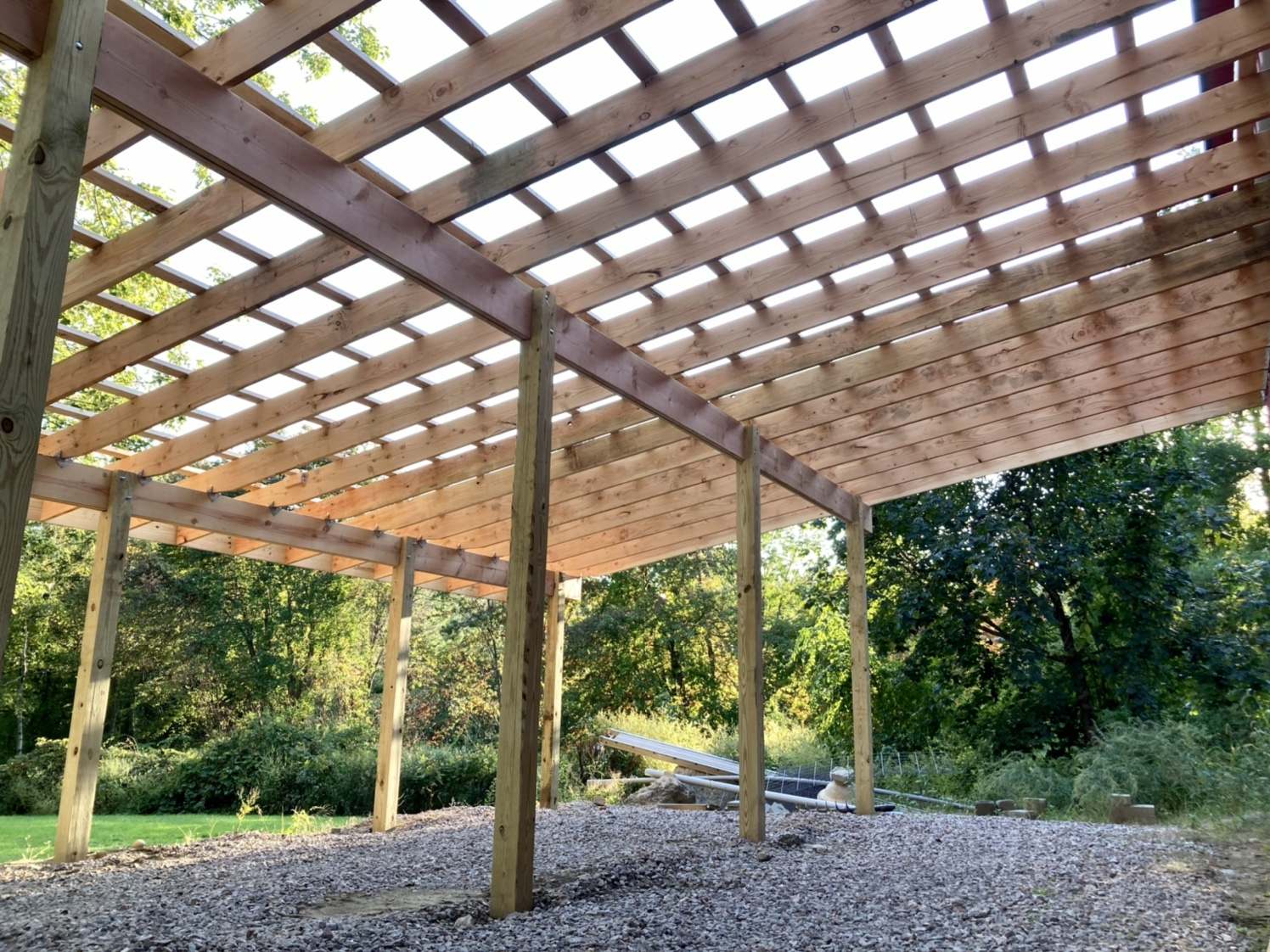

The exposed rafter on each side will be covered by 2 pieces of trim. A 7"x1.5" L shaped black metal trim will cover the bottom 2/3 of the exposed rafter and a 5x5 corner length of black trim will cover the top 1/3 and attach on the surface of the roof. That is how the pole barn kit did the gable ends, so we are doing the same so everything looks the same. I am using metal trim instead of paint as the metal has a 40 year paint warranty. I don't want to have to paint the barn in my lifetime! Trim gets expensive very quickly. I paid $1000 for the 900 sq feet of metal roof and $500 for the trim needed for the 2 sides and end.

Next is the wooden guard rails protecting the posts and bringing in some fill to raise and flatten the ground under the overhang so the firewood cages have a level place to sit. Then a few more yards of gravel. I have this week off of work so hope to finish everything this week.
