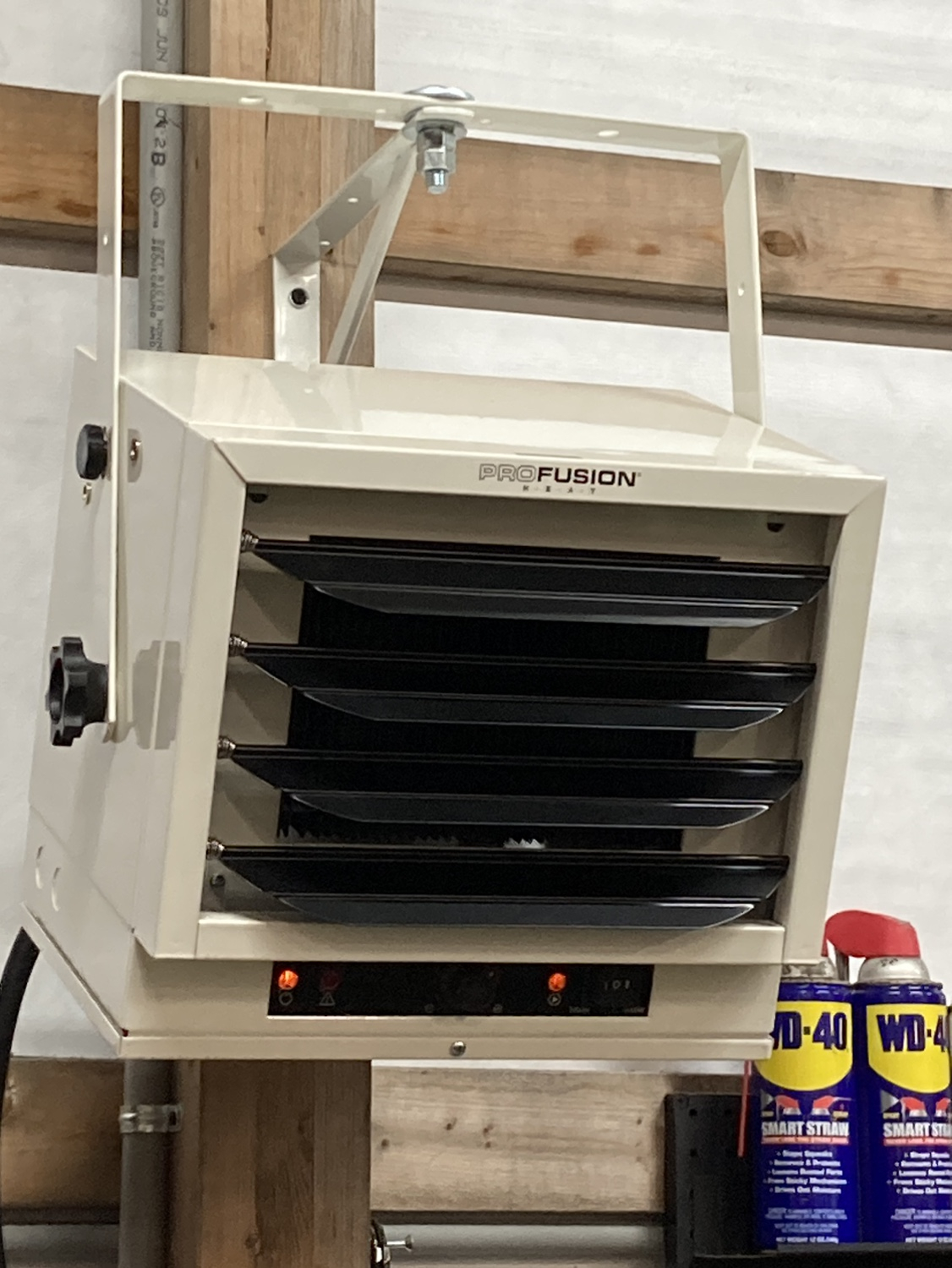

Today I hooked up a 220 volt 5000 watt heater in the shop. It’s set over the workbench about 7’ high on the wall. There is no chance it will heat up the building but it makes a great warming station when you are out there working. I decided not to hardwire the heater and instead used a 4 prong dryer plug so I have a second 220 volt plug in the shop area that can be used for other things besides the heater. View attachment 777605
Nice and a second 220 as a bonus!👍🏻✌🏻

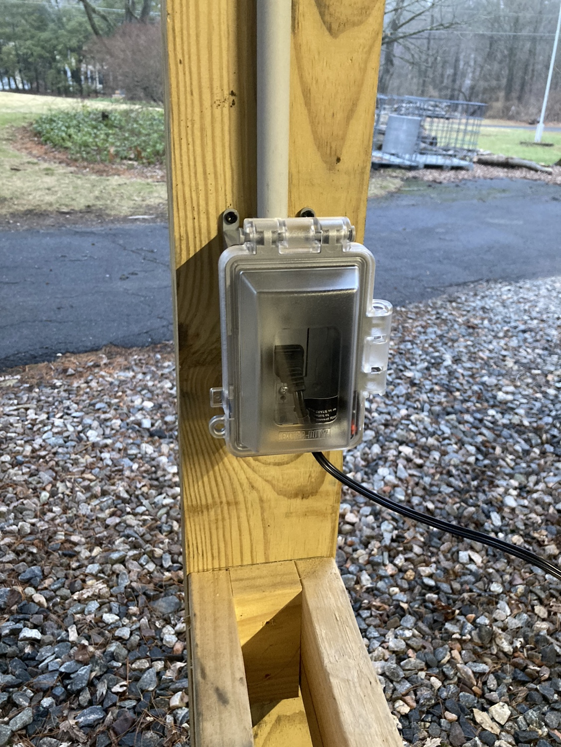

Added 2 outlets at the front and back of the shed on the center posts.Main use is for charging the battery for the winch on the equipment trailer and the battery on the dump trailer. The outlet in the back is for charging a battery on a pontoon boat which is on our someday wish list. Figured I’d be prepared! I run all my wire in PVC conduit. Looks nicer and avoid critter and other issues.

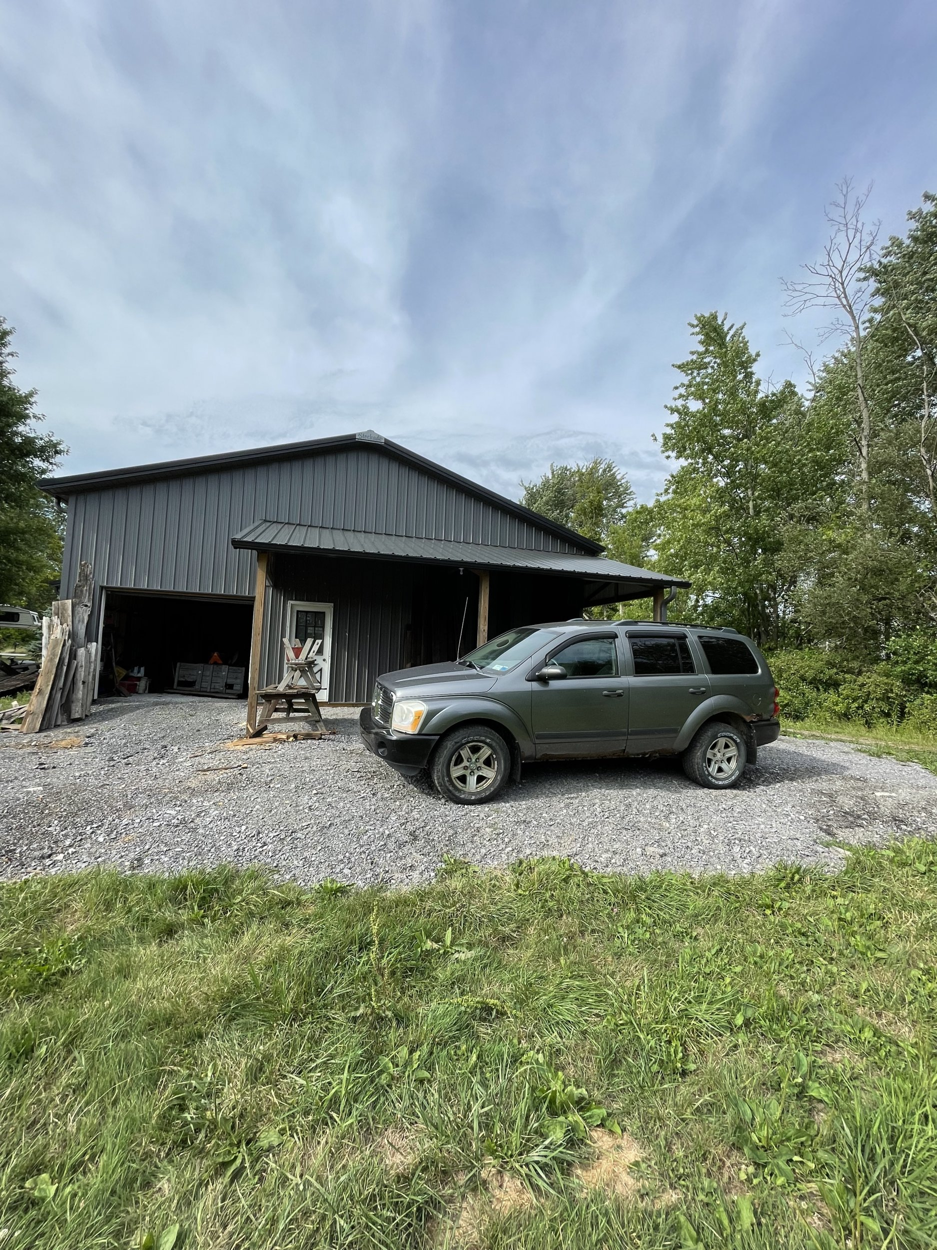

You can never have too much covered storage area, that’s for sure. I recently replaced (2) old post and beam barns that my great great grandfather built in the late 1800’s with a pole barn. I’d have liked to have saved those old barns, but the roofs and foundations were failing and it would have cost way more than the new build.

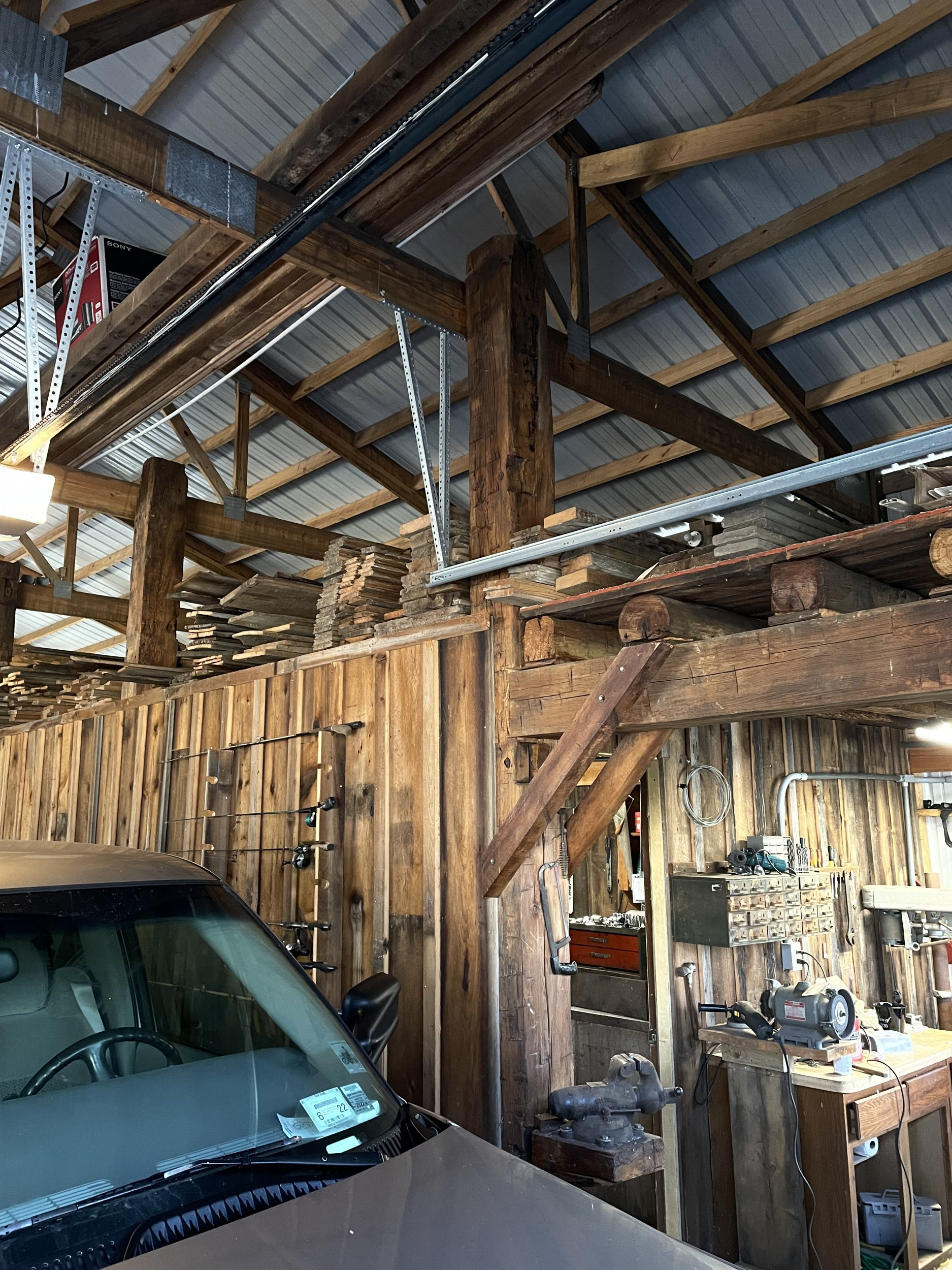

I dismantled the old barns as carefully as I could, using much of the hand hewn posts and beams and lumber (mostly American Chestnut), for interior work (shops, loft, etc) in the shell of the new metal (Stockade) building.
The old barns were each 36’ wide x 46’ long with 16’ high wall. With them, I had plenty of inside storage for all of my tractors, equipment, recreational toys, and firewood.
The new build is 36’ wide x 50’ long, with (2) 10’ x 25’ porches. I consolidated equipment and sold a few tractors and it seemed like that would be plenty of space. My original intent was to use the back 10 x 25 porch for firewood storage. I find myself now needing more space, so I am enclosing that porch, and adding a new, 7 ft wide lean to, to the back of that, for firewood storage.
My firewood shed will be built with rafters, posts, and beams, recovered from the old barns, and roofed with leftover tin panels from the pole barn build (each bundle of gray tin was protected with a green sheet of the same gauge metal and those are what I am using the cover the lean to).
It sure is nice to have your firewood under a roof compared to tarps like I have been struggling with the last 5 years during this barn replacement project.

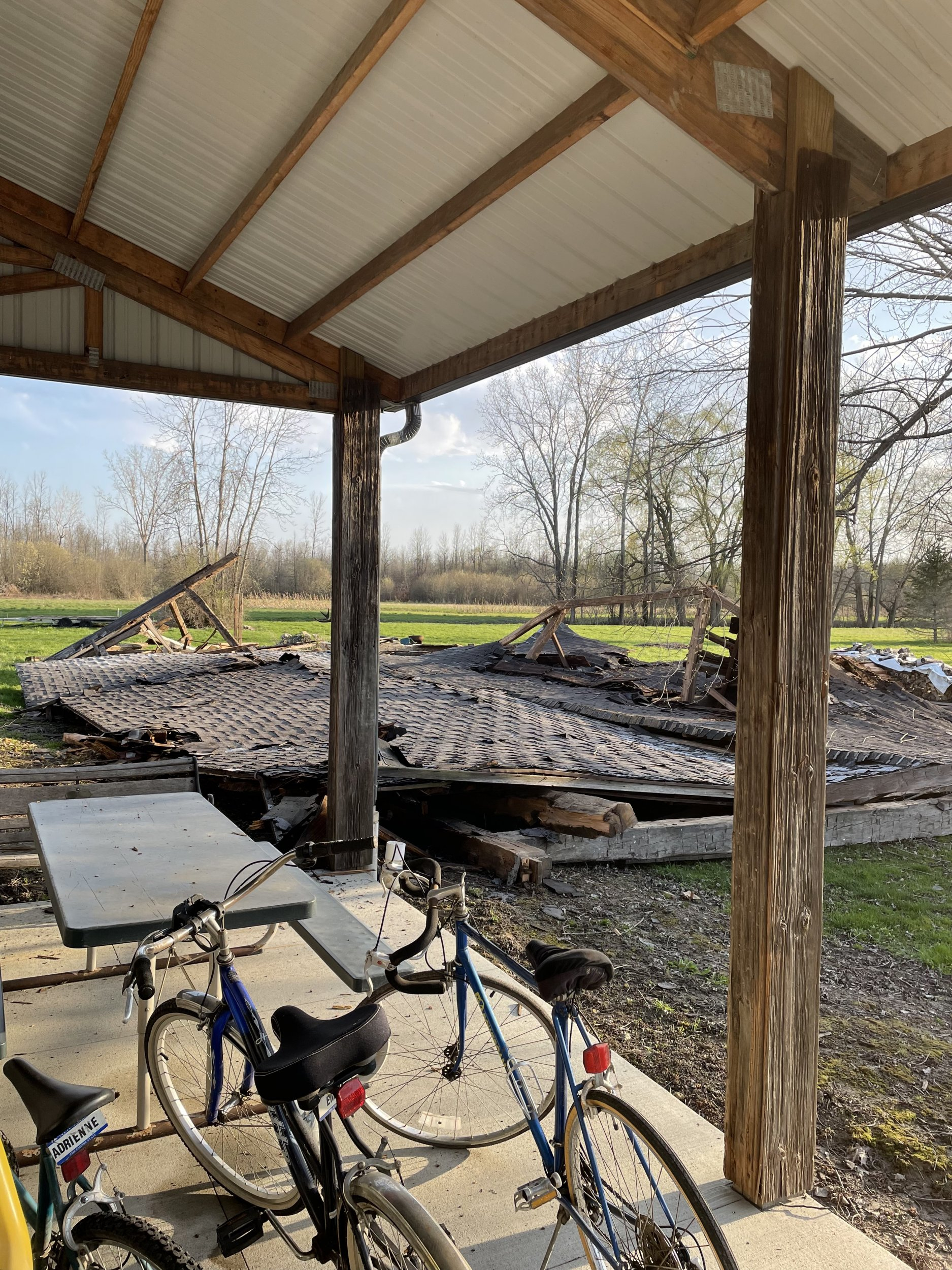

I’ve always heard, that it is is best to build bigger than you think you need from the start, rather than add on later. I would have loved to have ran the side porch of my new pole barn, the full 50 ft length. That would have given me plenty of covered storage space for firewood, and wouldnt have cost that much at the time.
I couldn’t do that, because one of great grandad’s old 1800’s post and beam barns was still standing next to it when I put it up. It was leaning towards the new pole barn, and I left what I hoped was enough space for it to fall down that way.
My measurements were very close , and it came within 1/4” of striking the 25 ft long side porch when it fell. I tried pulling the old barn down the opposite way with my largest tractor. The main end crossbeam, to which I cabled the tractor, snapped during the pull
and the old barn crashed down towards the new one in the direction it had been leaning. No harm was done to the new barn’s 25 ft long side porch. A 50 footer would have been mostly demolished.

The beams were challenging to work with compared to today’s dimensional lumber. I shimmed many of them to make my loft floor level. That loft floor is made from the old barn’s chestnut 1” thick, rough -sawed roofing boards, topped with 4x8 sheets of 5/8” OSB.

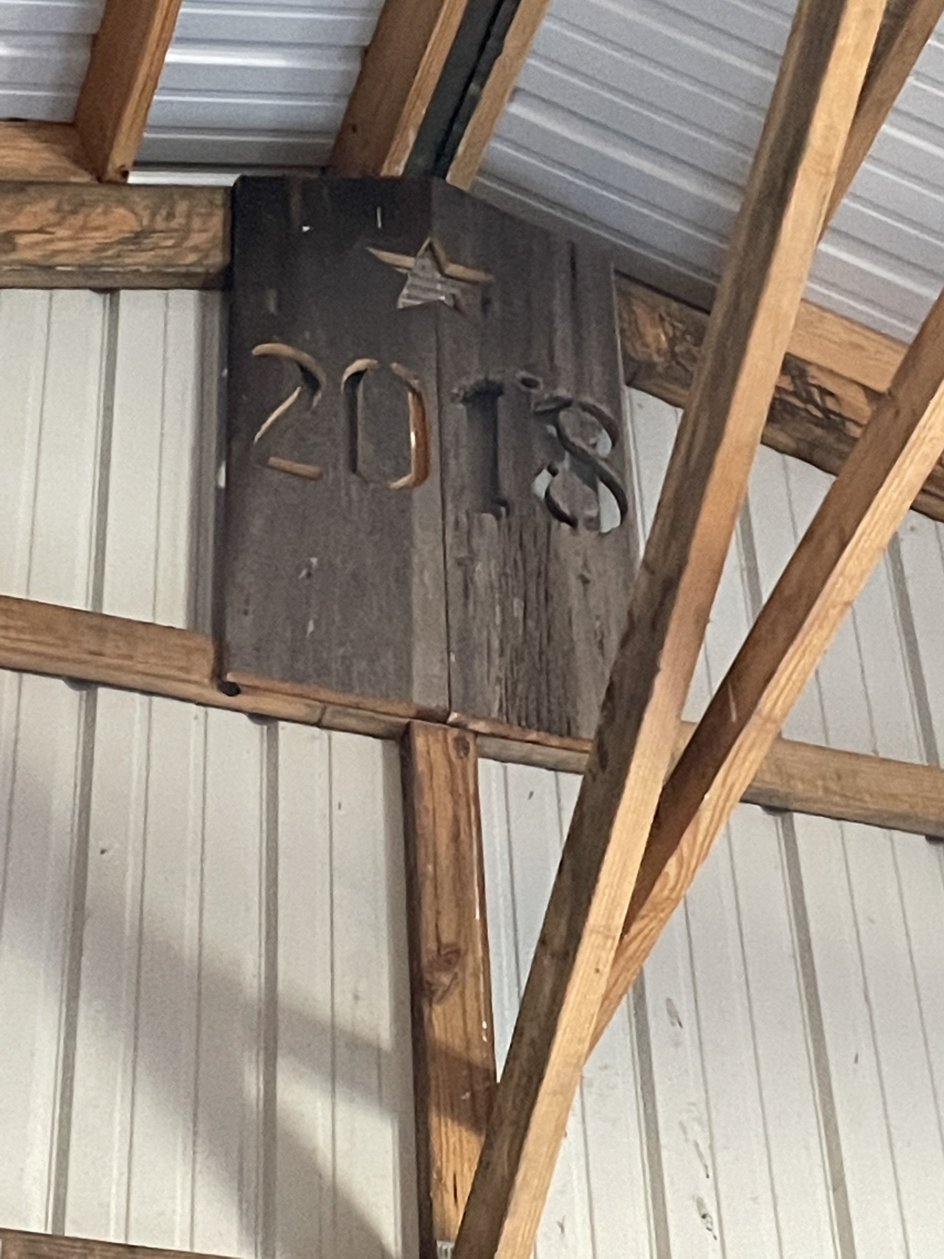

The last old barn was built in 1883 and had the year cut into the siding under the front peak. I pulled the “18” board down intact and used that inside the new shell, which went up in 2018. I tried to match the text on another for the “20” with a jigsaw.
