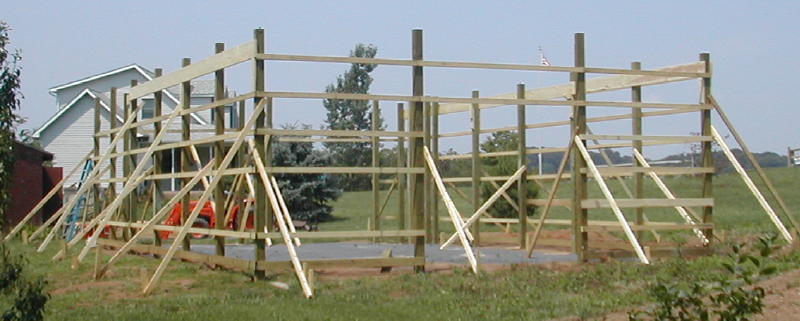

I decided to build myself, and am building a 30x48x12, so far am around $10,000 in material.
