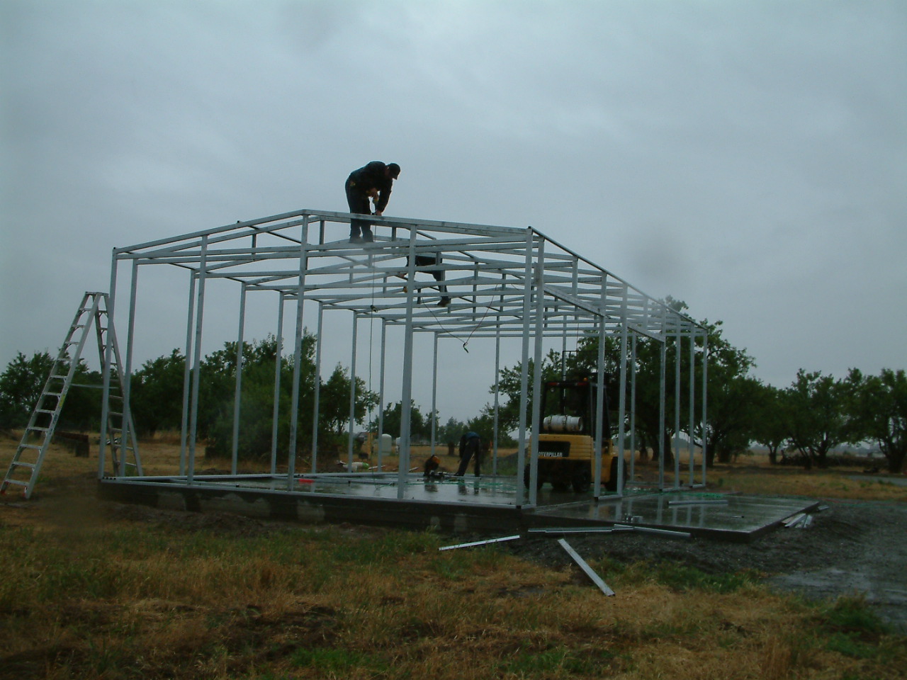

In June 05 I had a metal pole frame garage/shop built.
24'x48', 12' wall height, 1.5:1 roof pitch, two 10'x10' rollup doors, one 36" man door, one 24"x48" window.
Concrete floor: 6" thick, #4 rebar on 24" criss cross.
Building cost $16,000. Concrete work: $7500
Prices in this thread pretty much what I would have expected.
