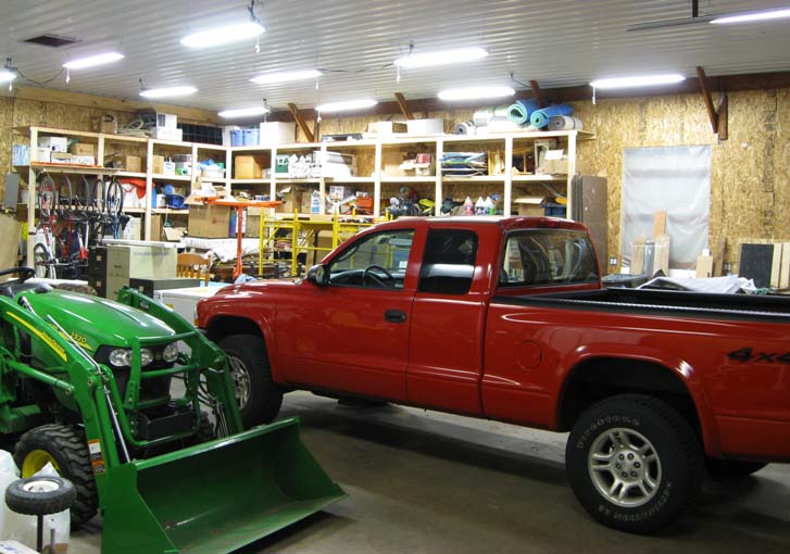

If my son would have not taken my camera plug I would post some pics of my shop with osb painted and metal on the ceiling. BTW I have Never heard of OSB coming apart without water involved.
/ Pole Barn Interior #17
thanks for the pictures KennyG. Looks really good. How long have you had the OSB up? Have you had any issues with the sheets delaminating?
That OSB has only been up about 6 months. I decided to leave it unfinished because I have a small storage shed sheathed with OSB (shingles and vinyl siding) that is 13 years old and the interior of the OSB (smooth side) looks brand new.

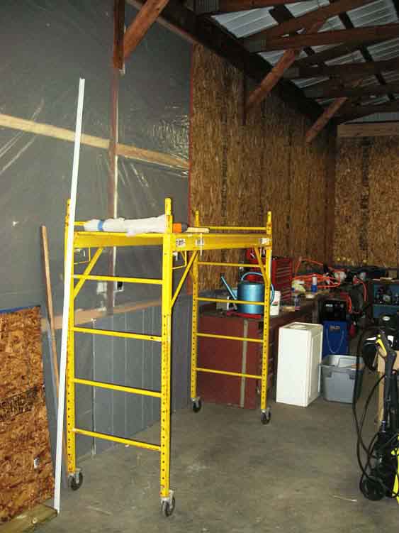

I am at the same place in my building project. I have a 40x56x12 foot with it split into a 40x28 shop side and a 40x28 unfinished storage side. Think i'm going with the OSB painted white with a steel liner ceiling. I visited several friends shops and majority love the OSB sidewalls. Think I'm going with electrical run in conduit on the surface of the OSB so I can easily add outlets and lighting as I finish it out. How are you running your electrical and are you heating your barn?
/ Pole Barn Interior #20
img18.jpgimg33.jpg Thought I would post a couple pics of my build. Would like to see others, getting power trenched to the barn by the end of the month!
