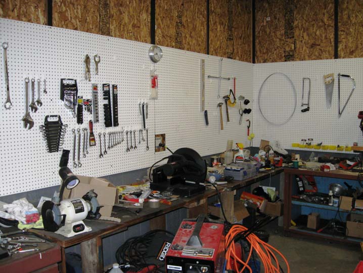

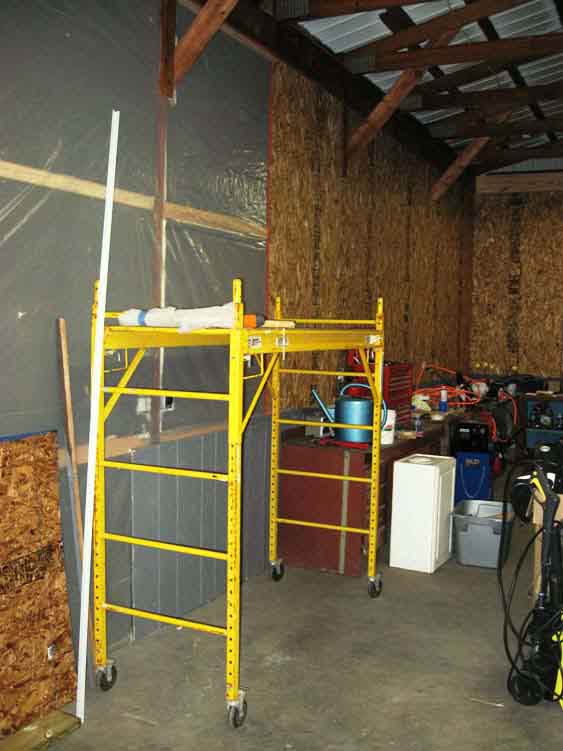

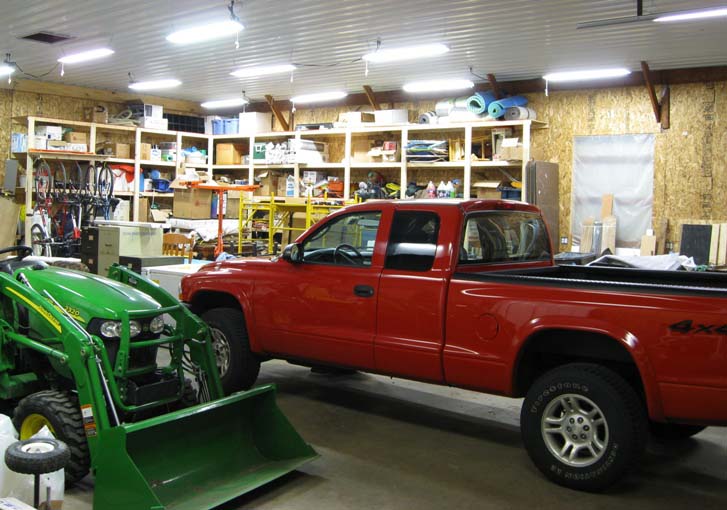

If my son would have not taken my camera plug I would post some pics of my shop with osb painted and metal on the ceiling. BTW I have Never heard of OSB coming apart without water involved.
/ Pole Barn Interior #17
thanks for the pictures KennyG. Looks really good. How long have you had the OSB up? Have you had any issues with the sheets delaminating?
That OSB has only been up about 6 months. I decided to leave it unfinished because I have a small storage shed sheathed with OSB (shingles and vinyl siding) that is 13 years old and the interior of the OSB (smooth side) looks brand new.

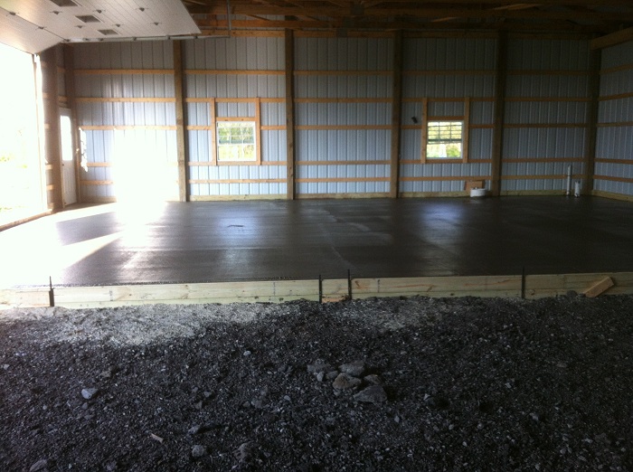

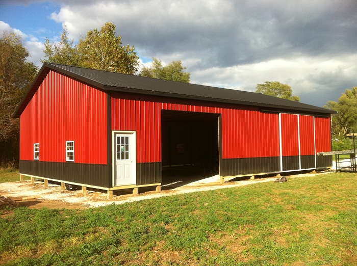

img18.jpgimg33.jpg Thought I would post a couple pics of my build. Would like to see others, getting power trenched to the barn by the end of the month!
