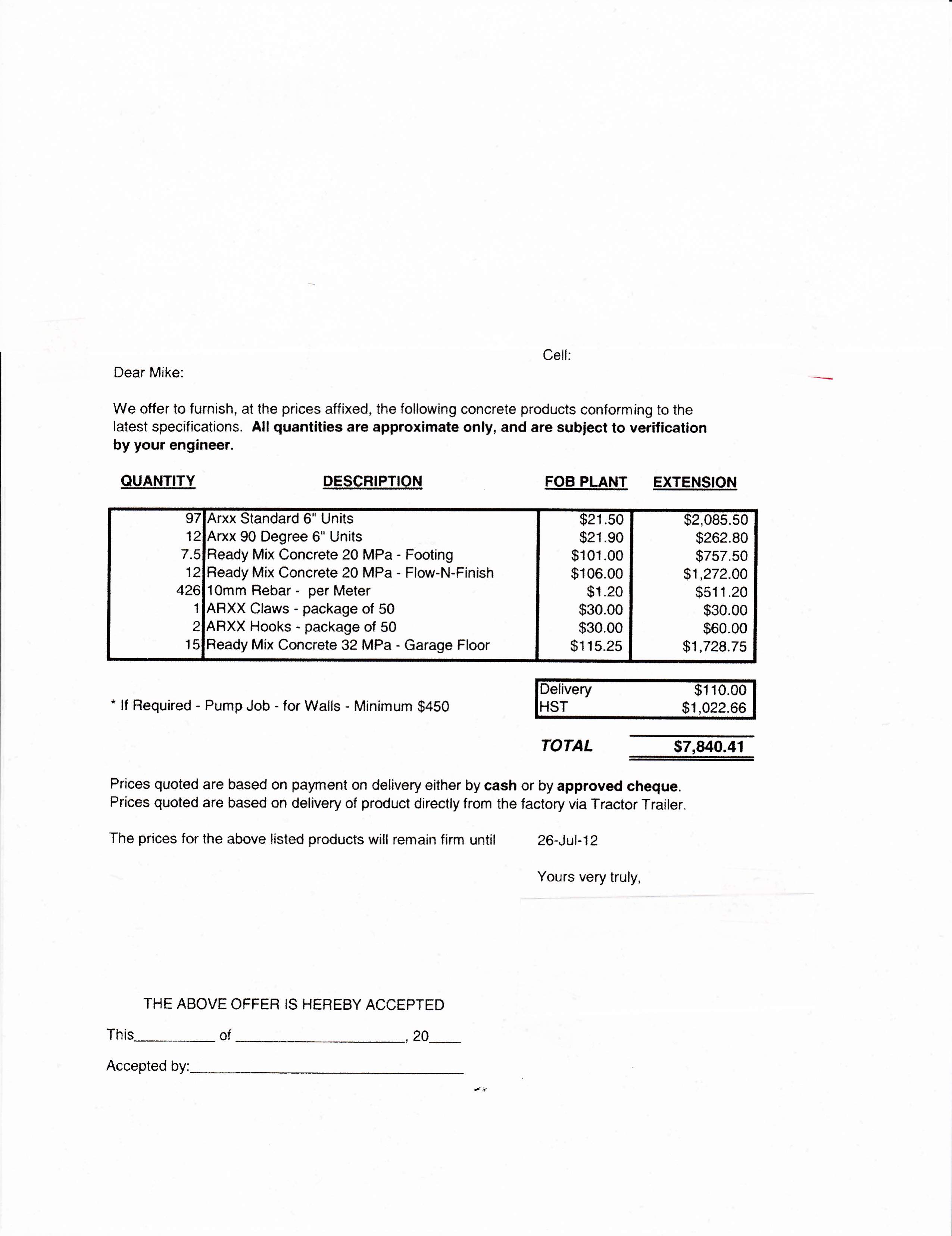

Like you I spent a lot of time talking to everyone I could, from farmers to builders to try to come up with a plan that was in budget, would be stronger than anything I planned to use it for and would endure well past our intended use for it. My wife and I had milled most of the framing lumber so that wasn't a cost we had to worry about.
I started off thinking I wanted to build it the way I believe to be the right way, get the footings 4 foot in the ground to get below frost lines and then a 4 foot frost wall. Attached is the quote I received last year for that and a slab.
With our planning to purchase a couple of colts this past spring and a new tractor this summer that simply wasn't in the cards, wasn't looking to borrow money for the build.
As far as placing poles in the ground, I too am one of those people who has difficulty placing poles in dirt. I replace pressure treated posts each year around our paddocks, and I've checked to make sure the poles are treated for "below ground" and not "above ground" use (was also surprised at the number and types of pressure treatments that exist, and how many lumber yards you will surprise when you ask them that question).
If pole construction is what you have your mind set on then Dave's recommendations seem to make the most sense to me, from the perspective that it keeps your poles above grade and affords you the more economical construction costs.
Whatever you decide, good luck! :thumbsup:

Mike, What size of building was that for? That price seems almost free compared to what things cost here. Ready mix alone is in the $175 and up range, nevermind the crew to place it
