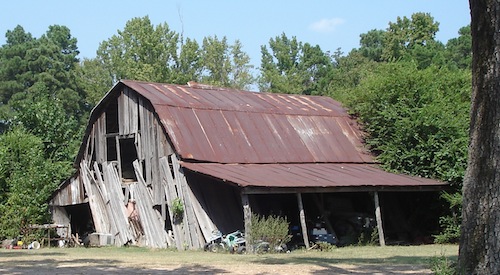

   / Pole barn on plate? #50
Then you would have something like this in 150 years maybe,, leaning-barn-2.jpg
