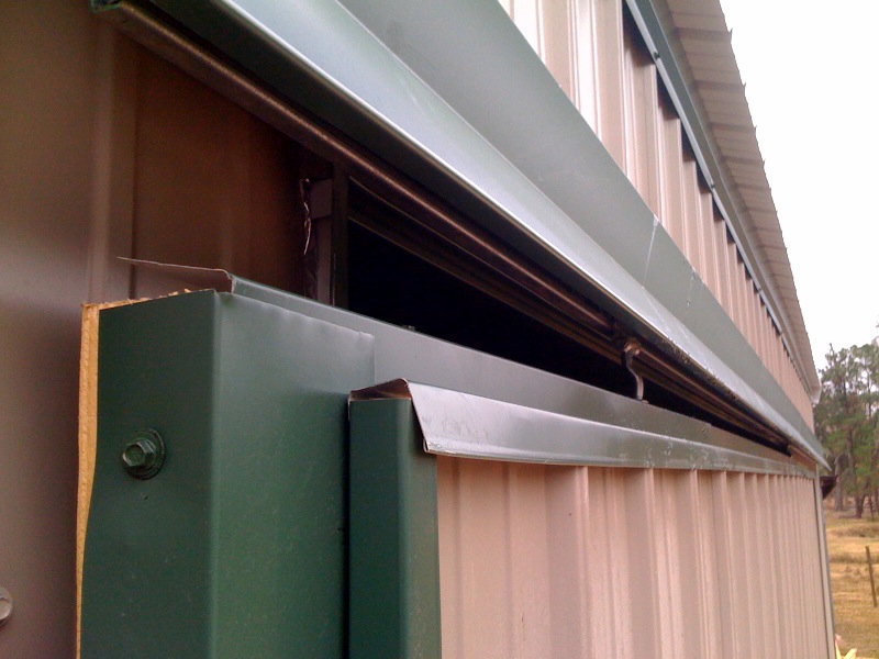

The builders for my pole barn made some mistakes installing the sliding door and I have a few questions for the members here.
Should the top track trim / cover be installed behind the siding. I thinks so, since this should act as flashing to keep rain off the track and the top of the door.
Should the top track itself be bolted to a board and siding fitted around it? Right now they put the track up against the metal siding and ran screws through it. I really don't think this is right as it is sitting on the ribs in the metal.
Should the top of the sliding door be covered by the track trim / cover? It seems like it should otherwise rain would blow in over the top of the door.
I requested a bottom track for the door and what they put in is a metal channel screwed in at the bottom of the outside of the wall. There are no guides, post or wheels in the door that run in this track. Kind of defeats the purpose of having a bottom track.
I have spoken to the builders and I am waiting to hear how they propose to resolve the problems with the door. If anyone has detailed pictures of their sliding door installations, track, flashing, bottom tract, trim etc. I would really appreciate if you could post a few.
I know what they have done so far isn't correct and I believe they will take care of it, but I want to make sure it is done right. I haven't installed any sliders myself and have only seen a few in person, but I never really paid attention to it. Any advice or pictures are greatly appreicated!

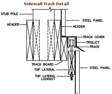

/ Pole Barn Sliding Door Problems #3
I used an aluminum canopy section made to cover the track. It slips under the siding. This keeps out the weather. I suppose you could use a piece of rubber roofing to do the same job. The bottom of the door is held in place by a pulley/roller thing that slips behind the door and runs underneath it. For a weather seal, I used the rubber roofing strip tacked to the door. This slides around the lower roller deal.

Well, the door actually fell off this afternoon. The track and top board in the door stayed behind and the rest of the door fell off. To say I am upset would be an understatement. I am waiting to hear from the builder as to how they propose to correct the issues. I sent them pictures this morning, but didn't hear from them the rest of the day. It's not looking too good right now.

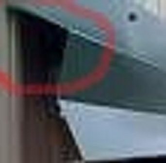

Here are the pics I took before the door fell off.

Wow. That is not a very good install. His metal work on the door is bad. Very poor detail work on the corners and edges. Door looks to short as well.
Try to get him back to repair it. Give him some pictures of what it should look like. Is he experienced with building barns? Maybe its just the door he has no idea about.
I had another look at the pics and I think the metal above the door will have to be pulled off and cut shorter
so he can get the flashing in behind. It looks like the door should be raised up a few inches which will make it even shorter at the bottom.

Compare the hardware profiles to your end view here.

It may be the camera angle, but the door doesn't look square to me. Looks like a very poor job. I wouldn't accept it.

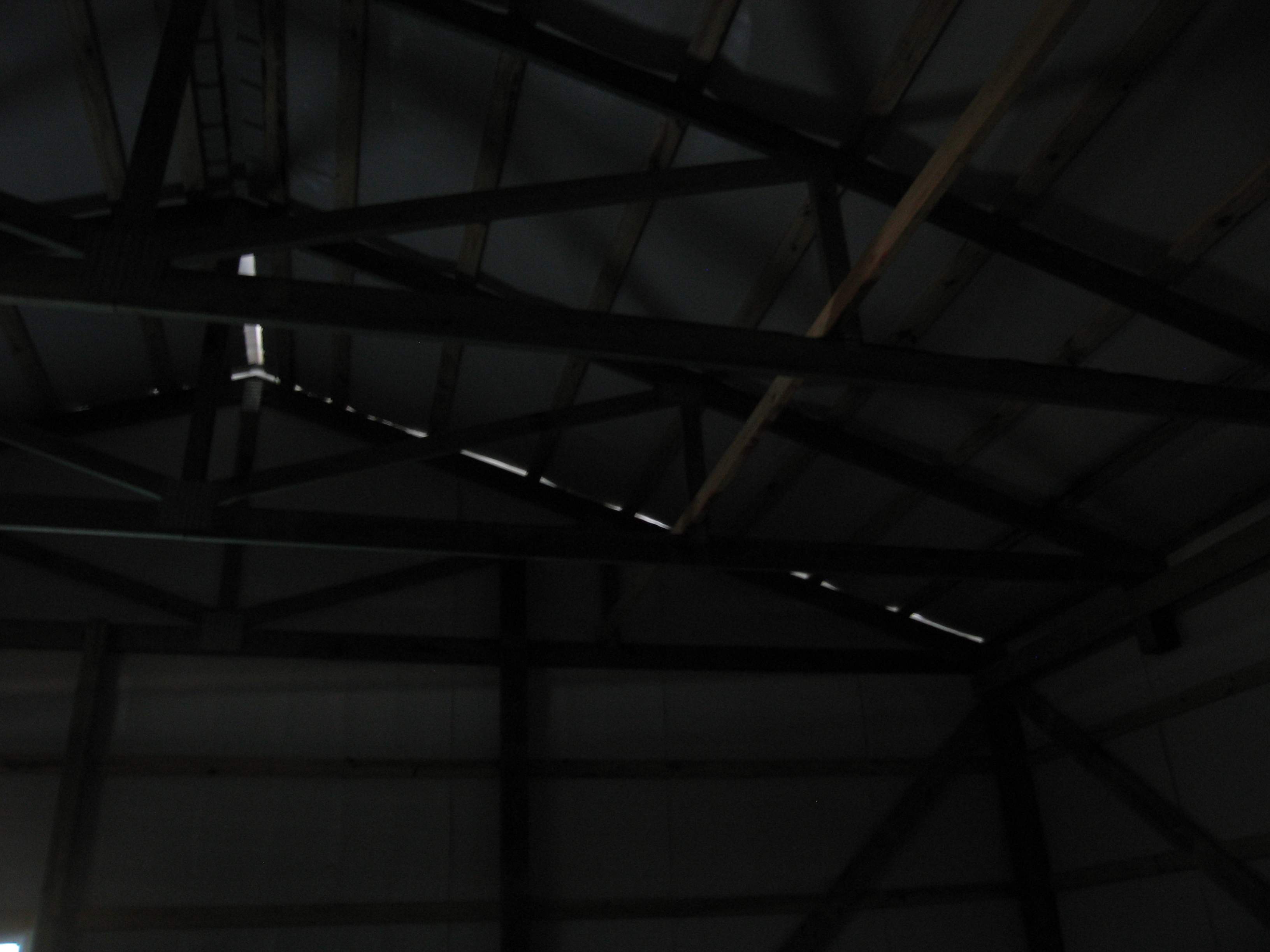

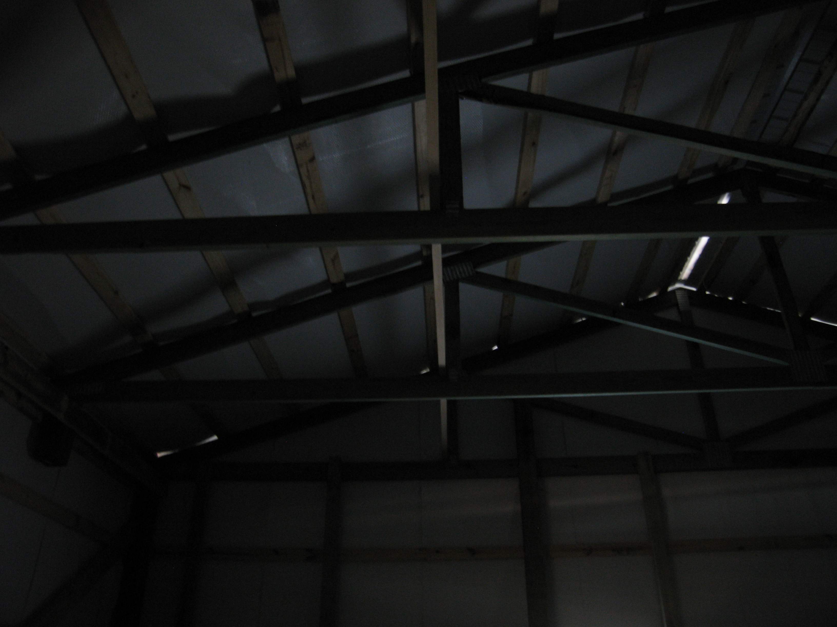

mojoinco, craptastic is exactly right! The more I snoop the more I find. I haven't had much time to inspect between work and the holiday preps, but this morning I decided to go look around for a few minutes. I noticed some water on the floor, looked up and saw daylight........ lots of daylight. The roof was sweating so badly it was raining in the building. I don't have a ladder tall enough to get to it, but judging by the amount of daylight, they didn't run the vented closures all the way down the ridge. They also didn't use closures anywhere else in the building. They didn't use any tape on the rake trim or any other joints so this thing is pretty much open to the elements. I'm wondering why they even offer insulation, which I paid extra for. Next week I am going to find an independent building inspector and pay for a professional inspection and report. At this pint I doubt it will do any good, but it's worth a shot. When I told the salesman I wanted an inspection, he got snippy and told me there was nobody in the state more qualified than his boss and rattled off his credentials. Needless to say, I wasn't impressed. At this point I am wondering if I will just need to hire someone else to take the thing back to the frame and do it all over again. Or try to do it myself. Anyway, sorry for the rant, but I am not at all happy right now!

Bummer pics! You can't see all the issues, I'd bet, due to the insulation. If you take of the siding, something to consider are the see through siding panels. My shop has them in a 2~3 ft strip around the top (older versions look like opaque fiberglass; newer looks like clear plastic). Adds a lot of indirect light around the top of the building.
