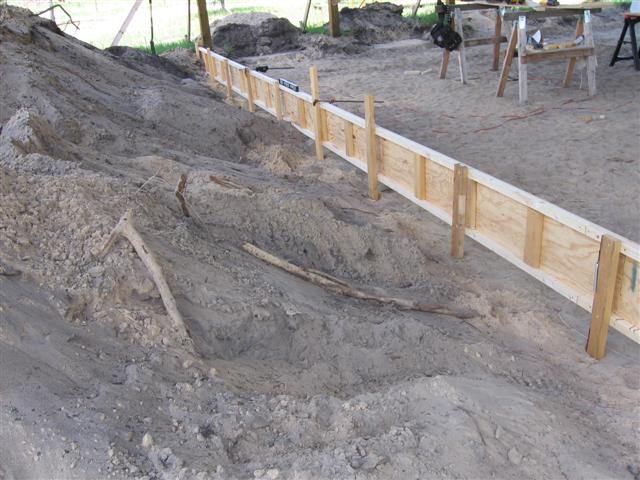

#62
Here is the form after backfilling and bracing. You can see the massive pile of topsoil in the back ground.

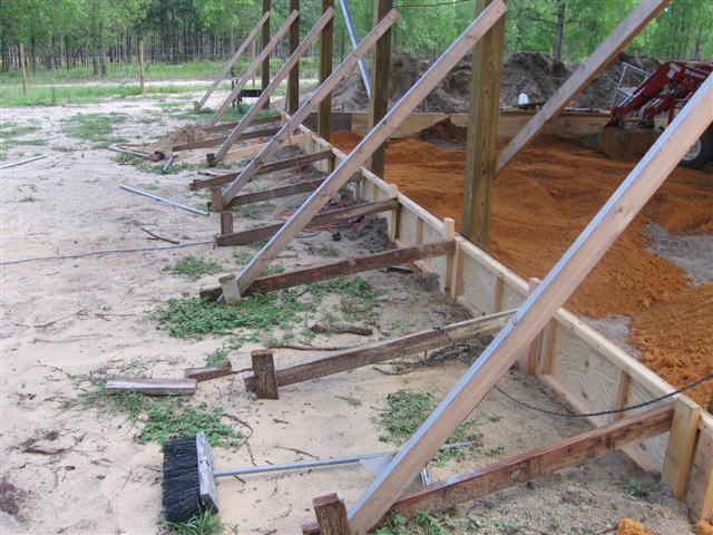

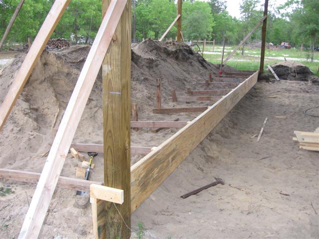

#63
I spent most of the weekend on the back form. The east form will be identical to this form. Because of th slope of the exsisting grade. I wiil be able to use 2X8's on the west side. I am going to leave the front open until all of the fill is in. I did manage to get a head start and build the forms for the east side, I just need to install them. Ran out of time this weekend.

#65
It's been a long week. But I finally got around to the east form.

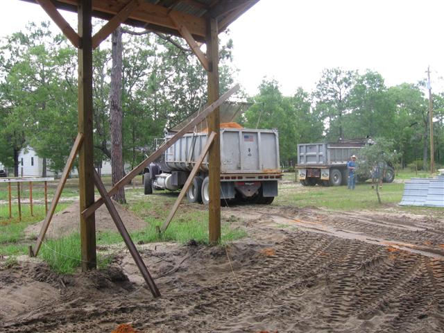

#66
And here comes the the fill. Now the fun begins, more seat time!!! Uh, I meant work not fun.

#67
The fill has a light mix of clay and packs hard.

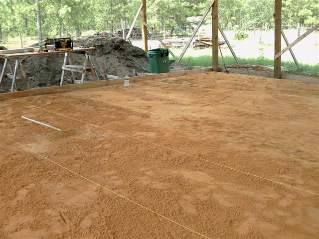

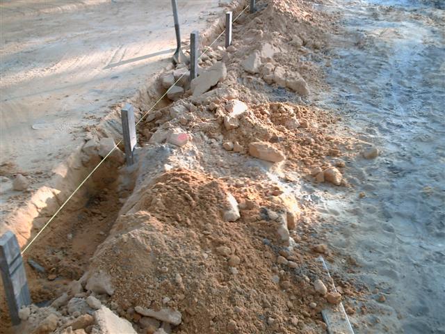

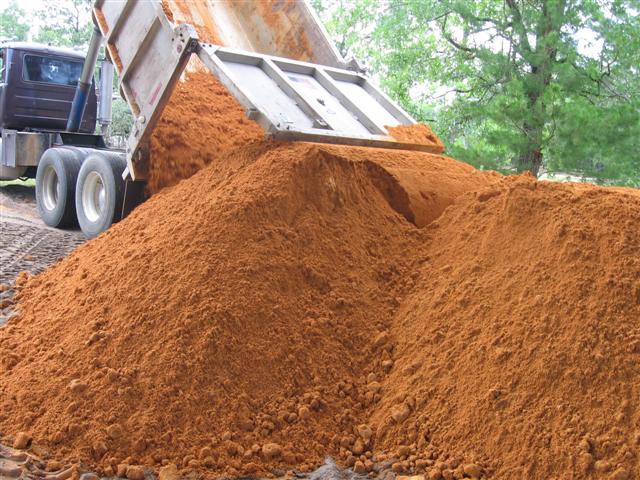

#69
It has been about a month since my last update. I have been pecking at it a little bit every day. Anyway I can not believe how hard the fill packed down I thought when I planned on 60yrds it was overkill and that I would have plenty left over. Boy, I was wrong! I wound up needing 22yrds more. :eek: Ouch! Dirt is cheap, it is the delivery that hurts.
The first photo is of the fill going in and things shaping up. In the second photo you can see how hard the fill was to dig out for the beefed up edges and front form.

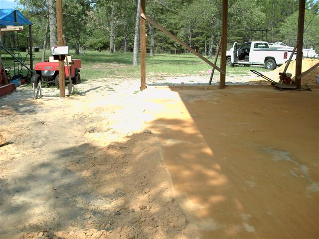

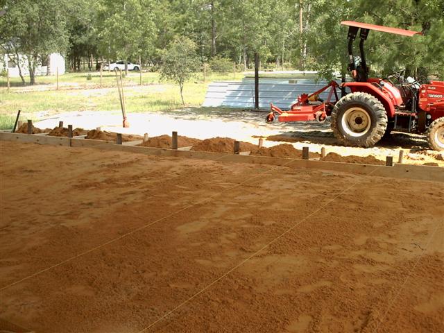

#70
After I got the front form in it was time tofine tune the fill dirt.
