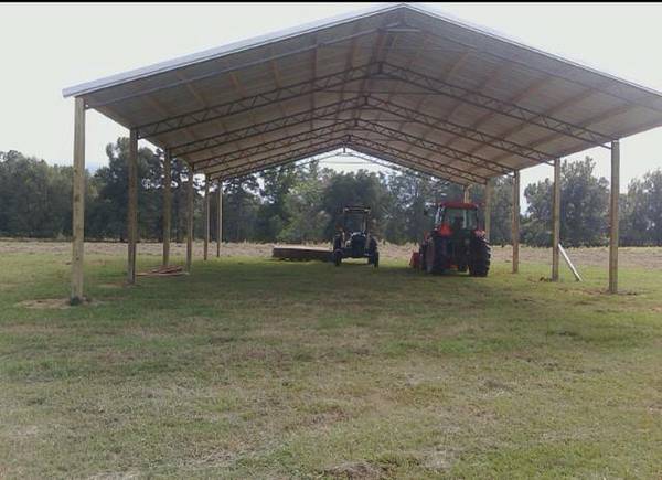

Any one built or had a Pole Barn built from 6x6 post with steel truss like these?

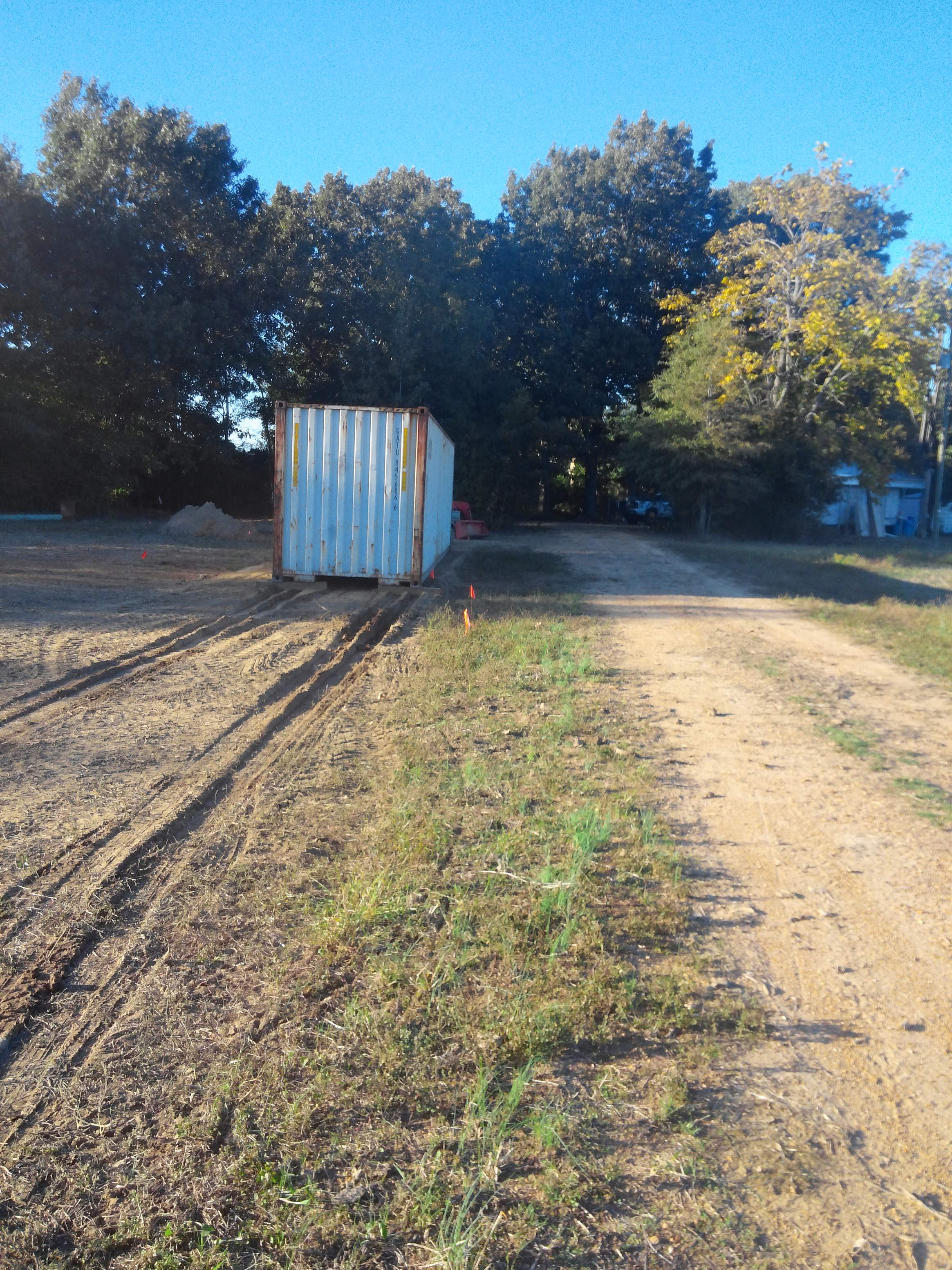

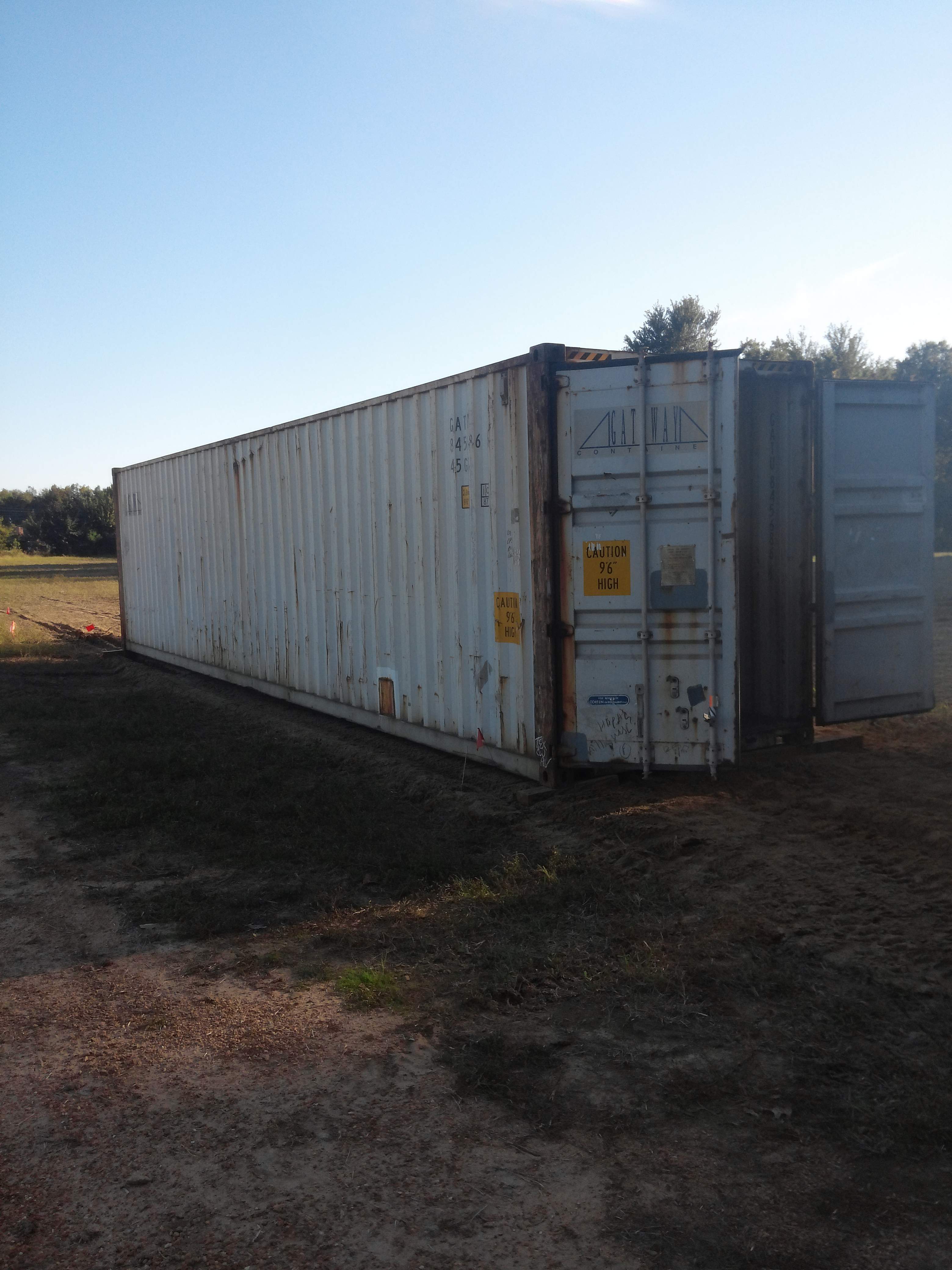

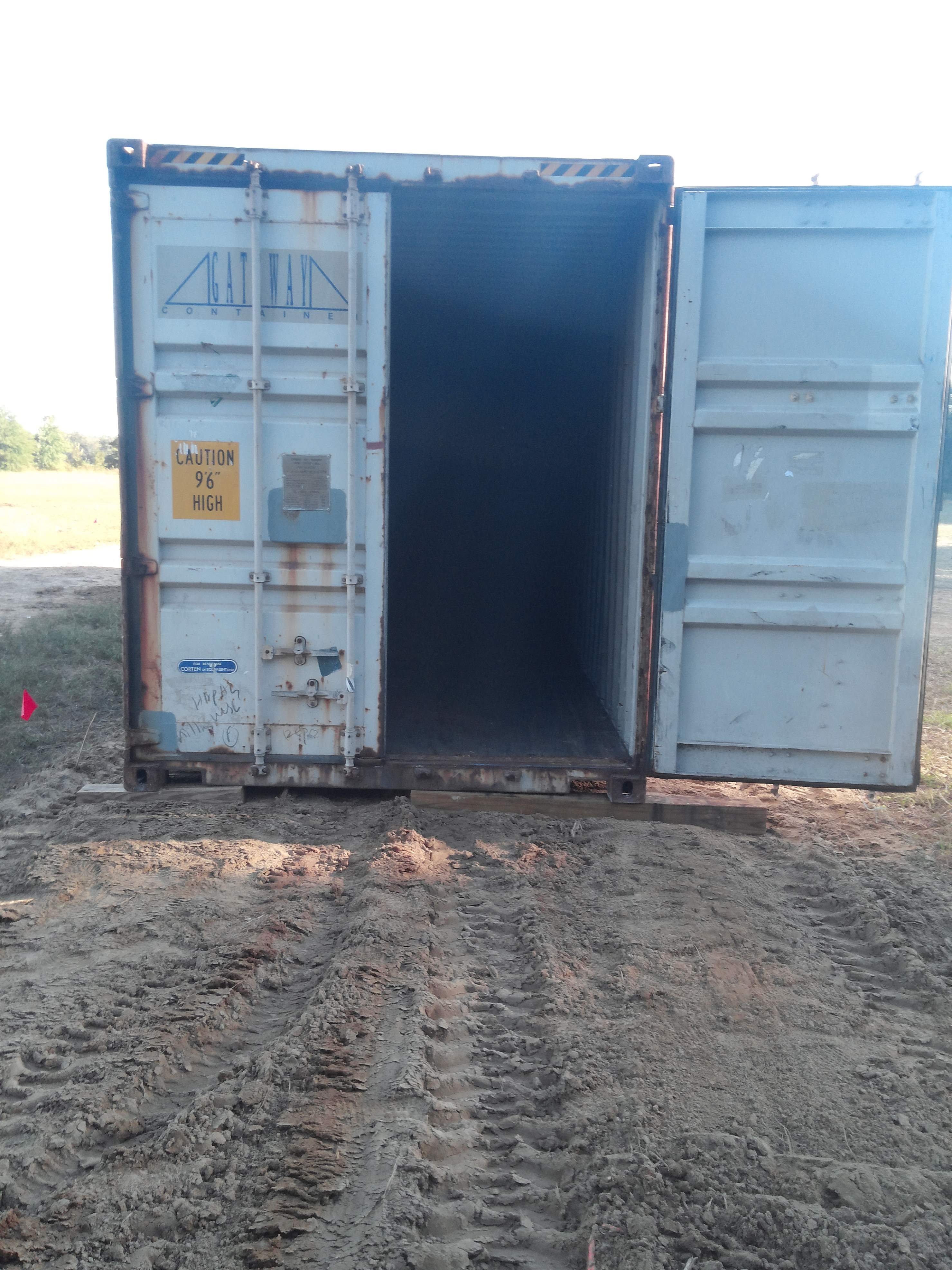

I have a 40' Container already with enough room to build 50'-60' shed beside it. Could build a lean-to over the container with app. 8' overhang at door end and 2' on other by erecting a pole shed 50' x ??

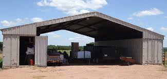

A local Bldg Supply has several that use the containers to support a truss system similar to this;
I calculated the approximate storage area for my equipment and future planned purchases and need no less than 1500SF. Thinking of maybe a 50'x 50' with a 10' x 50' shed over the container/shop storage.
I would appreciate any pictures or input for a open equipment shed/ container storage.

As far as the container, it weighs 8500# empty. It sits on a compacted bed that will have stone added for drainage. The shed will not connect to it, but a roof over it will help to keep it cooler as well as a exhaust fan. If I was going to use the container as a roof support, I would install concrete footings under each end for support.

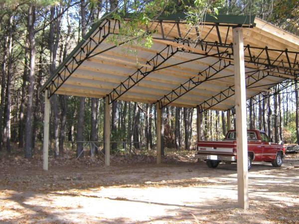

I like it. The barn our produce auction is in is made this way - with the steel trusses. The trusses have a bracket on them that holds a 2x8 on edge (acts as the strapping) every 2 feet. Pretty slick.

I have a 30x50 built with those type trusses, I had the floor poured after the roof was on then sided it with metal and used 2x6 for wall studs and finished inside with osb. It has r-19 in the walls and a drop ceiling done with 2x2 ceiling tile. No insulation in ceiling but has a minimum of 2ft airspace and is pretty well sealed. 10 ft side walls. Could not be more pleased with it, serves our purposes well. Warm and snug.
/ Pole Barns #13
Here, a building permit isnt necessary for a barn structure, or at least it wasnt when my brother build his barn. Anyways, those are the same type trusses he used. 60x120 I think is the size. The trusses just sit on top of the 6x6 posts. The post are tied together with a band, but I'm not sure size, 2x8 I think. The trusses have channel on the top side for 2x's and you just nail your lathing to the 2x's. Pretty simple and fast to put up. Not sure how high his barn is but you can raise the bed of a tandem dump truck inside it. I wouldnt want to hang anything heavy from the trusses, but they hold up the roof.
