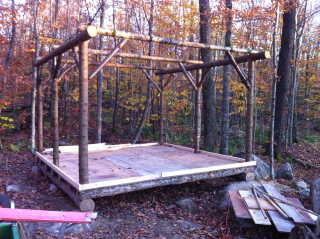

After I cut all of the floor logs I moved them to where the building was going to end up. There's plenty of 100+ year old barns up here sitting on rocks so that's what I went with. The front corners are on two large rocks that are in the ground. The right front corner required a rock "shim" to get level. I squared off and staked the back two corners then moved two large rocks into place. I used a hammer drill to drill a 1/2" hole a couple inches deep in the rocks. I cut a 6" piece of 1/2" rebar and dropped it in the hole. I drilled a hole in the bottom of the sill and placed it over the rebar to peg it in place. I also shoved rocks under the middle of the sills for support. I was going to use a truck jack to adjust and shim when frost heaves move stuff around but the "footings" haven't noticeably moved in two winters.
I ran string to make sure the top of the floor joists were mostly level for the plywood deck, shimming between the joist and sill where needed. The floor joists are pegged to the sills with steel rod. I'd pre drill a hole then hammer a cut piece of rod in place. The green beech logs were heavy, hard and difficult to work with. I salvaged 1/2" rebar, galvanized fence rods, threaded rod from wooden spools for wire, and anything else I could cut into big nails.
The plywood deck is all used salvage stuff. 2x6s left over from the house construction were ripped in half to be nailers for the pine siding. The bottom nailers are screwed to the plywood deck and the poles were butted up against the nailers. The poles are toe nailed onto the deck. I used 2x4s as temporary braces to hold stuff in place while I set poles and did the bracing. There was a lot of carpentry fudging going on. To get the top plate level-ish I used a bow saw and hatchet to notch the thicker end of the plate where it sits on the pole. The hatchet was one of my favorite tools on this project. It quickly chipped out a section when I had to remove some wood to level something or to make a flat spot in the side of the pole for the corner braces. Working with the balsam fir was much easier!
The poles are predrilled and pegged with rod wherever they come together. The braces were nailed in with a few big nails at each end. The poles for the shed part are also on big rocks moved into place. The poles were pegged to the rocks with rod like the sills.

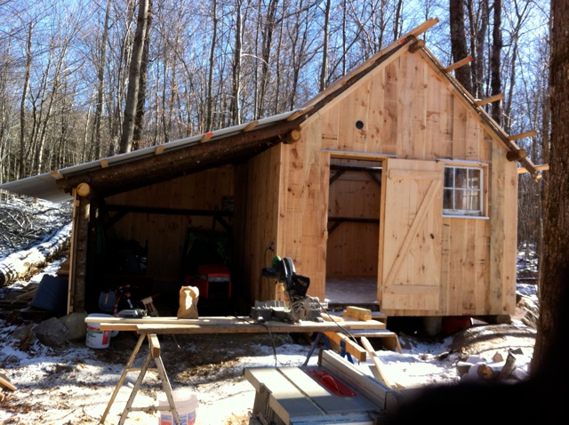

I made the rough opening for the door and windows out of 2x4s. Nailers for the siding were put up and checked using a plumb bob. To keep the nailers aligned vertically I would either shim or use the hatchet to notch out the poles. Being out a 1/4" or so was fine. The shiplap pine siding could flex over it. The framing was pretty stable before but the siding really locked things in. The windows were salvaged from the dump.
I saved the straightest poles for the roof rafters. The purlins still required shimming or minor notching of the rafters to even them out. The roofing for the shed part was made up of cover sheets for the corrugated metal roofing used on the house. I had to buy the rest of the roofing but it came precut to length which was nice. I made the rake edges pretty wide to keep things dry. The roofing panels were 36" wide after overlapping so I made the roof 15' wide so I didn't have to rip any panels. It's amazing how strong the corrugated roofing is. There's at least 18" of eave overhang off the shed side and I can stand on it.
