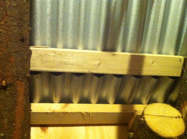

Can you show me how you did the two different roof angles with your metal roofing?
I put the shed roofing on first then the shop roofing comes down right on top of it so the corrugation matches up. There's about 4-5" of overlap. Can't get a good exterior photo of it now due to the snow but here's what it looks like from the inside.
I was a little worried about running the wood stove and have the melting snow run off the shop and ice dam over the shed part. Then it might back up and drip into the shop but that hasn't happened. If it ever did I was going to cut an inch off of the shop roofing and get a roll of 12" or wider flashing to stick under the shop roofing and over the shed roofing. If I had flashing I would have done it that way but I was trying my best to make things work with what I had. It hasn't been an issue so far.
