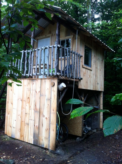

I've got a bunch of ash trees on my property that need to come down and I'd like to do something like that with them. I'm thinking about some sort of "fort" for my step-son.
Doing the same kind of thing, I built the kids a playhouse this summer. They wanted a treehouse but I went with an elevated playhouse so I could sneak in some storage below it.
I also wanted it to be sealed up better to keep out bugs and spiders during the summer when they camp out in it. I kept track of expenses and I spent a total of $550. Plywood decking, osb sheathing, rough cut pine siding, and metal roofing. The rest was salvaged materials, door, windows, old cedar decking. I also lucked out with thirty used 8' 4x4s that I used for floor joists and "post and beam" interior.
Happy kids!
