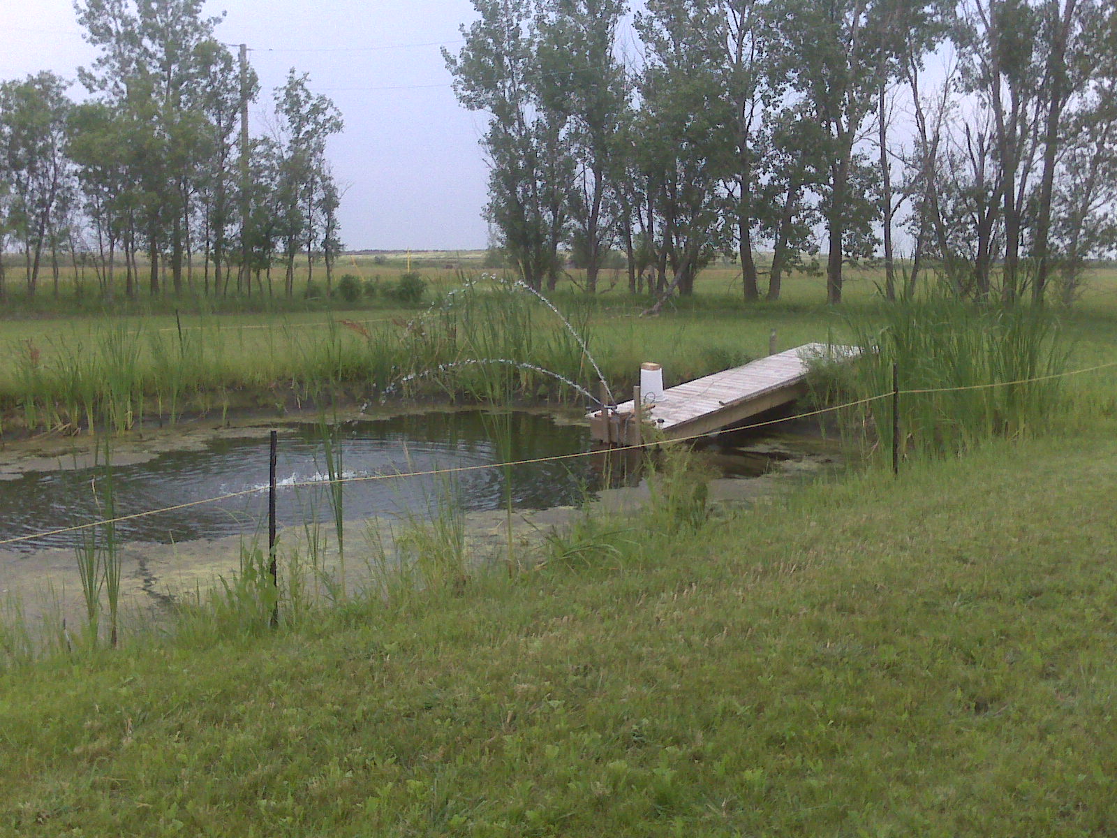

Last year I rigged up a 1/4hp sump pump off the end of our dock to spray up in the air like a fountain. I like the sound of it, esp when I come home at night. I was just curious how much it is costing me. Does anyone know how to calculate the numbers? It is a 3.5amp motor, my electric bill says we pay 6.38 cents/kwh? Is that the correct numbers? I'm not that exp with elect numbers. Thanks

I am interested to know what you did to rig it up. Does it run all the time? What type of sump pump? How high does the water go? Any pictures of it? I would love to do something in my pond but have found that the price to buy everything is very expensive. I do have an old pump sitting around though and maybe I could put it to good use! Just curious.

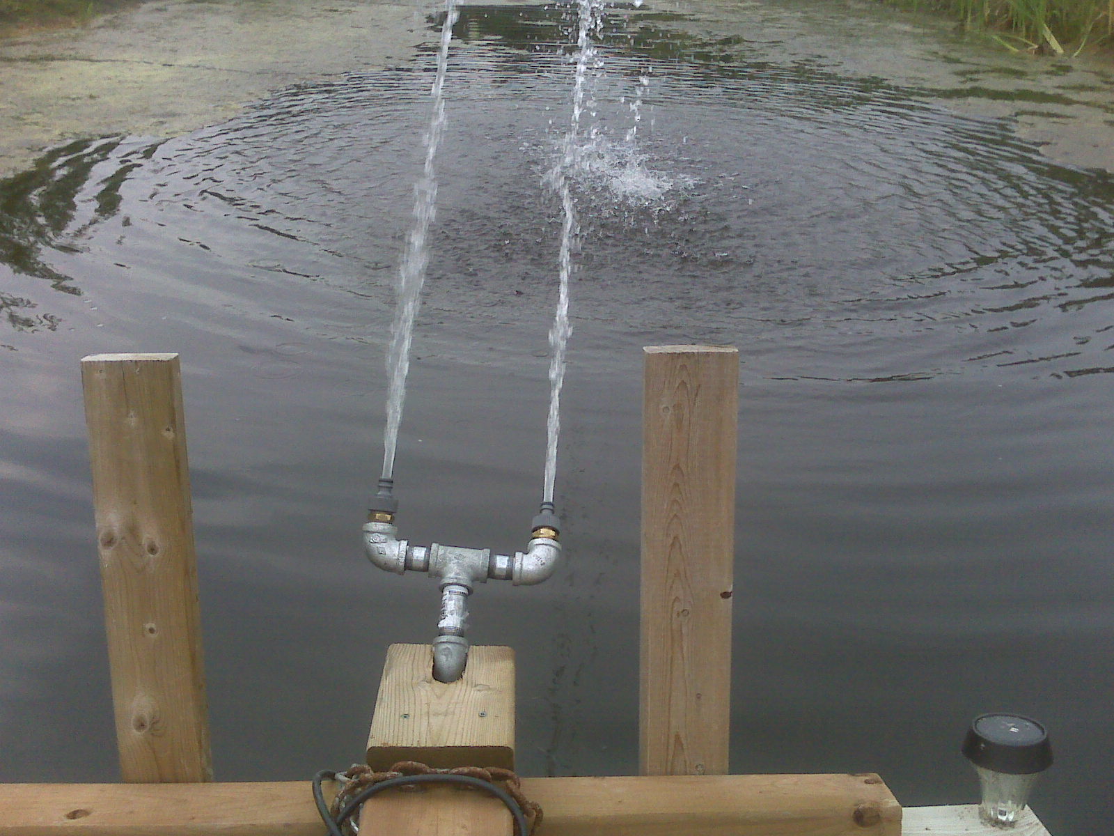

I only ran it until there was about 1" of ice on the outer edges of the pond. I wasn't sure how deep the pond was going to freeze. That reminds me I forgot to cut a hole this winter to check like I was going to :mad:. I will post some pics when I can track down my wife and her blackberry it takes just the right size pics to upload. I used a 3' galvanized pipe with an adapter for a garden hose quick attach at a 45 deg. I still haven't wired it in permanent, still trying to grow grass, but will do so with a gfci eventually. There was still a little algae last summer, looking at adding a small windmill and bubbler as well.

I finally got around to some pics. As you can see we do have some algae, will be checking into some solutions for that. On the other hand it has been much warmer and sunnier this year than over the last few, don't know if that is relateed.
