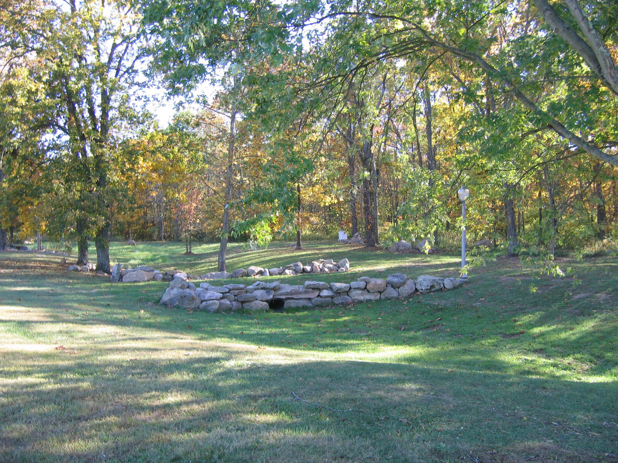

Thorn, Here is what I use. This is one tool that I wouldn't be with out here on the Devil's backbone that the glacier left behind for me. I have dug out more rocks with this thing, than I care to think about. :( Many at the lift capacity of the loader. It is a beast. Can be used for digging out rocks, and carrying/placing them, digging out trees for planting/moving, cutting a ditch, and a host of other uses. Love this tool! Moved all the rocks you see in the bridge pic. :thumbsup:
I'll try a link.
