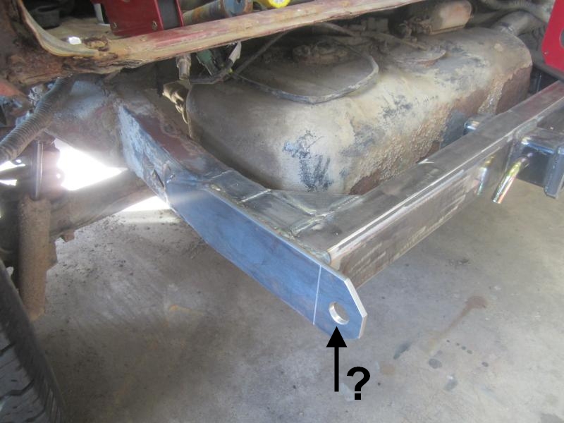

Just curious about the holes?
   / Poor man's side by side
#105
Shackle tabs...or D rings, whatever you prefer. When offroading sometimes it's handy to have a choice of tow points. One good example is poping someone out of a snowy ditch. Ditch side on stuck rig, and opposite side on tow rig. Opposite keeps them both going in a straight line...or can pull the tow rig in the ditch too.
I didn't have anything capable of drilling for a 3/4" shackle so I'll pick up some 5/8"ers. The Tracker's half the weight of the jeep, so should be plenty strong.

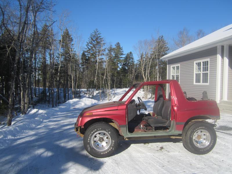

Finished the rear frame section
Took her out to clean the garage, and bring the trash to the end of the driveway
Finaly took a little vid;
YouTube
...and promptly got it stuck. LOL
YouTube
Got a little redemption running the trail between me and the neighbor after :)
   / Poor man's side by side #107
Bwuahahahaha! NICE! :thumbsup:
   / Poor man's side by side #108
As light as that thing is you will probably need some more aggressive tires for snow, maybe something like an tractor tread.
