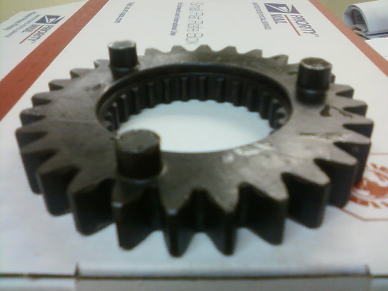

in this tractor the selector plate prevents you to choose two gears at once. If the plate is up side down it would be like throwing it over your shoulder. You could still choose all of the gears and it could be like this for years before one day two gears are selected together.
the plate is curved and on instalation the ends must be up wards. With the gear box in netural the two low points are placed in the two outstde seclectors. the gear leaver top is placed on top and the top holds this in position.
If you look closely at under the gear leaver top you can see were the selector has marked the top. one can also see some elecrtolis caused by steel sitting there.
I would say the selector has been up side down for a long time as he was not been able to choose all of the gears when he first got the tractor.
he might want to put the selector plate in as in the picture having the slot running back to front. that should stop him being able to choose two gears at once.
the gear that bruse 1966 has displaid is the high raitio gear on the bottom shaft. it is the second gear from the back and more than likely in your tractor the pins are worn. If those pins are worn so will the mating holes. You will need to replace both male and female parts of that dog.
   / Popping out of gear #60
Yep, 2 gears need replaced.....
