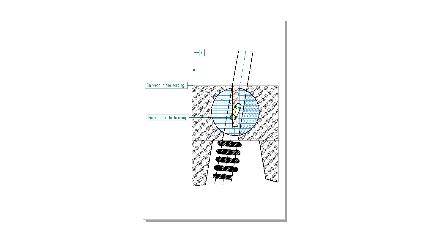

I got home late last nite and after some more home improve work at home, I took a look at the shift lever guide that Hoye suggested.
I am no expert but it looks pretty worn to me.
Why has that part wore like that? Is it because the lever is traveling too far. is this stopping the gear going right in.
Now if that part is worn then there must be play in the linkage between there and the lever and selector.
What does the ball set in ?

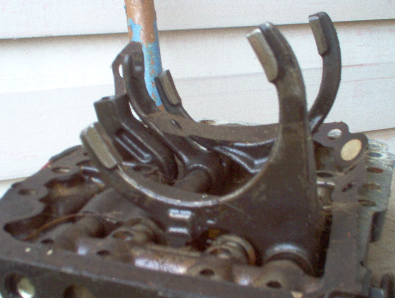

Cardoc you havent seen worn selected forks before Here is a photo of one with one side worn and the other not.

"Cardoc you havent seen worn selected forks before Here is a photo of one with one side worn and the other not."
Yes. That one looks perfectly normal to me and isn't even close to 8balls, fork is sitting down low enough in the clutch sleeve and has a slight bit of wear unlike 8balls which has the fork sitting high in the sleeve/gear and offset like it was chewed up by a gear.

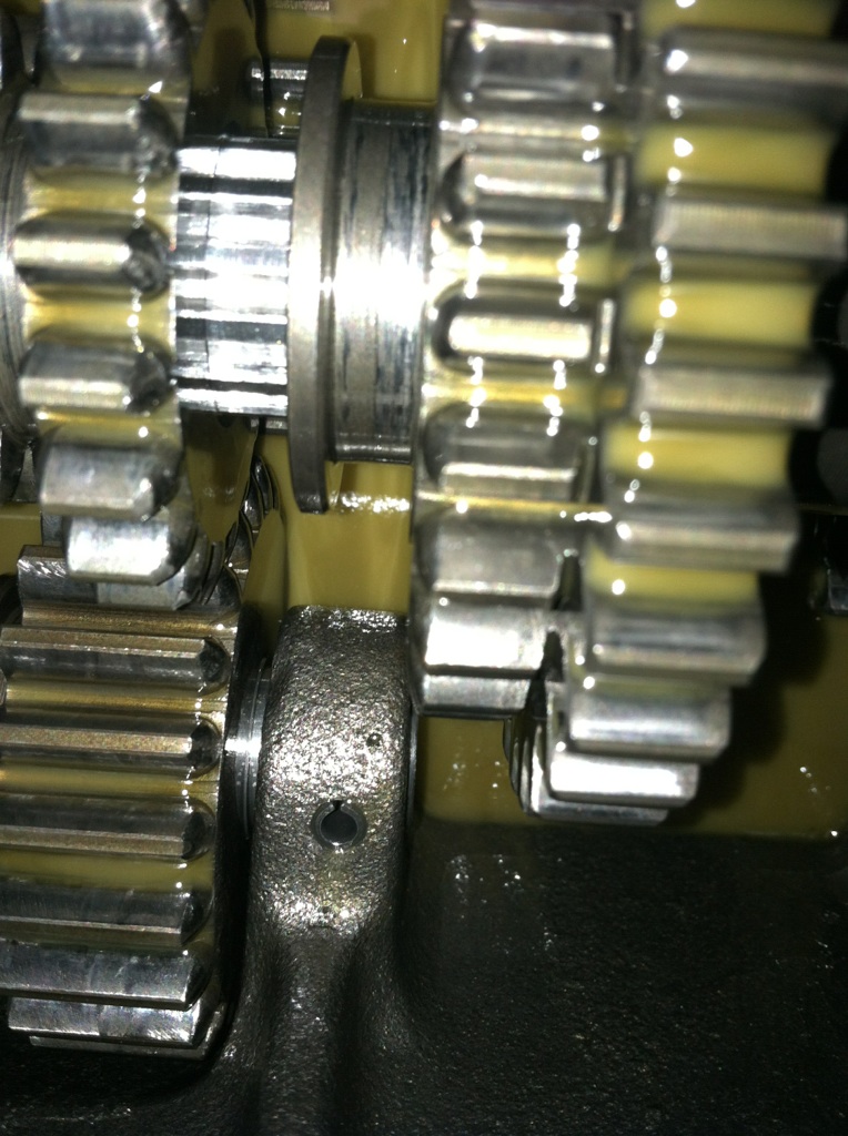

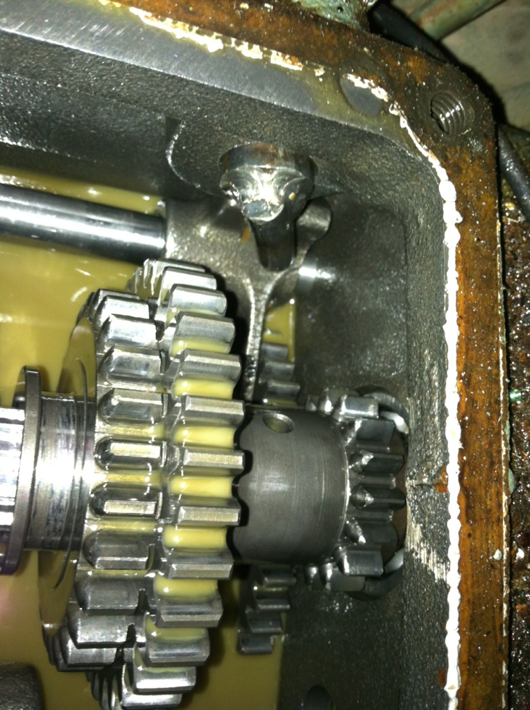

Looking for some help, I've posted on Yanmars boards, but really need advice.
the only gear that worked was 1st and reverse was in the neutral spot... help. Pics of gear box and forks below. Are the forks suposed to move easily up and down the shafts? ................................................
sorry I am completely clueless when it comes to mechanical stuff.
Good to see that you want something fixed that is not going to cost you anything, except time.
You made a mistake and every mechanic will do what you have done some time in there career. The mistake you made is you didn't check to see if it was right before you went back to work.
In the Pic below you will see the gears as they were when you were driving in first gear.
When you stopped and put the gear into neutral the reverse gear was in the wrong place. the gear was set as it is now in its place for reverse gear.
What happen is when replacing the top the selector missed the reverse gear.
When you replace the top you will need to make sure that the selector and gear are in the right place.
Cost .............. only your time your wife will say that is worth lost of money.
If you are not going to supply more info to see if there is other damage to the Hi - low gear selector you could try working in the low box in the higher gears. that will also protect the weekest gear in that box, first gear.
Still first and third gear are not fully engaging and if left they will fail.
Before replacing the top make sure the gears are in the correct place.
after top is in place make sure all gears are doing what they should.
Test the gears with tractor at idddle. Reverse, first second thitd forth and then forth third second fitsr and reverse. If the tractor moved then the gears are correct. if the motor stalls then you have misted one of the gears.
