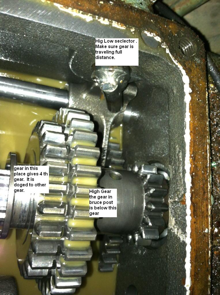

in this photo the gear is in 4th gear. Again it is a dog comection.the gear that bruce is talking about is below the high raitio or 4th gear .
in the photo I have marked the pin/lever for the Hi - Low gear change. I notice in over time. If yours is stiff it may be a good time to clean the pin and hole.
To remobe remove handle and then the locking tab on the out side of gear box. tie a string around the pin so it wont come off. (this saves trying to fish it out of the gear box.) After cleaning all of the paint and dirt off the pin using a peice of wood for a punch remove the pin. A clean rag over the selector rod and gears will catch any small bits of dirt.
As the string is also tied to the stearing wheel (give it a bit of slack) the hole and pin can now be cleaned after removing the 'o ring'. After cleaning replace the 'o ring' and lub with grease. Reinstall the opposite to dismatle and check that there is full travel before replacing top.
that is maintance and will prevent or delay the leaver becomming stiff.

Got my parts from hoye today and reassembled the shift assembly. It will be a few weeks before I get it on the tractor so I will update then. Thanks for all the help.
   / Popping out of gear #65
How did the new parts compare with the old? Much evidence of wear?
#66
the onlt noticable damage/wear was on the shift lever guide.
had a **** of a time getting that spring compressed to get the c-clip back on. Dont know how many times it launched off accross the room..lol.
