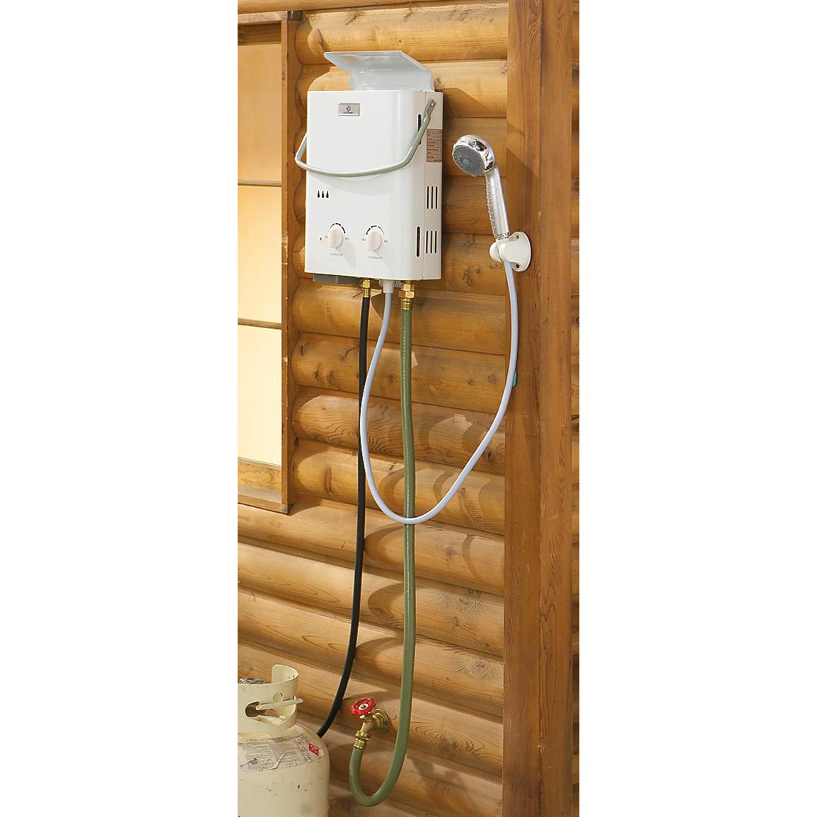

The electric on demand water heaters take a fair amount of power to use. If you are going to have propane why not use one of these?

I do have trees, thirty plus year old pines, but really don't want to fool with a log cabin,or cut my trees! not a bad idea though. I thought about one of those, on demand propane like that, they sell something similar at our local orsheleins, may look into that! Good ideas guys, thanks LUTT
Bosch Tronic 3000 Point-of-Use | Electric Tankless Water Heaters | Efficient Home Heating Products
I was thinking of something like the US9 model 9.5 kW on the high setting , or the US12 model 12kW. 1 to 1.5 gal per minute assuming 55* rise in source water temperature.
If electricity costs $0.15 per hour (don't know Ark. rates, but probably lower):
A 20 minute shower at 9.5kW costs 47.5 cents.
A 20 minute shower at 12kW costs 60 cents.
Bosch Therm 330 PN | Bosch Gas Tankless Water Heaters | Efficient Home Heating Products
This gas unit is rated at 2.1 gal/min for a 55* rise in water temp.
It looks like it has a modulated flame, 30,735 btu min. to 75,000 btu max.
75,000 btu is 83% of a gallon of propane per hour.
At $2.00 (a guess) per gallon propane a 20 minute shower costs 55 cents.
If those flow rates of 1-2 gal/min are not enough, then the higher capacity units favor propane I think. Depends on what you need/want. :)
A typical low-flow shower head is said to be 2 to 2.5 gal/min.
Did that help? :laughing:
