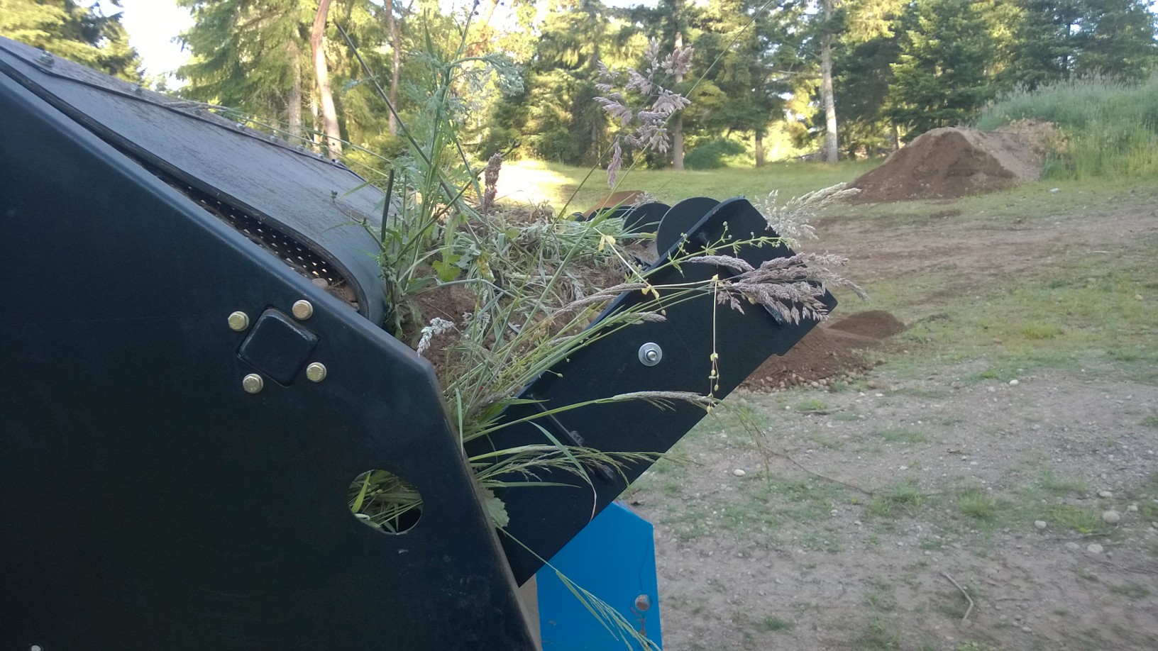

Glad to see you are up and running material! I tried the clamps and really didn't like them. While I don't seem to have the same issue with the standard New Holland bucket, I found it to be a pain to grab the clamps and hook them on... I know it takes a minute or two, but I can swap my bucket and forks in that same time. And my forks weigh a couple hundred pounds less making it easier to move the unit.
When I originally looked at the unit last year, they were selling a tire setup so you could pull the unit with a truck. I don't see the photos on their website, but they hooked in the big holes on the side panels. Might be an option. One other thought that I've considered is welding a quick attach plate to the lower box.
I'm surprised you are having issues with grass catching. I don't have the rubber mat and wondering if that's causing the unit to clog up. I've run material with weeds and wild grass and never had a problem... I normally have to tap the screen a few times to cause it to bounce the material down... Is your dirt/grass wet? In any event, I'd talk to Brad at OMH and see what they can do to fix that problem...
   / Portable rock soil recycler for tractors #22
It does seem the mat makes grassy material plug much worse, the stuff gets trapped under the mat and there is not enough downward force (gravity) to pull it through. It ends up so jammed I have to pull it out manually from below.
The mat is nice on the straight dirt and rocks stuff. I may try taking it off and running that same grassy material through it just to see the difference. I am guessing it is easier than changing a screen. The stuff I am screening is all bone dry.

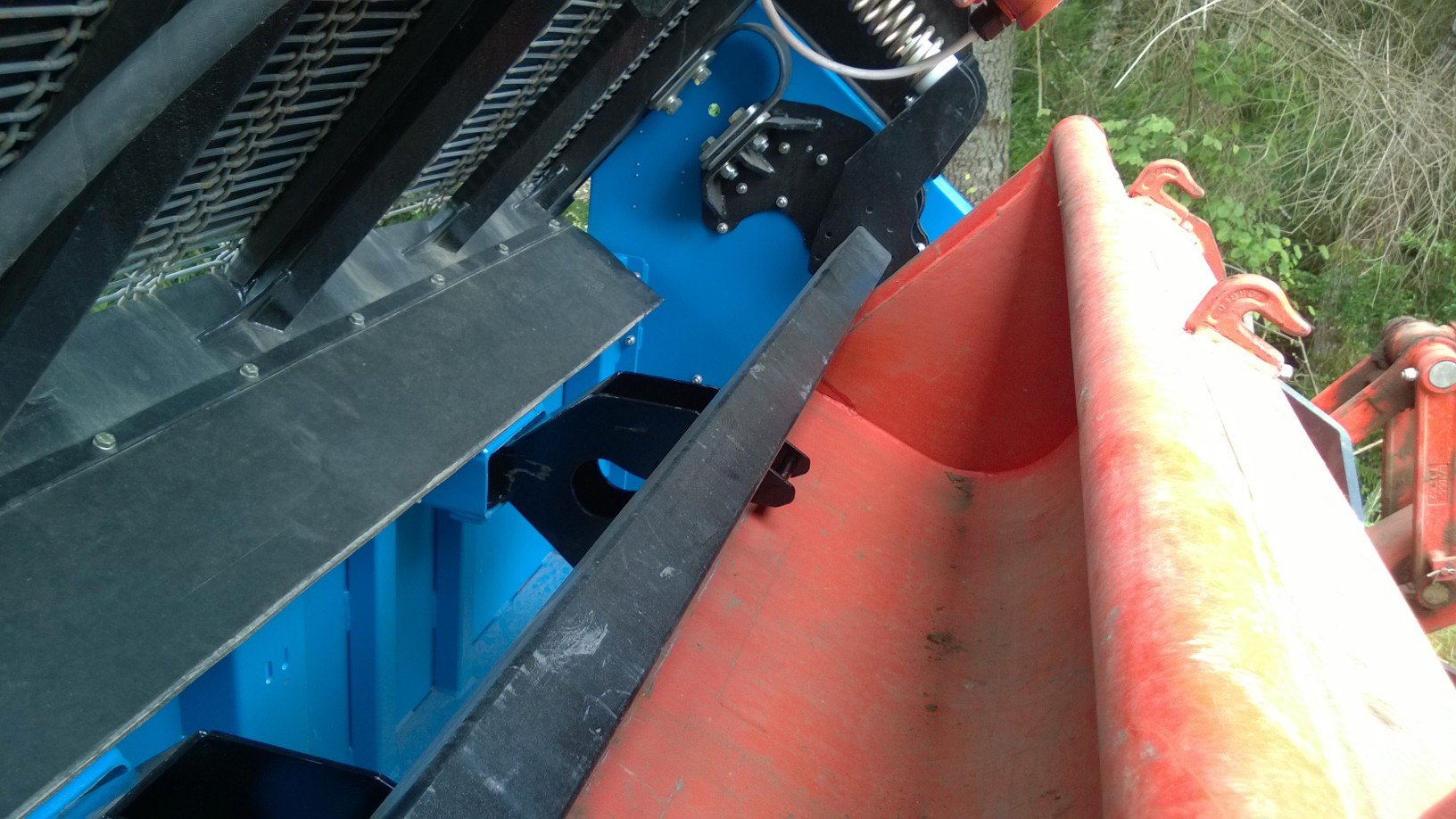

Not that big a deal to swap in the forks, that is probably what I'll do most of the time.
I was thinking the same thing about how a quick attach mount on the outside would be great, although it would tend to get covered in dirt.
When you pick up the unit with forks from the outside, do your tines angle up all the way to the inside crosspiece when you lift?
Does your tractor lift the unit easily from the outside with the bucket clamps?
How hard is it to swap screens?

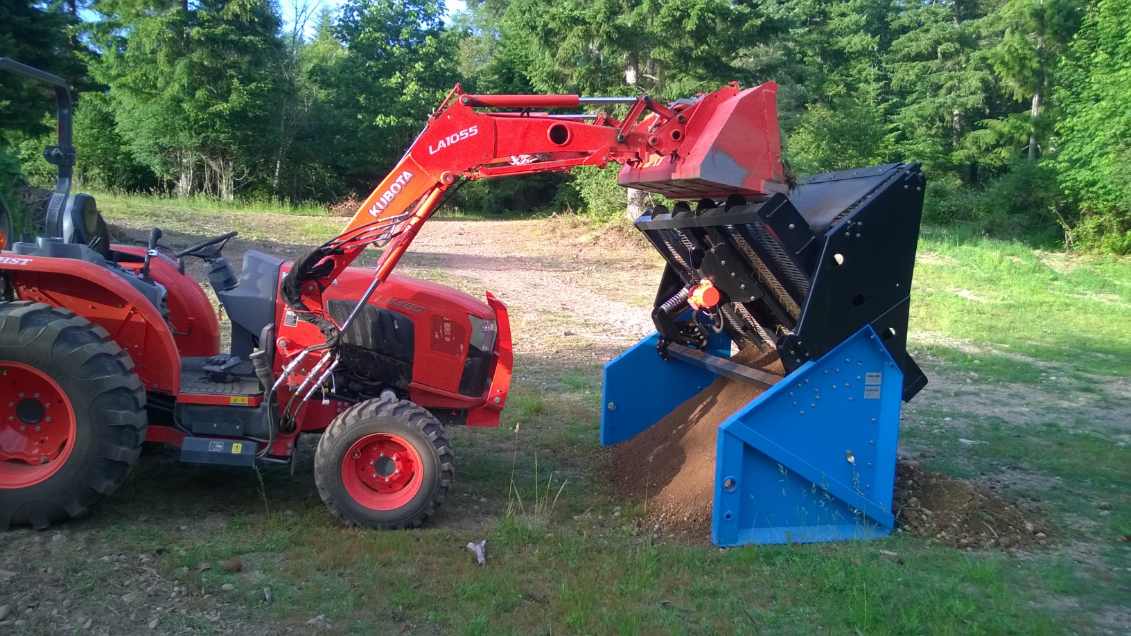

It sounds like the mat keeps the material from springing up and down when bouncing the deck... I'm not sure if I'd like that.
With the clamps and my bucket, I had a hard time lifting the unit. First, the New Holland loader has curved arms and it extends a ways from the front. So to put the unit on the end of that is pretty hard to lift. Plus I did t like having that much weight out in the front. When I'm using the forks, mine angle up maybe 15 degrees, but they don't touch the center bar... Maybe mine are a little thicker?
I've switched out screens a couple times. It may just be me, but it takes longer than they say. Switching it out with a partner takes me about 15 to 20 minutes. Doing it by myself is tricky but takes about 30 minutes... But it's hard holding the screen on until you get a couple bolts on. I wish they had made something to temporarily hold the screen until you could bolt it down.

After about about 3 hrs using the screener I noticed both coil springs were broken into two pieces. I don't remember it being like that before but I can't imagine what I've done that is unusually hard on it.
   / Portable rock soil recycler for tractors #26
Hate to say it but it looks like the machine BGigHarbor is using needs some more design work, I hope the Manufacturer works with him to improve this machine. I'm dealing with tons and tons of rocks too, it is starting to look like I'm in the market for a dedicated rock picking machine.

In regards to the grass and clumps. My suggestion is to remove the rubber flap from the feed deflector for now. When feeding the screener with this type of material, just pour the dirt from your bucket onto the feed deflector. Try to keep your bucket about 6 inches from the deflector mesh so that you can have some control over the flow of the material from your bucket onto the screen deck..
