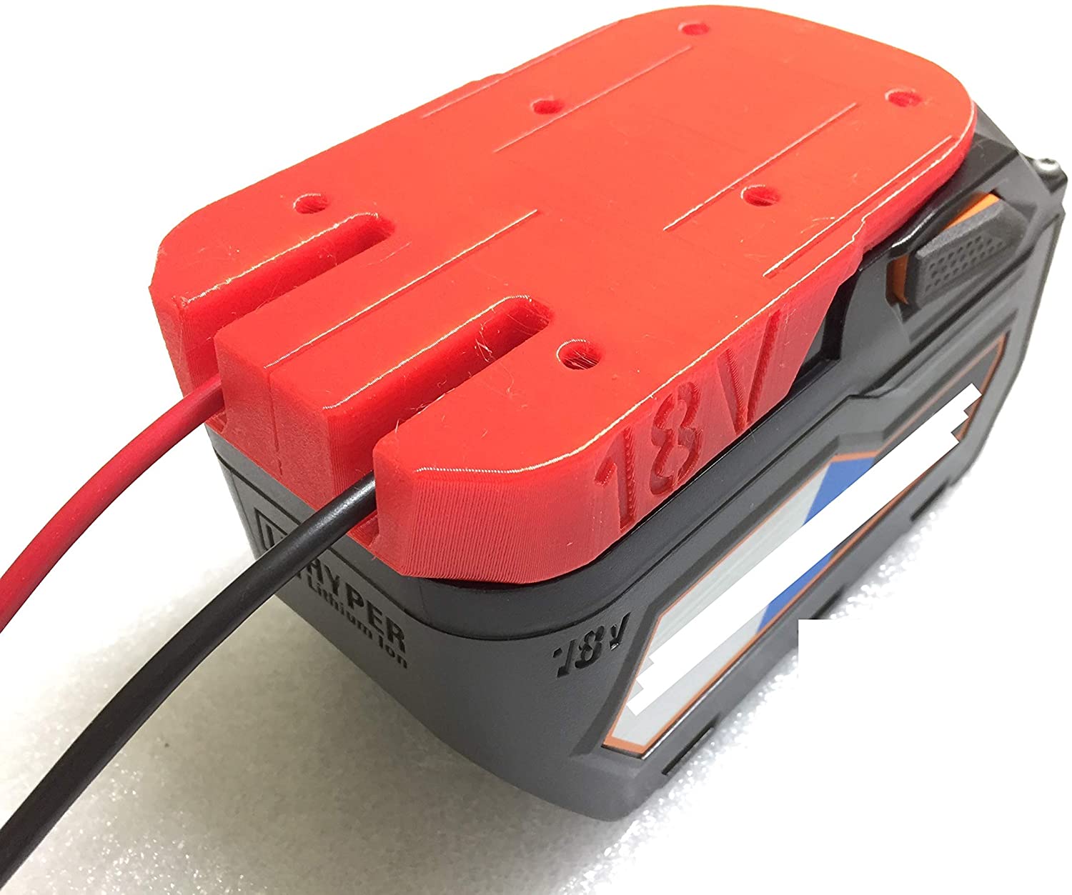

You can make a portable camera system from almost any wireless camera & monitor you have around. The trick is to power them with cordless tool batteries and use magnetic mounts. That way, they can be placed anywhere and even moved from tractor to tractor with no wire connections at all.
In post #29, I linked a thread on how I made one:

I tried that and it killed my cordless battery. Too easy to forget to remove the battery. It will drain to nothing and then it is done. Tried to "resurrect" the battery as shown on some YouTube videos but the battery was never the same and I junked it. Dewalt LI-Ion batteries are not cheap.
I went with a camera that can be charged via USB and solar charger.
Certainly a consideration, and important to know.
To avoid this, I never leave the batteries connected to the camera and always use a freshly charged one when I use the system. A 5AH DeWalt battery will power my camera and / or monitor for around 3 days of continuous operation, more than is required for most work operations. By putting a fresh battery in every morning, I've avoided any battery damage.
Of course this can vary depending on the camera and what you're doing with it.
Most people do not use a tractor that often. The setup you have works for you but may not be the best for most folks.
BTW, it was your original post that had me try using a cordless battery and it worked great...until it didn't. If someone goes down that road, I suggest getting a cheap knock off battery. A 5 amp Dewalt is $70, the knock offs are 1/2 that.
Anyone who uses DeWalt batteries in non OEM devices should be aware that there is no low voltage cutoff in the battery. That circuit is in the DeWalt tools. There are many aftermarket devices on the market that will damage DeWalt batteries by over discharging.
Other brands, like Makita, have the LVC in the battery and are not subject to this problem. Always a good idea to check first.
