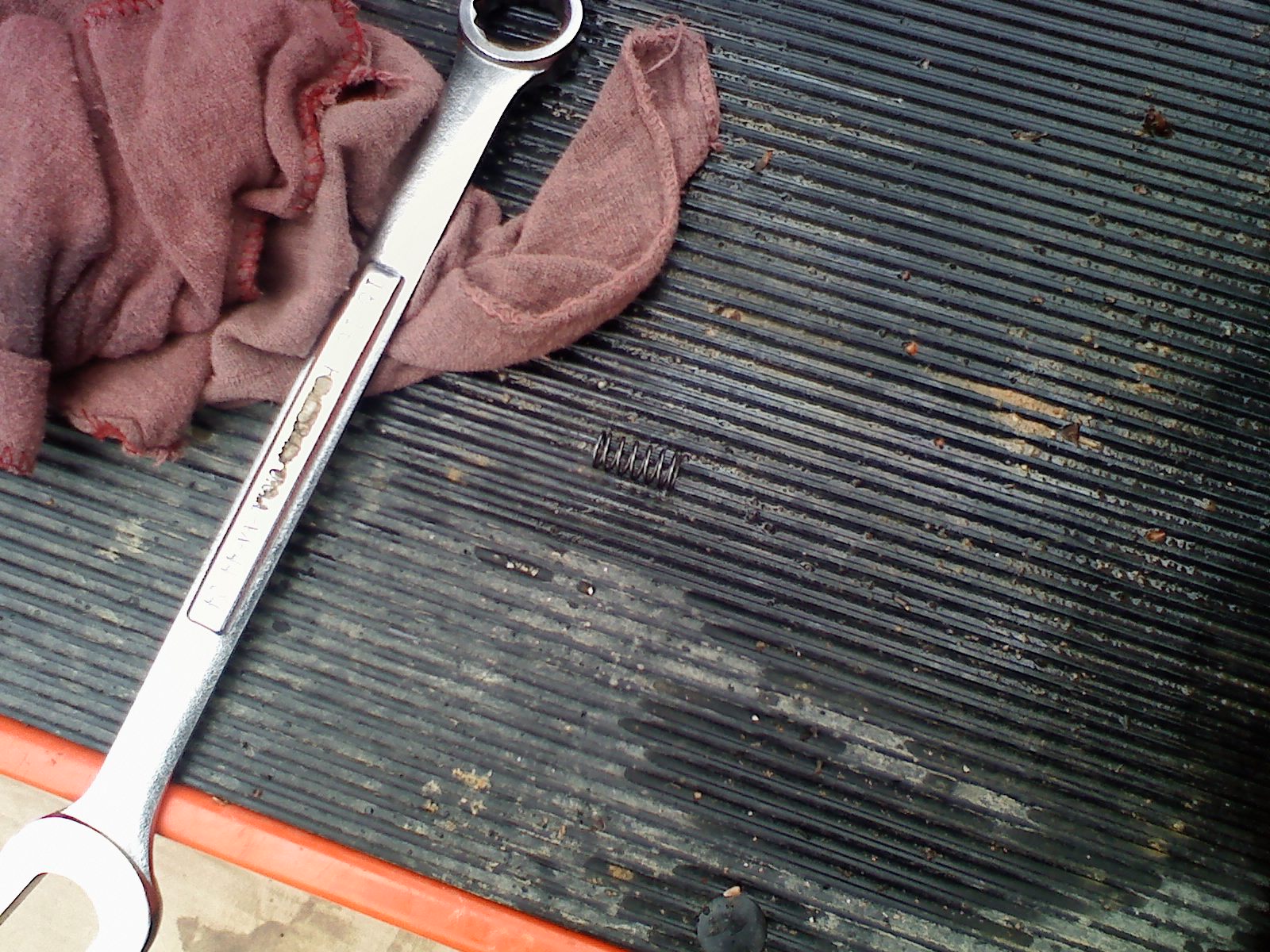

Unfortunelty, the fix did not help at all. My dealer just left my farm a little while ago, after he closed shop for the day and did this work on his own time. He apologized for it not helping and I explained to him that I still love this tractor and for him to not worry about it. It was worth a shot but it failed. He will contact the regional rep, that said this would work, to let him know the results.
Attached are a few pictures that didn't come out well since the lighting was bad from the rain we are having. The first picture is the pilot relief valve spring that was supposed to help the issue. He brought a new one and shortened it by 1 1/4 turns. This was supposed to drop the psi from 115 to 85. He ended up shortening the spring about 2 turns until the pressure was dropped to 80 psi. The second picture (sorry for the quality) shows the port where the guage was installed to check the pressure. Just behind it was the port where the spring resides. Both are allen wrench type plugs and were hard to get off because of the loctite that was used. Also, if someone wants to try this themselves, hydro fluid will leak out while changing the spring and attaching the guage.
Before the dealer arrived, I tested the reverse stop at 2000rpms to get a good feel for the abruptness so I could better gauge it after the fix. After the pressure was dropped to 80 psi, I moved the tractor forward a bit and noticed a slight vibration in the forward pedal. While going in reverse at the same speed and rpm, the stop was just as abrupt, no improvement at all. He put the old spring back in and back to normal after replacing about 1 quart of SUDT that was lost during the process.
In hindsight, I wish I would have never created the thread and should have waited until the work was done. My intention was to inform everyone that Kubota was at least trying to correct this flaw.

Sorry it didn't work. Glad you started the thread. Brothers and sisters disagree but we're still related. This is the Kubota family and we're all individuals with different experiences and backgrounds. Gives us different perspectives but expressing opinions, that's all most of them are, is what this forum is all about. Buck up:) and keep us informed.
