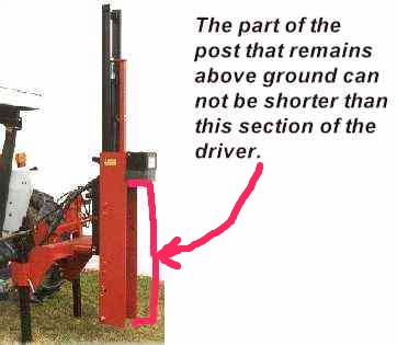

<font color="blue"> Do you use the stands like that pic shows? I have never even used mine except to store it. </font>
Yep. I drop the driver down until the outriggers (see attachment) are almost on the ground (in case I have to move the tractor backwards/forwards), then I center the bubble, drop the driver the rest of the way so all the weight is on the outriggers, double check the bubble and begin driving the post.
