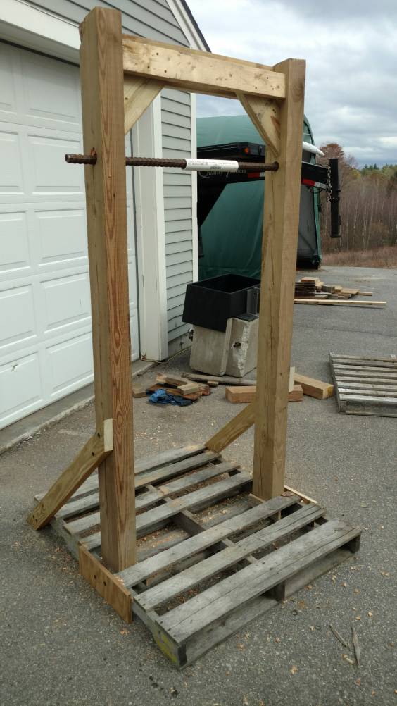

These bigger PHDs are a pain to hook up. Like wrestling a lead octopus!
So I threw together a palletized stand. I might put a roof on it later.

Got any pics with the unit hanging on it? I'd like to see that if possible. THANKS!!

THANKS!! YOU are a good man! :thumbsup:
I just got a post hole digger as part of the deal when I sold my old chipper. It's laying next to the garage right now. Your design is simple (so I can build it!) and looks like it will work well.

I used what I had. If I were to do over...
Start with a pallet in better condition.
The posts would just be PT 2x6s and would be on the outside of the pallet rails (just for more wiggle room).
I still haven't figured out how to best deal with the drive shaft. (earlier in this thread, Brian has a pic of his rack and how he holds the shaft:shocked:).

I know that this is a common complaint, but why would anyone leave this type of implement just lying around or go to the trouble to partially take them apart each time? :confused2: It is easy when you have a stand such as yours or similar.
Depending on how I might be feeling at any particular time, but I can always have mine off or on in 5-7 minutes. That's dealing with the hitch, PTO shaft and the hydraulic hoses for the down pressure kit. It just doesn't have to be as hard as many people make it.
Regarding:shocked: Hey, I use what is handy and the chain is always there for the PTO shaft guard. ;)

A stand certainly makes a huge difference.

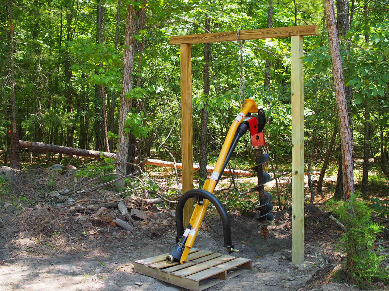

So I put something approximating a roof on the PHD rack. Might catch more wasps than rain. IMG_20170423_153226002-2254x4007.jpg

Have thought about a roof but have not gotten there yet. My ETA PHD is hanging at a great balance point that allows easy movement for hooking up.
