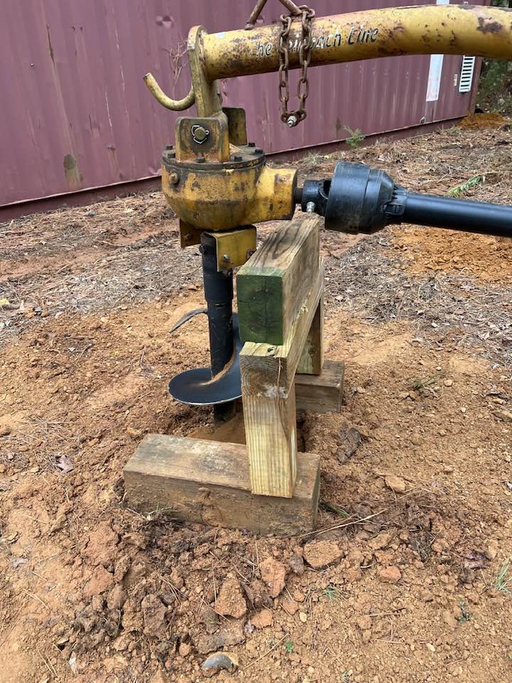

When I used my 37 hp tractor, I bottomed out all the time. At first I used a 36 inch pipe wrench to unscrew it, but I had to add a 2 inch metal pipe to the handle to get it going. It was very painful. Then I used my backhoe to pull it out. That was easier, but the hole became twice as big when it came out. Then I got the idea to put blocks under the gearbox of the auger so it wouldn't go all the way down, and I could keep it spinning. This worked great. Kind of a pain to have to put the blocks in place, but it worked 100% of the time.
Now I have my auger on a 65 hp tractor and it's never been an issue. More horse power means more hydraulic lifting power on the arms.
   / Post Hole Digger bottoming out #18
Did you do this before every hole, or only if it got stuck, and then you set up the blocks and turned it on for a bit to loosen what it had bitten into?
   / Post Hole Digger bottoming out #19
I was only using the auger for small things when I came up with the blocks. And I used them every time after I saw how good they worked. I was thinking of making something out of metal that would fold up and be more like a tripod when drilling holes, but then I got the bigger tractor.
