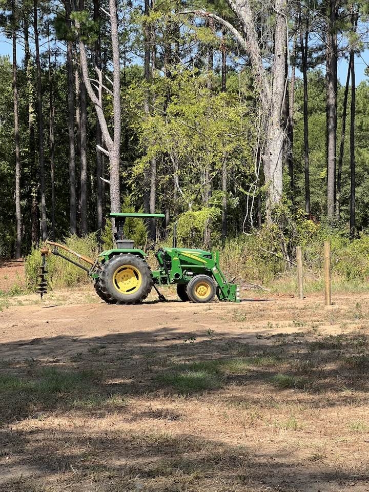

I made my own hydraulic auger out of a garage sale motor and an auger adapter I fabed up. Bolted to a plate from Amazon that fits onto my JD QA loader left side arm. Hoses to the curl loader circuit. Now I can see the target area, how the digger is going, and use the other loader paddle to push existing fence out of the way.
As far as my pto digger, when it gets stuck and can't lift it out of a clay based hole, I keep powering it until the thing frees up. You get a large mushrooming ground effect as the battle goes on, but soon it pops right out.

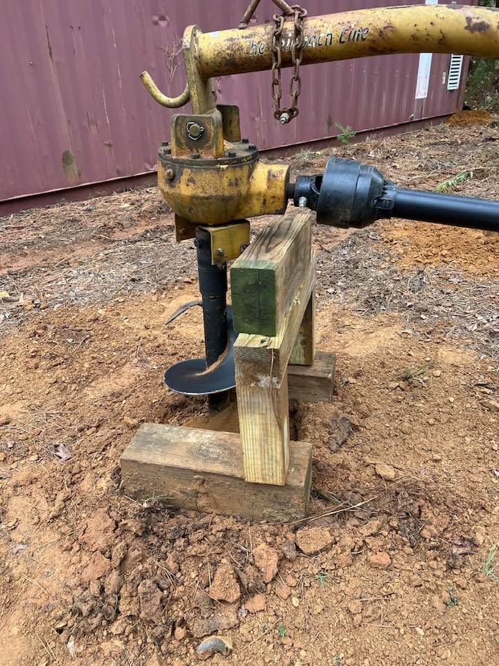

When I used my 37 hp tractor, I bottomed out all the time. At first I used a 36 inch pipe wrench to unscrew it, but I had to add a 2 inch metal pipe to the handle to get it going. It was very painful. Then I used my backhoe to pull it out. That was easier, but the hole became twice as big when it came out. Then I got the idea to put blocks under the gearbox of the auger so it wouldn't go all the way down, and I could keep it spinning. This worked great. Kind of a pain to have to put the blocks in place, but it worked 100% of the time.
