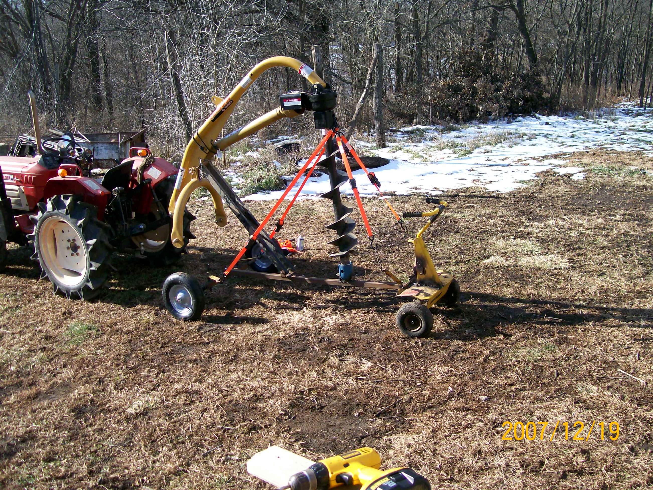

Here's a picture to wet your whistle...
Pete

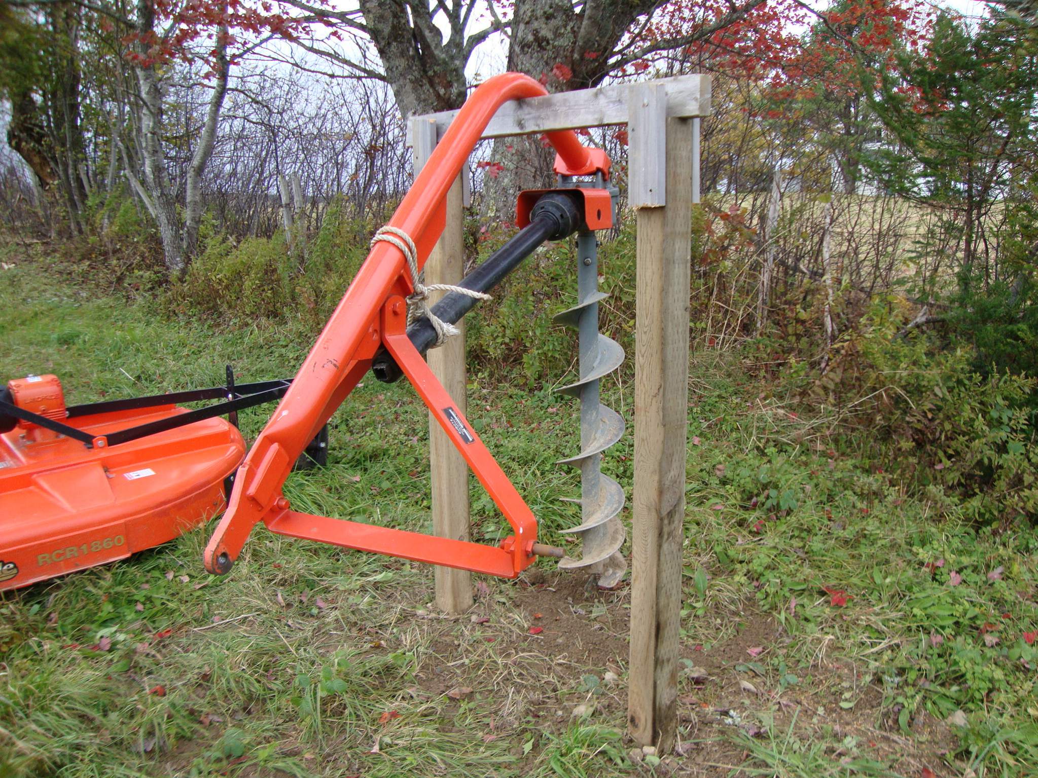

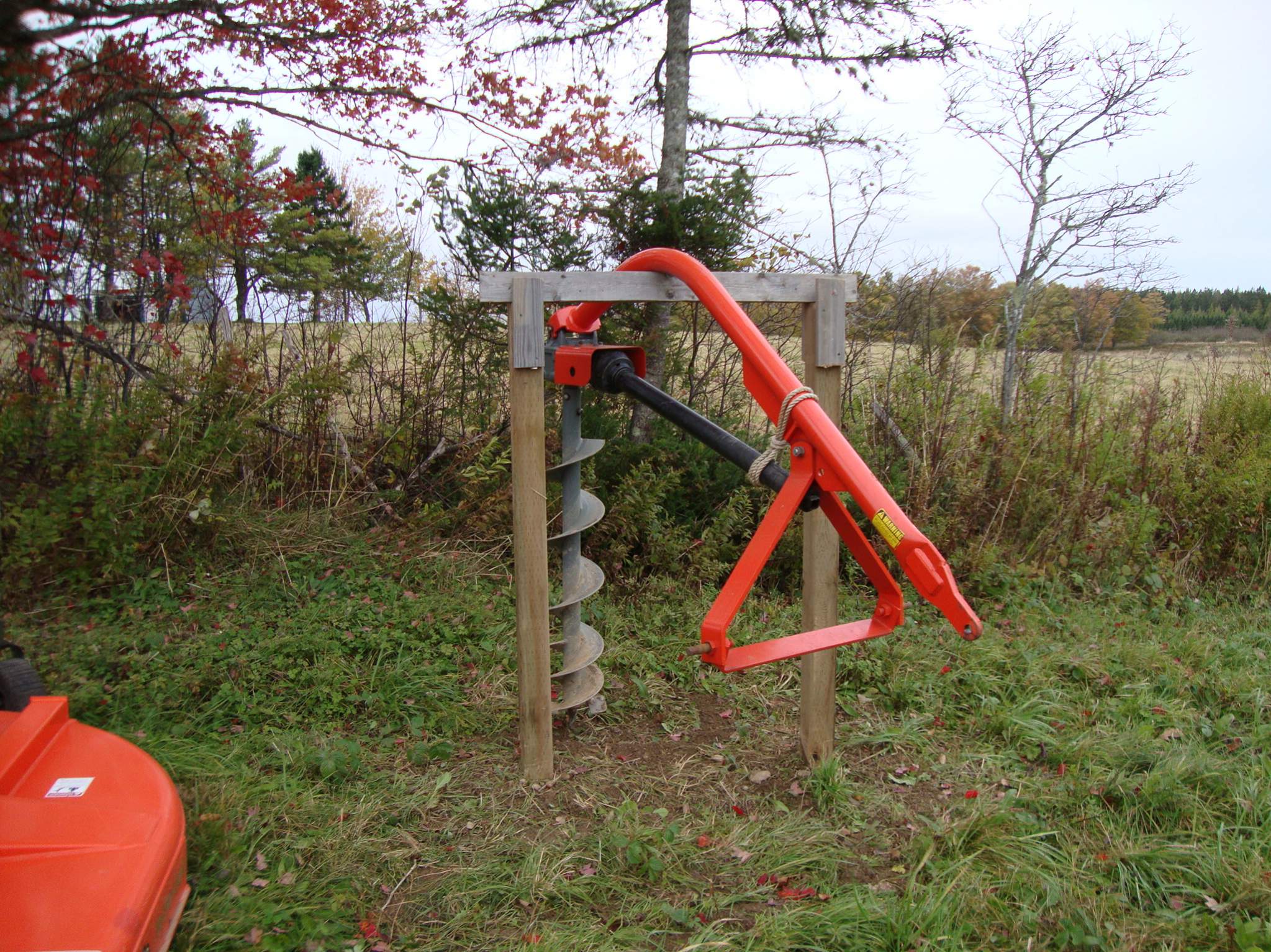

Here's mine, if yours is really heavy you might want to use 6x6 posts and a 4x4 crossbar. You slide the crossbar out, back into place, put the crossbar back, lower the PHD, unhook, then drive away.

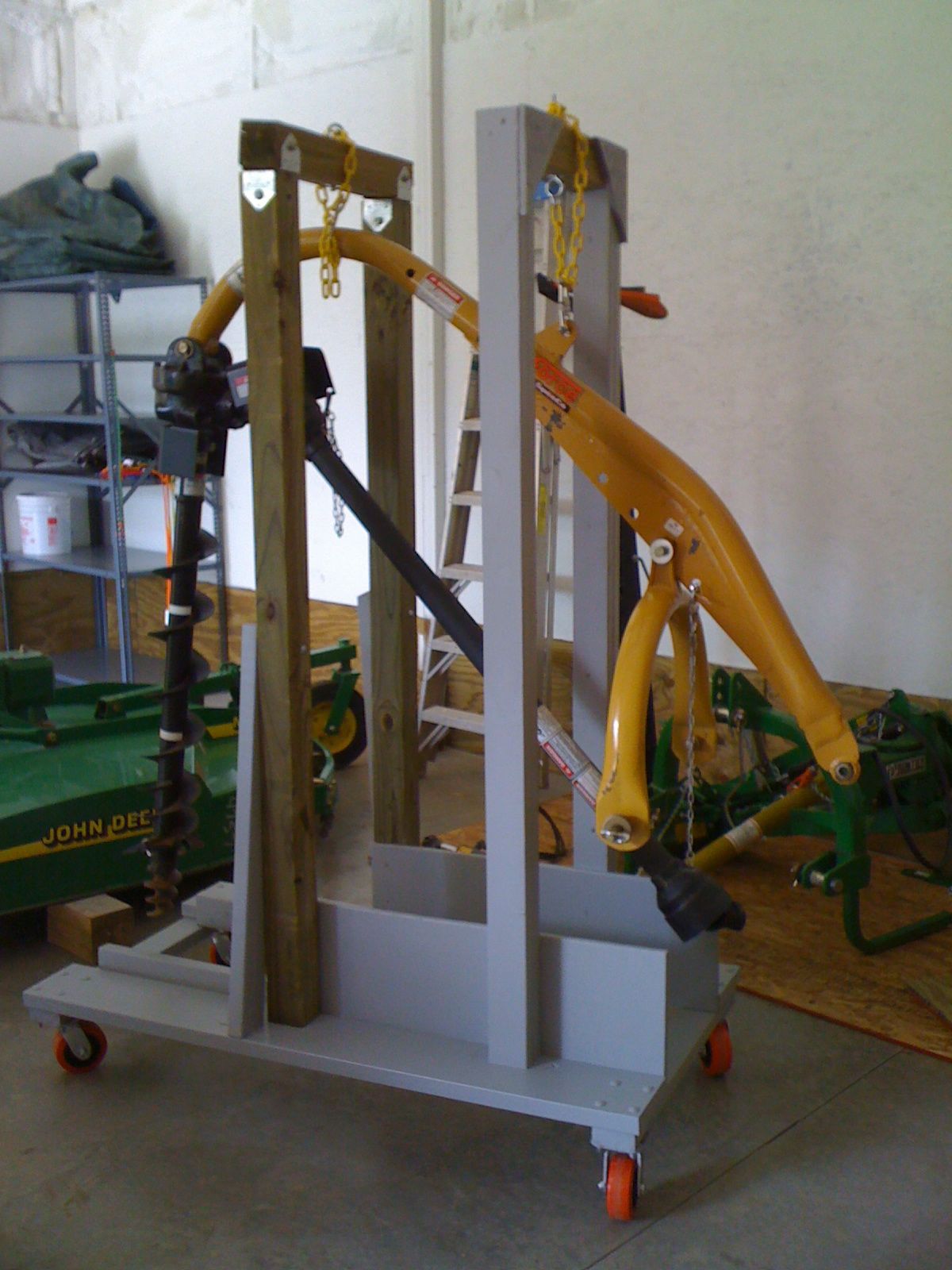

here's mine , russ
Sean
Sean
Nice PHD,etc. :thumbsup:
I'am guessing you keep the other half of the PHD pto shaft in the barn.Also judgeing from that knot in your first picture,you were either a sailor at one time or a "professional hangman". :D

Thanks Boone.. the PHD is fairly old, at least 15 years as far as I know. I got it last spring and overhauled it. It had been dug into the ground for at least two years, maybe more, the previous owner couldn't remember the last time he used it. The exposure to ground and water didn't seem to bother it one bit. I just brushed the loose rust off and slapped a coat of rust paint on the whole thing, put some new bearings and oil in 'er and she works good. Sold under the Kubota name, made by a company in the States.
I don't like leaving the whole PTO shaft on any of my implements, to me it's like leaving the keys in your car.
