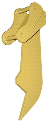

Bob, while you are in the welding mood, one of these would come in handy for removing roots. All the power of the machine is concentrated in a small area.

I kinda made one. I took an old bush hog blade and welded it to a 2 inch hitch. It works pretty good in very limited testing. The one you showed has a better shape for root pulling. I could grind the bushhog blade to look a little like it.
