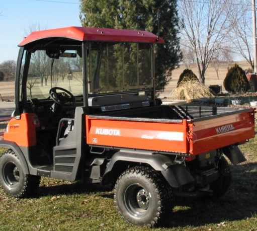

Dean
Side note some folks are dissapointed with the forward speed as it is limited to 26 MPH (plenty fast enough for work applications), My solution was to rename mine " The Go Faster" I noticed on another forum the nick-name is catching on and recently I have even heard a customer asked if he could get a demo in a "Go Faster" I allmost fell over , Are You Listining Mother Kubota???
