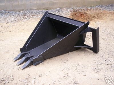

I built a ''grubbing bucket'' similar to the one J J showed in the thumbnail, but mine does not have teeth and is shaped similar to a shovel I use mine on a 425, it sees more use than the mini-hoe, I used a frame cut-off from a international semi roughly 11'' wide and 20''long 5/16-3/8 thick steel, the frame rail had to be cut with a plasma cutter, if I can find the original pictures I will repost them, eventually I plan to add a grapple to this bucket next summer just have not had time yet to fabricate

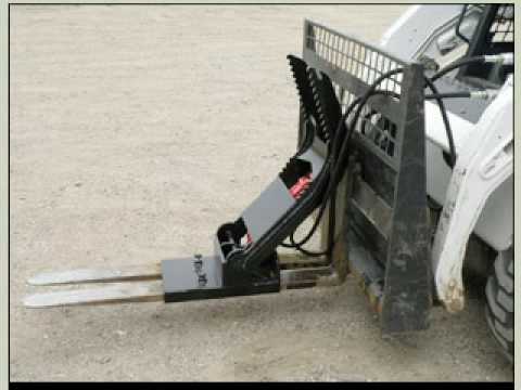

Here are some pics of grapples on a stump bucket.
Also a slide on fork grapple.

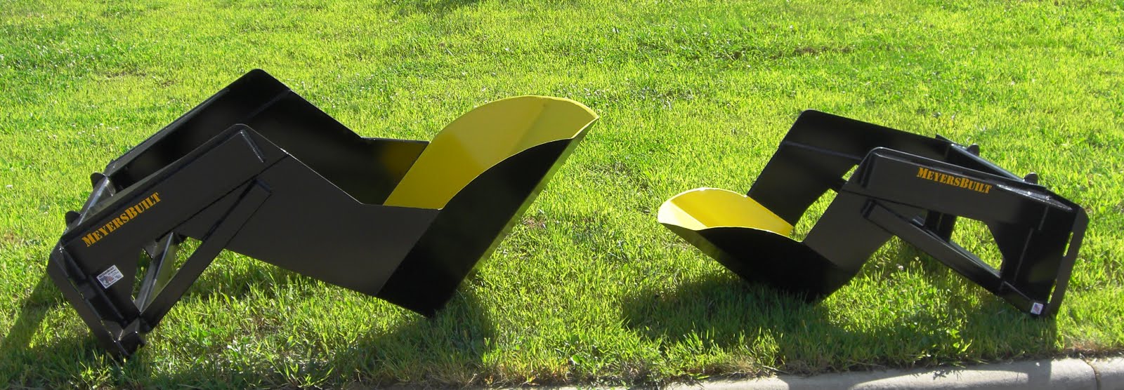

Meyers Built Skid Steer Loader Attachments: Skid Loader Attachments Tree Spades MeyersBuilt Tree Spoons
http://www.attachmentscjj.com/html/tree-spade.html
Most anyone should be able to make this shovel.
http://www.attachmentscjj.com/html/pallet-fork-spade.html
