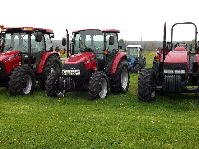

Anyone have any idea what size rims one would need to run the wider 13.6 tires like the euro version powerstars?
   / Powerstar T4.75 #197
Assuming you're talking about the rear tires, 13.6 would be narrower than any rear tire offered in North America.
If you're referring to the front tires on a FWD I believe they do offer a 13.6-16.1 8PR R3, but that requires 16.9 x 24 R3 rear tires, so you would be quite low with little ground clearance compared to 16.9x30 rears.
In any case, 13.6 tires mount on 12 inch wide rims. What are you trying to get it set up for?
   / Powerstar T4.75 #198
Yes I was talking about the front axle. The euro ones seem to run wider front tires for some reason.
