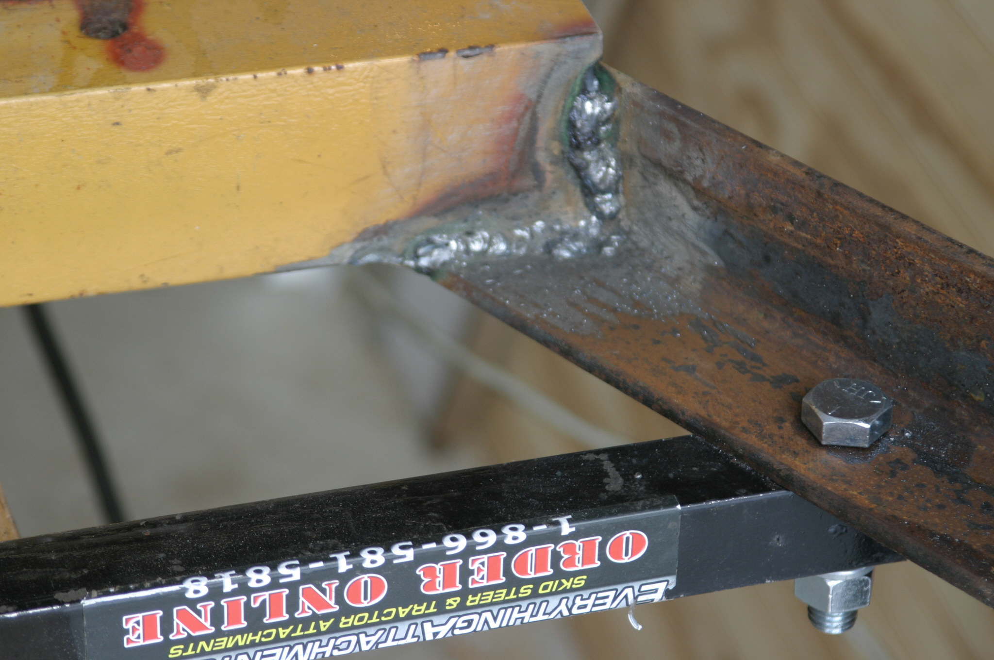

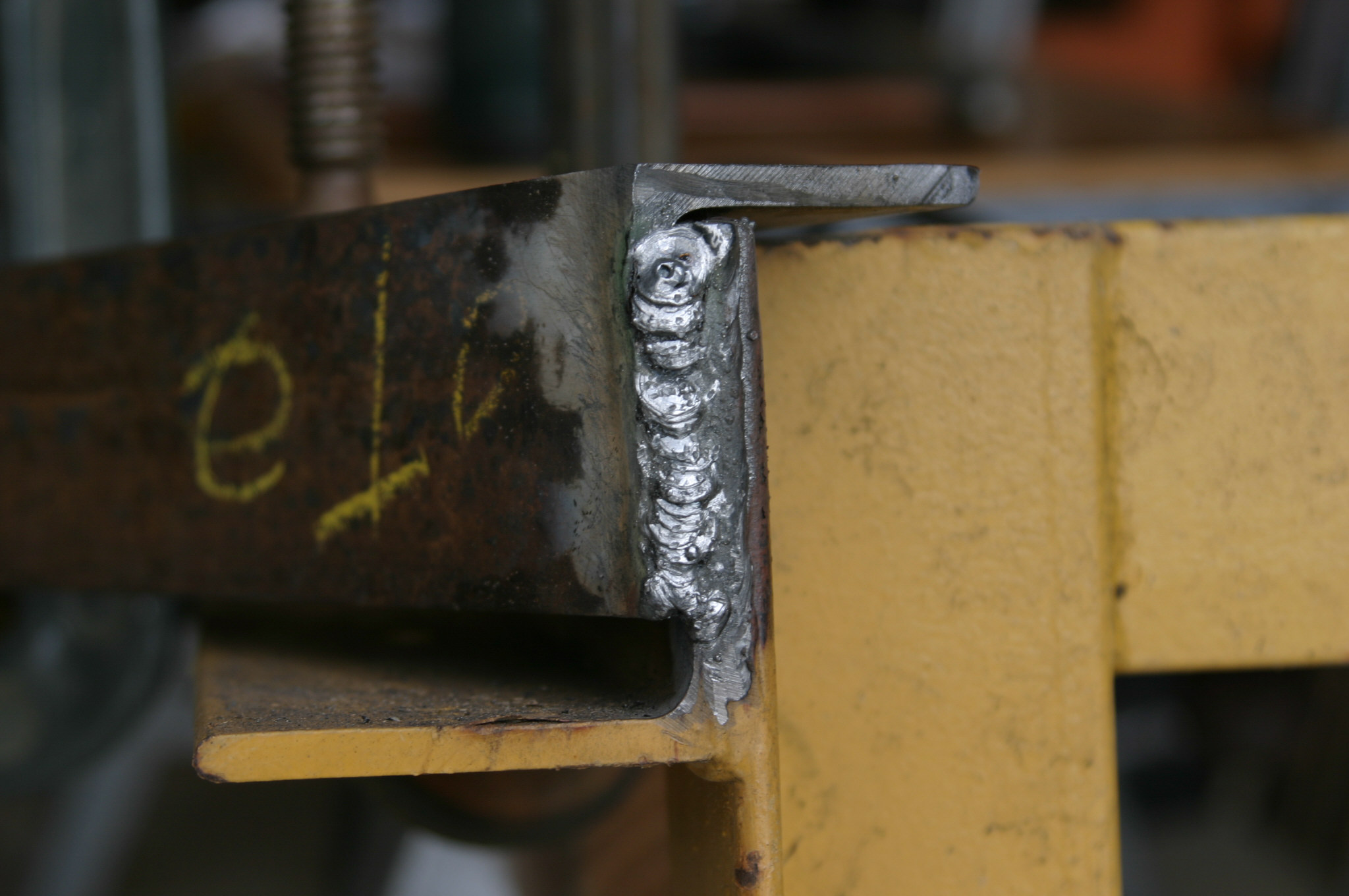

I'm welding some 1/4" angles to some 5/16" angles to alter a carry-all into a bedder wheel holder attachment. It's been really cold in the shop so I'll warm them up with the torch first. I've seen that 'flash over' but didn't know it was the moisture.. Thanks again.

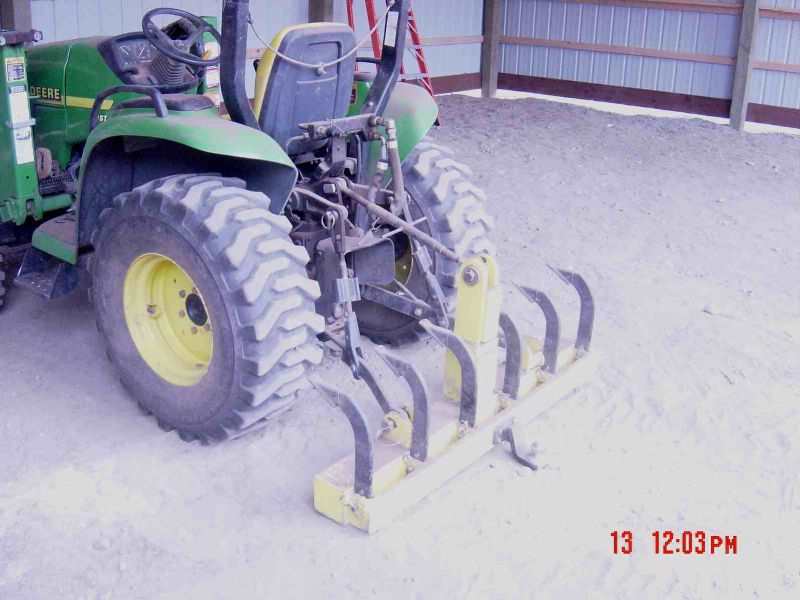

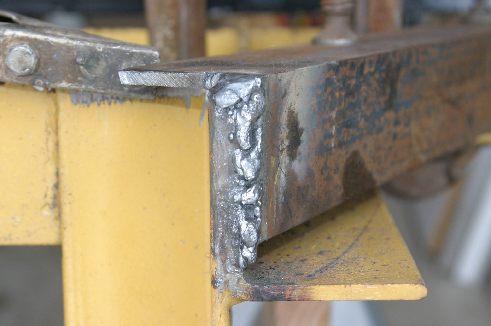

I think the last thing I built where I was concerned about preheat, is when I built my ripper / counterweight for my tractor. 5-inch x 5-inch solid square stock. Water really boiled out of this material! :D
5x5? How much did that puppy weigh? Probably helps it dig, too!
That thing is amazing. What did you use to pre-heat it?
Jim

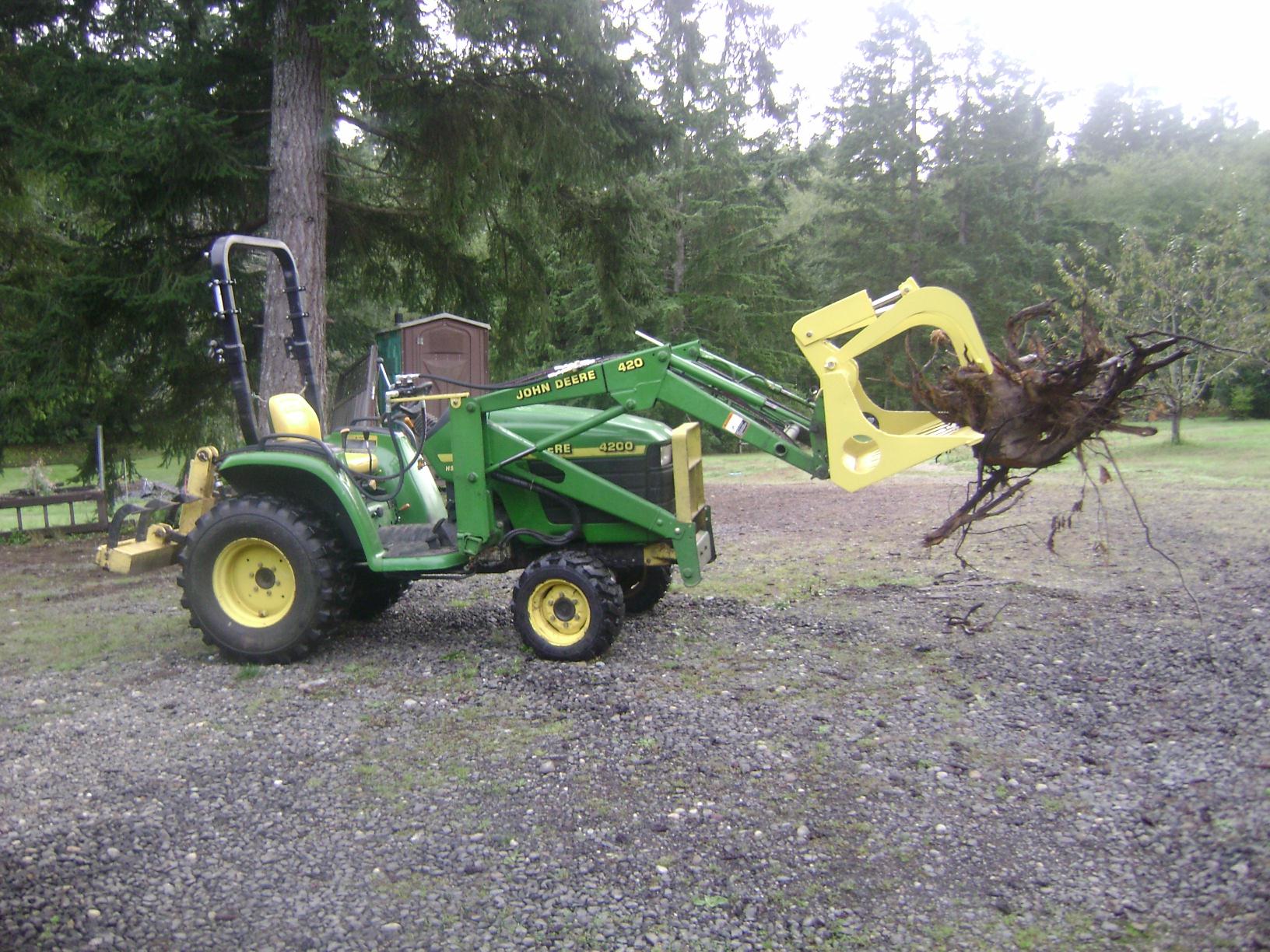

Jim I never thought to weigh it. I think that square stock is around 85-pounds per foot. I think the ripper is 5-feet wide. When I revamped a skidsterr grapple to fit my tractor I felt as I needed a little more counterweight, so I doubled up on it.
Jake when pre heating material I like to use the weed burner, but when heat shrinking, or heating material to bend, I like the oxygen acetylene torch / rosebud.
