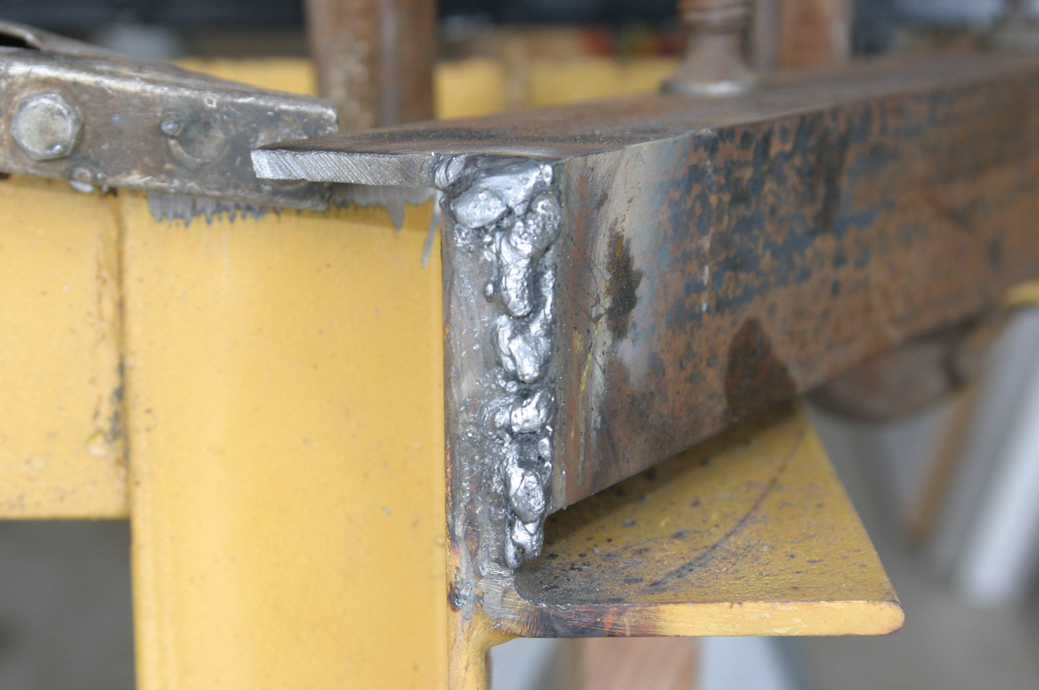

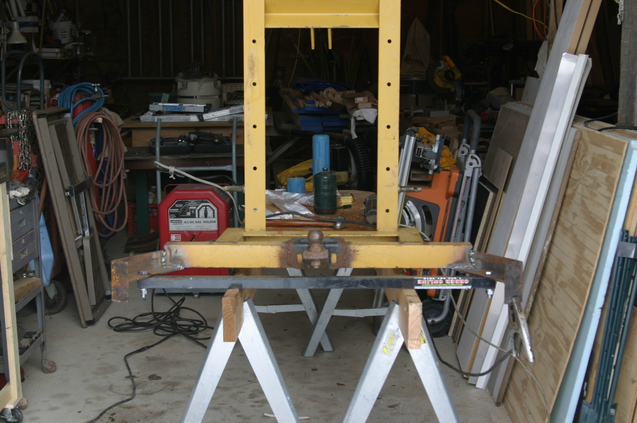

This will make you guys feel better about your welds. First pic: older 6013 rod with no pre-heat; #2: switched to new 6011 with p/h; #3 more big-bugger welds; #4 I think it will pull two 14" bedder disks.
Maybe Shieldarc was pulling my leg about the water. Wait till he sees my trim and tile work. :D

This was what I was trying to do.
Thanks to all for the input.
