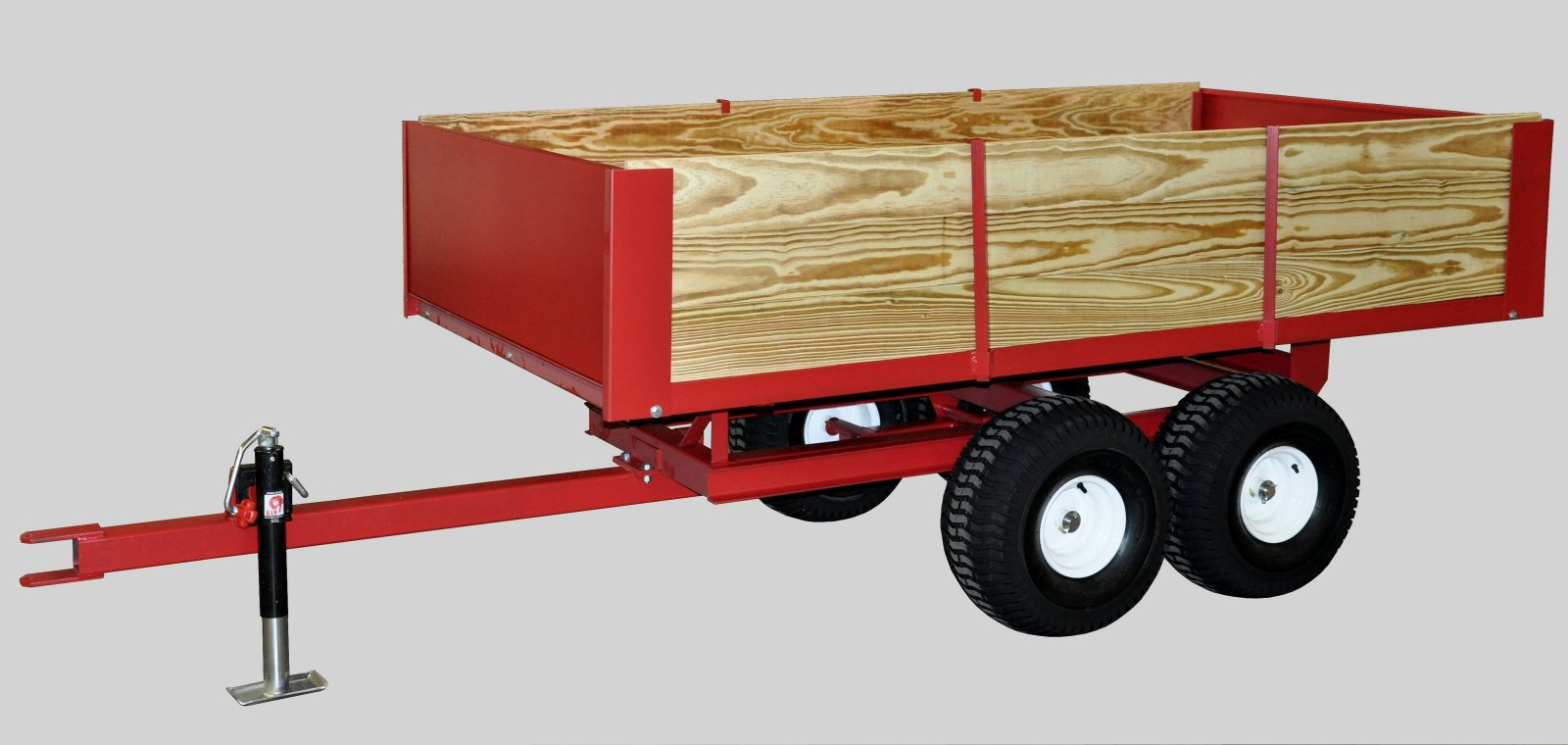

I've seen dump trailers at Rural King in the $3-4 thousand range. But theirs have the tandem-axle setup that you mention.
You got me curious, so I went and checked current pricing. It's $2200 today, which I think isn't much more than I paid... I seem to remember it was about $2k ten years ago. They also have the tandem axle version of the same:
They also have lighter 1-ton variants... but why? :ROFLMAO:
Would be much easier to back up -- as you mention. But I like the setup on yours with the wheels spread apart and steerable on front because of the stability. Yours is setup like a farm wagon as opposed to a trailer.
I have to admit, after more than ten years and many hundreds of uses of the thing, I've actually grown to prefer backing this trailer over the regular type, when I need to jacknife it into a tight spot like the porch I photo'd above. My tractor ROPS would never fit under the porch, and the extra point of articulation on this wagon allows me to get the wagon farther under cover, with the tractor still away from the porch.
I couldn't do a slalom course in high speed in reverse with this thing, the way I could easily do with a regular boat trailer or utility trailer, after so many decades of pulling those. But with a little extra thought and practice, backing these little farm wagons up really isn't all that difficult.

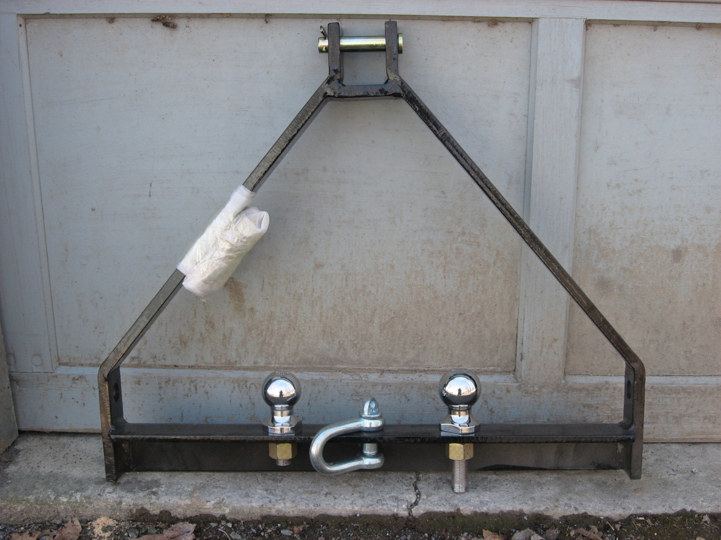

This is my set up. I made the 'A' frame using scaffold pole. The tractor is only light and I use a small double axle car trailer to collect wood. The draught arm pins were bought off Ebay, All works well.

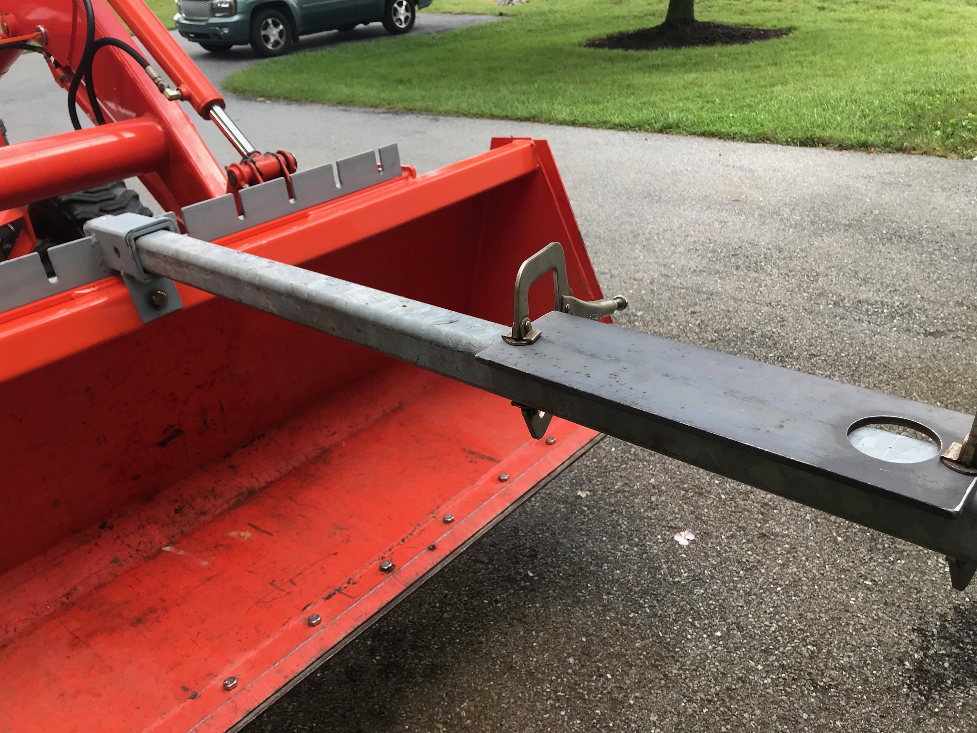

I put the hitch on top of my FEL bucket. Instead of backing the tractor, you can drive forward and push the wagon backward.
I did the same, when I first got this wagon. You're right, it's definitely easier going forward, at least when the wagon is light or empty.
But pushing uphill and making sharp turns in snow or frozen grass, the tractor tends to slide around a lot when trying to push from the loader bucket. Ultimately, I just learned how to back them up, and find it works much better for my case of a heavy wagon going up a slight hill.

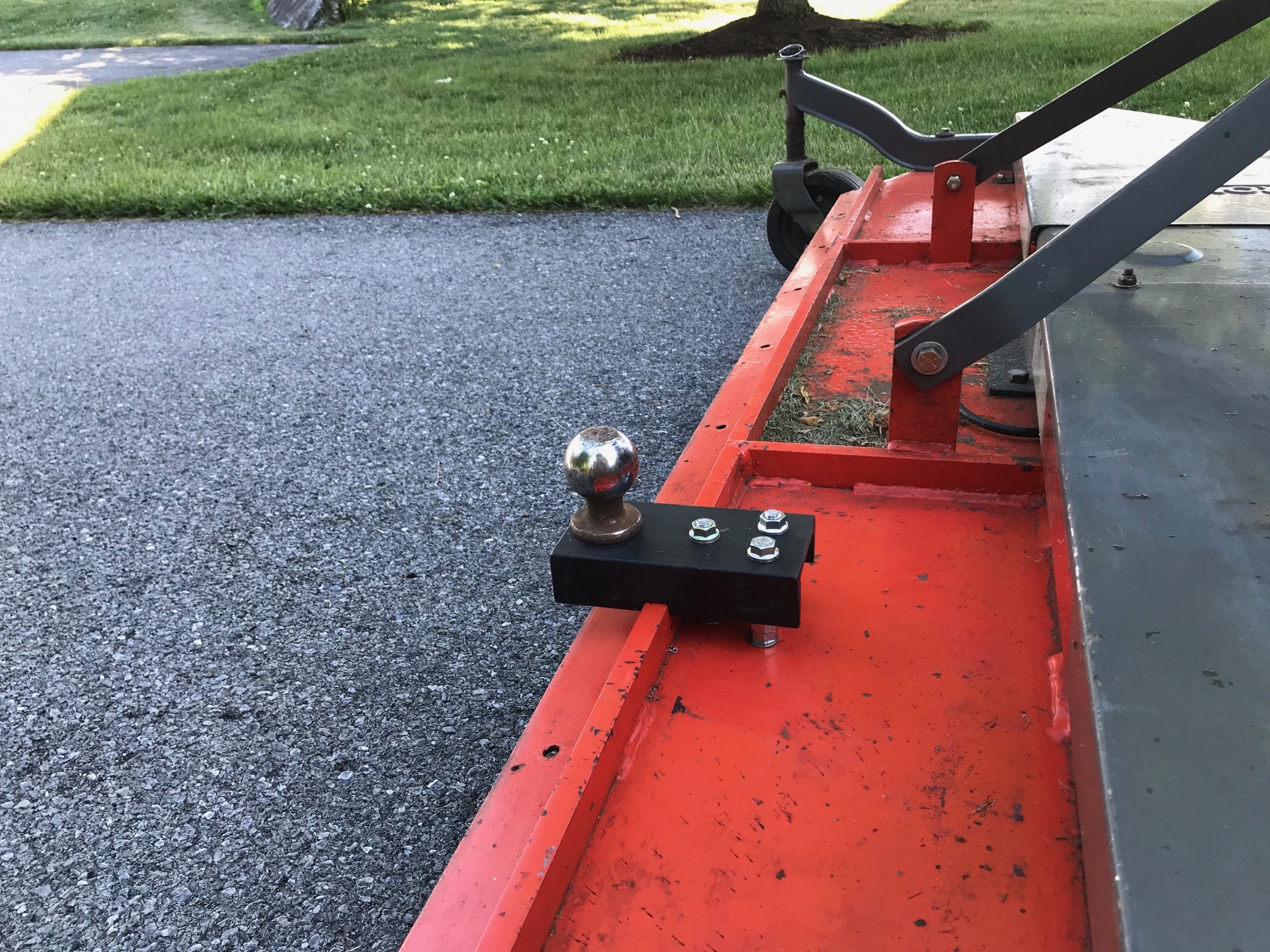

For moving the small utility trailer and generator around to mow, I use a ball that's mounted on the RFM. It's perfect for backing up and using the 3PH to raise and lower the RFM and relocate the stuff to a spot that has been mowed. It is NOT for moving anything serious.

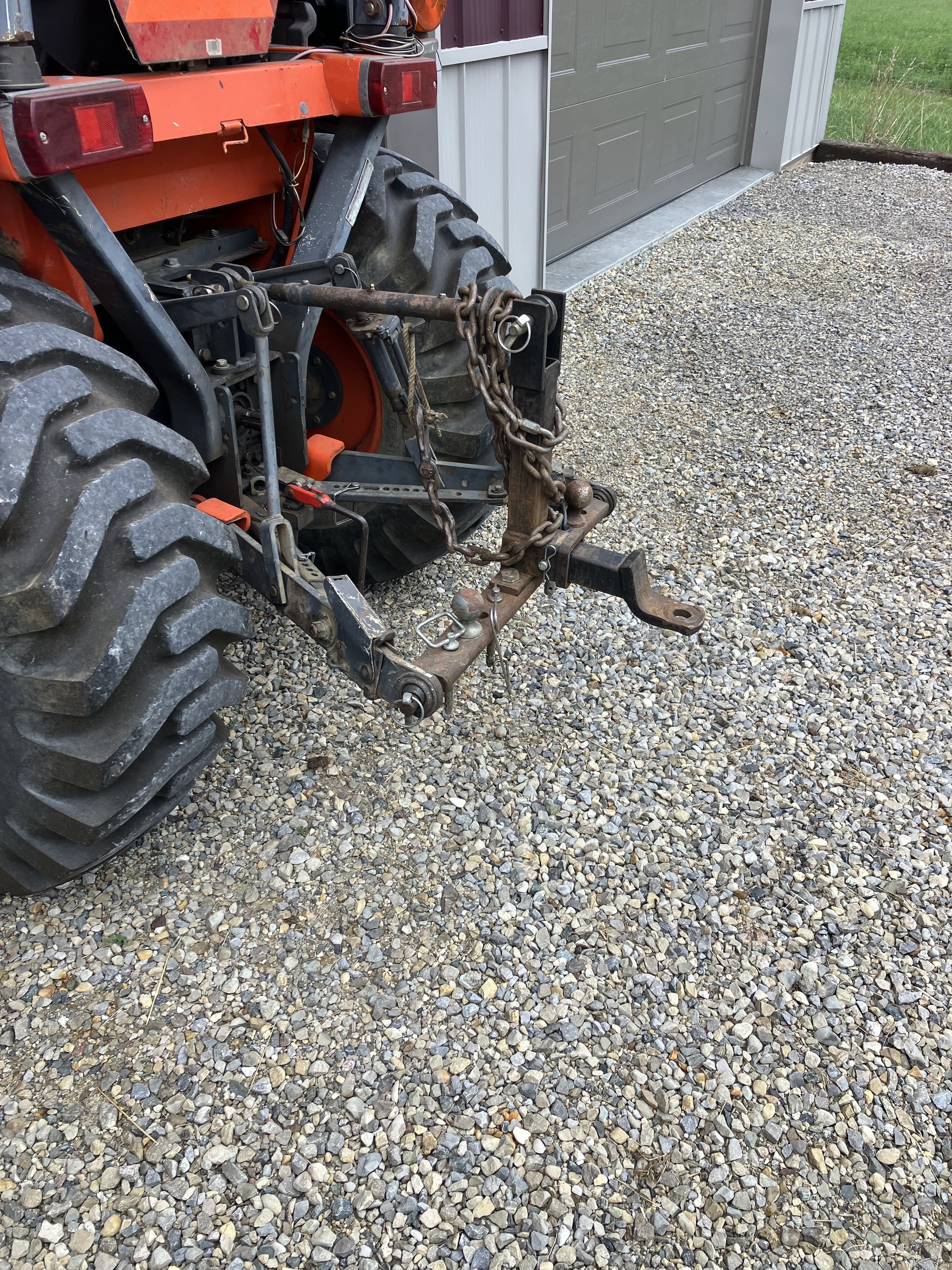

For the loaded trailer, etc it is always one of the fixed mounts. I did have a mount for the 3PH that I wasn't at all happy with because it could ride up. On the rear of both tractors there's the beefy drawbar. On the Kubbota I added a receiver to the front frame and the FEL. Sometimes they can come in handy just to hold things to work on them.

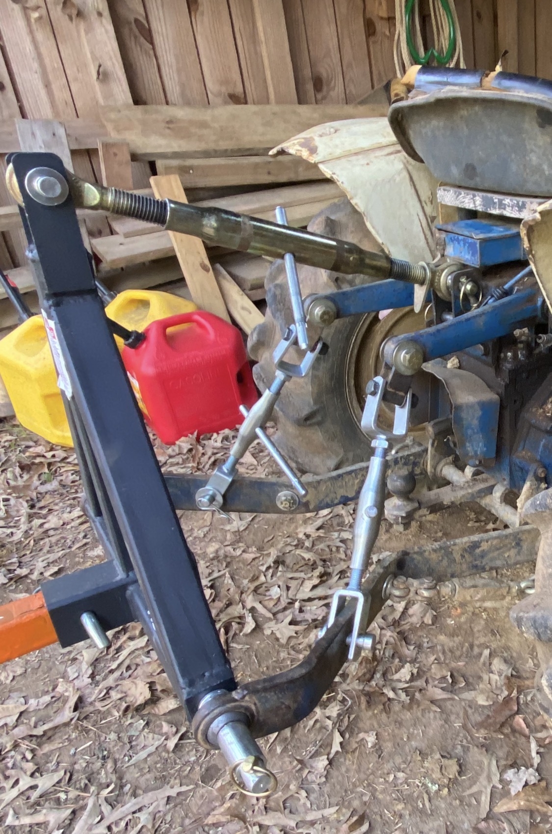

I have a 5x8 trailer and this got me thinking, I'll probably just get this & put a ball on it.
That doesn't work, because it rotates and when turning, the ball doesn't extend behind the bar, so it is rough on the trailer hitch. I have one of those with a triangle welded on top to connect to all 3 points. In retrospect I should have bought a real 3 pt receiver and wouldn't have to fix my trailers as often.
