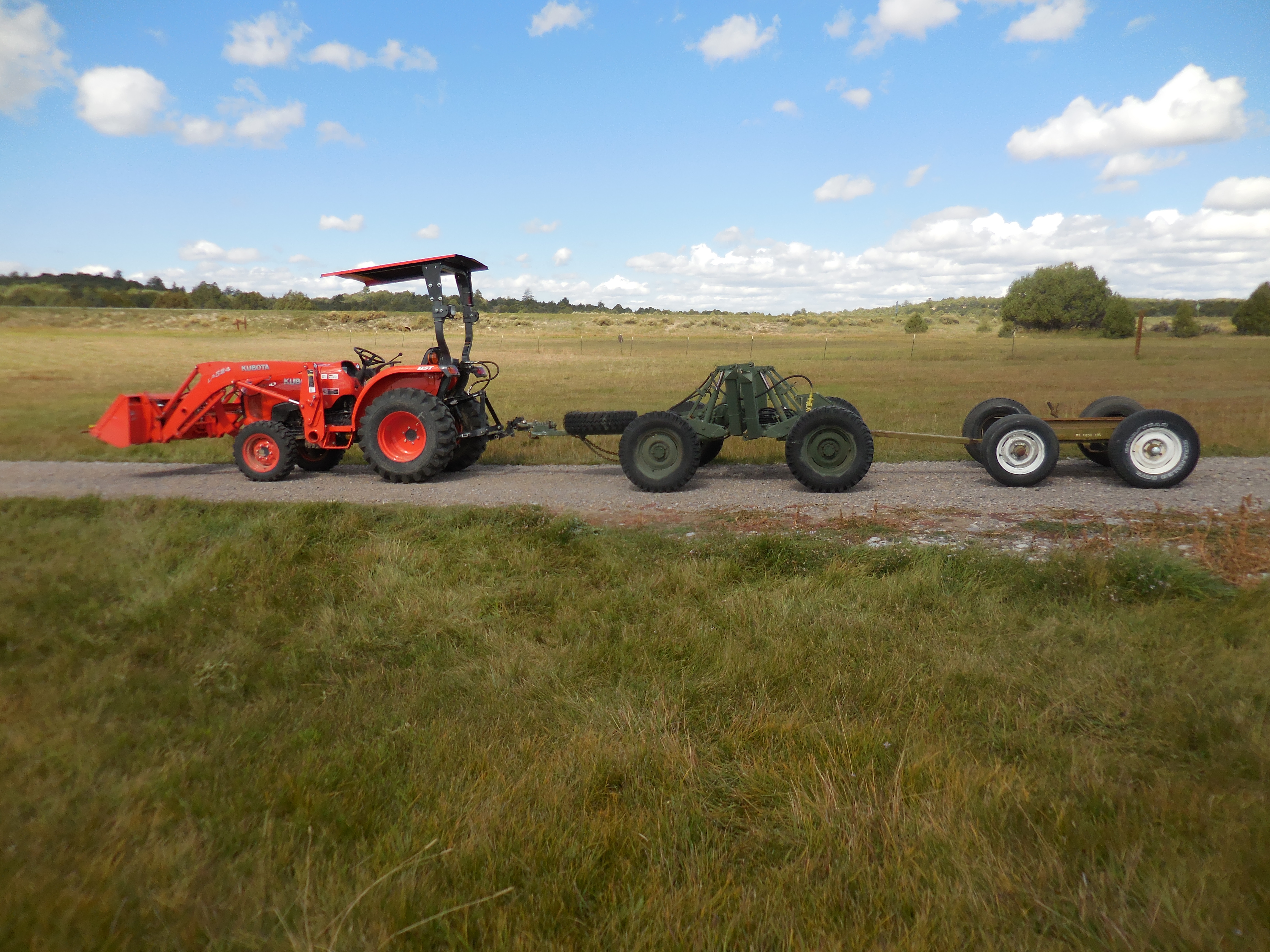

I hooked both my trailers up once, then tried to back up in a straight line. Needless to say, I failed miserably.

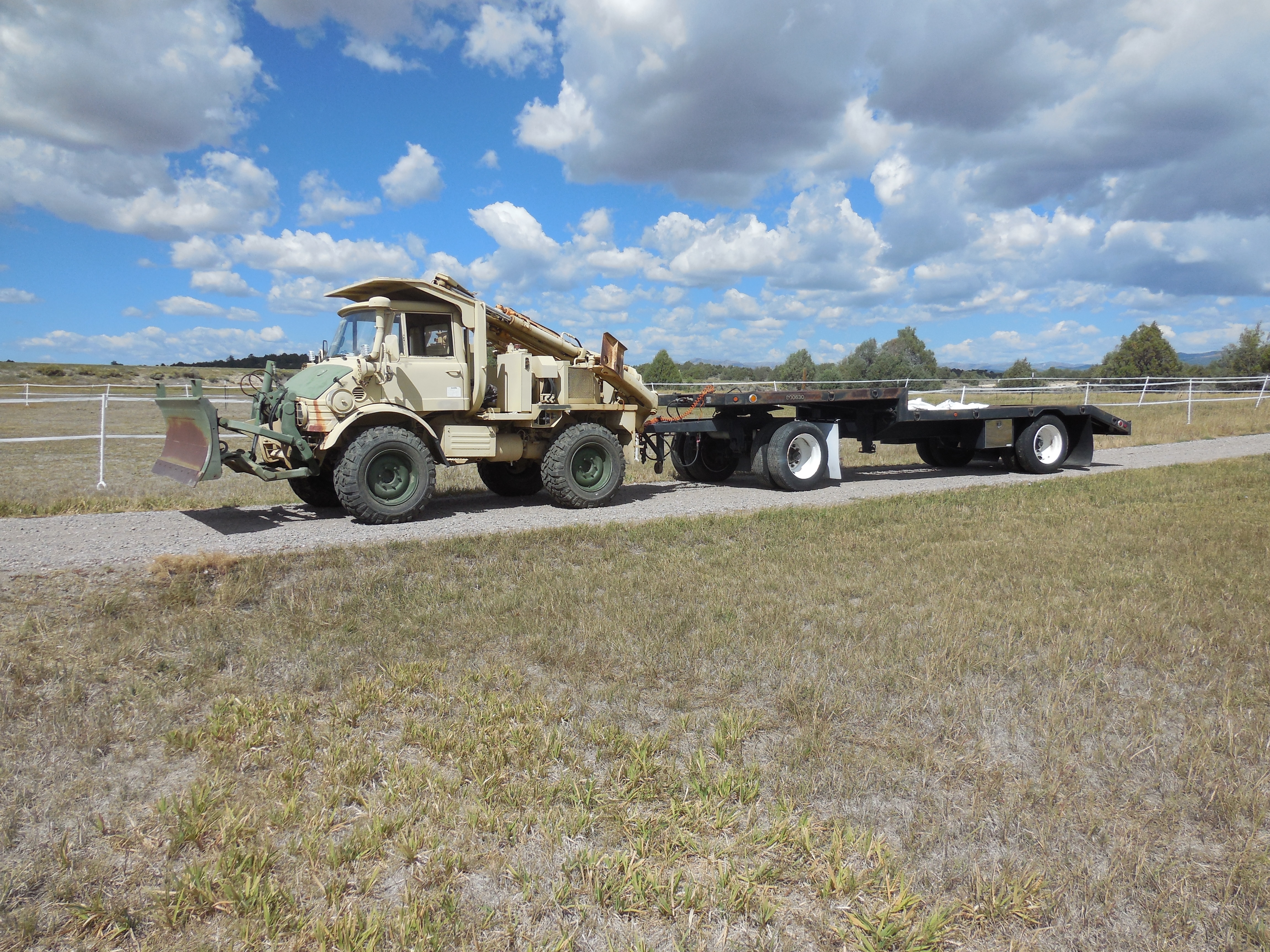

With four pivot points as above, I sure can't back up...at all. With only two it's relatively easy. This flatbed is a semi trailer, but by using a con gear it effectively becomes a trailer.

You're close. A trailer carries its own weight, a semi trailer does not.
I hooked both my trailers up once, then tried to back up in a straight line. Needless to say, I failed miserably.View attachment 5712443
With four pivot points as above, I sure can't back up...at all. With only two it's relatively easy. This flatbed is a semi trailer, but by using a con gear it effectively becomes a trailer.View attachment 5712445
No doubt! That's because it's impossible! Once they start folding up you don't know which way things are going to go.
