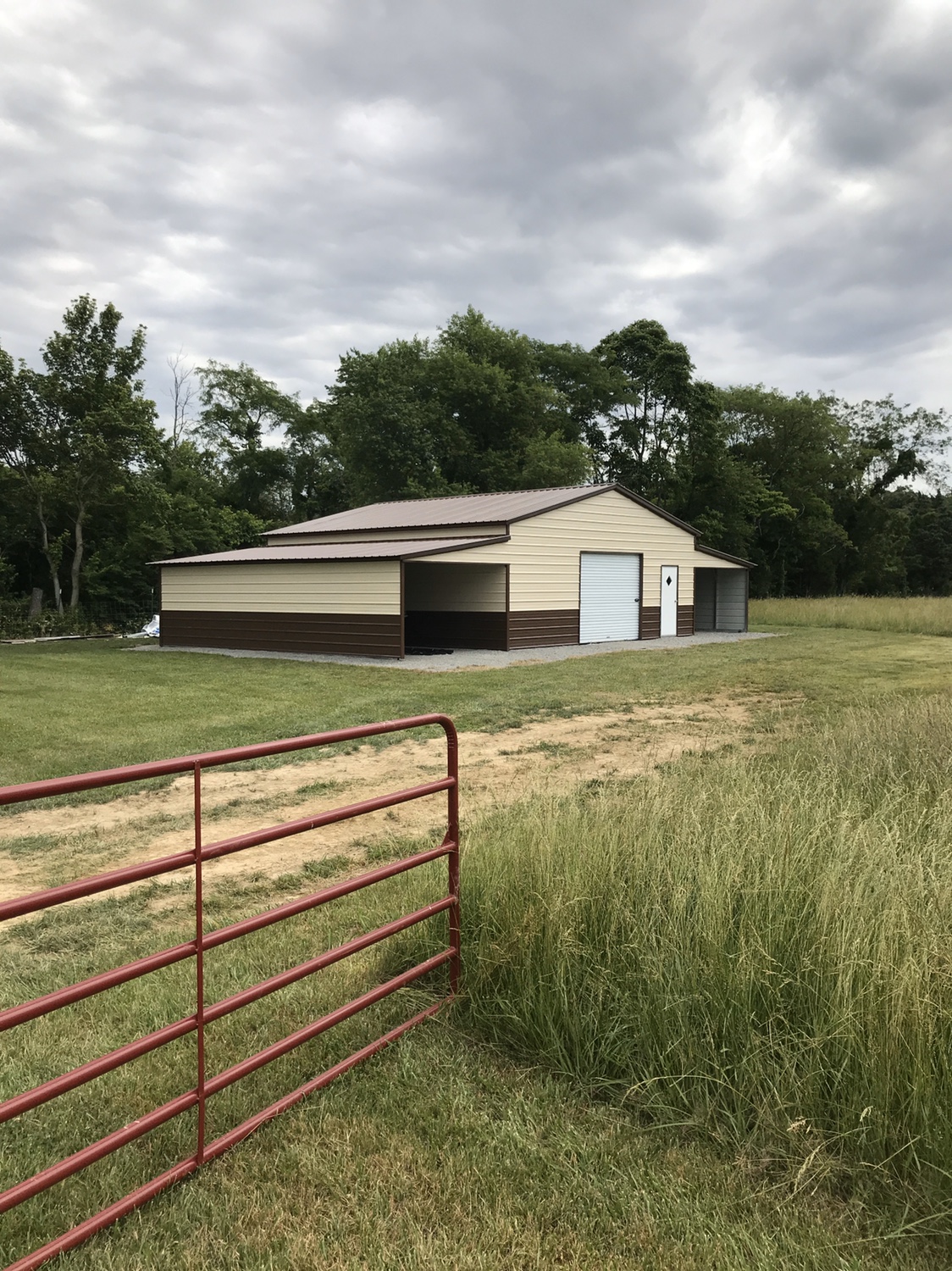

I had this built of a 4" base of limestone chips/dust over woven fabric. Had no issues from start to finish. Local seller and a regional assembly team. Went well plan on buying again. We've had several storms with high winds no issues.
Left lean-to give the cattle a place out of the weather. Right lean-to holds square bales of hay. Middle section holds all equipment.

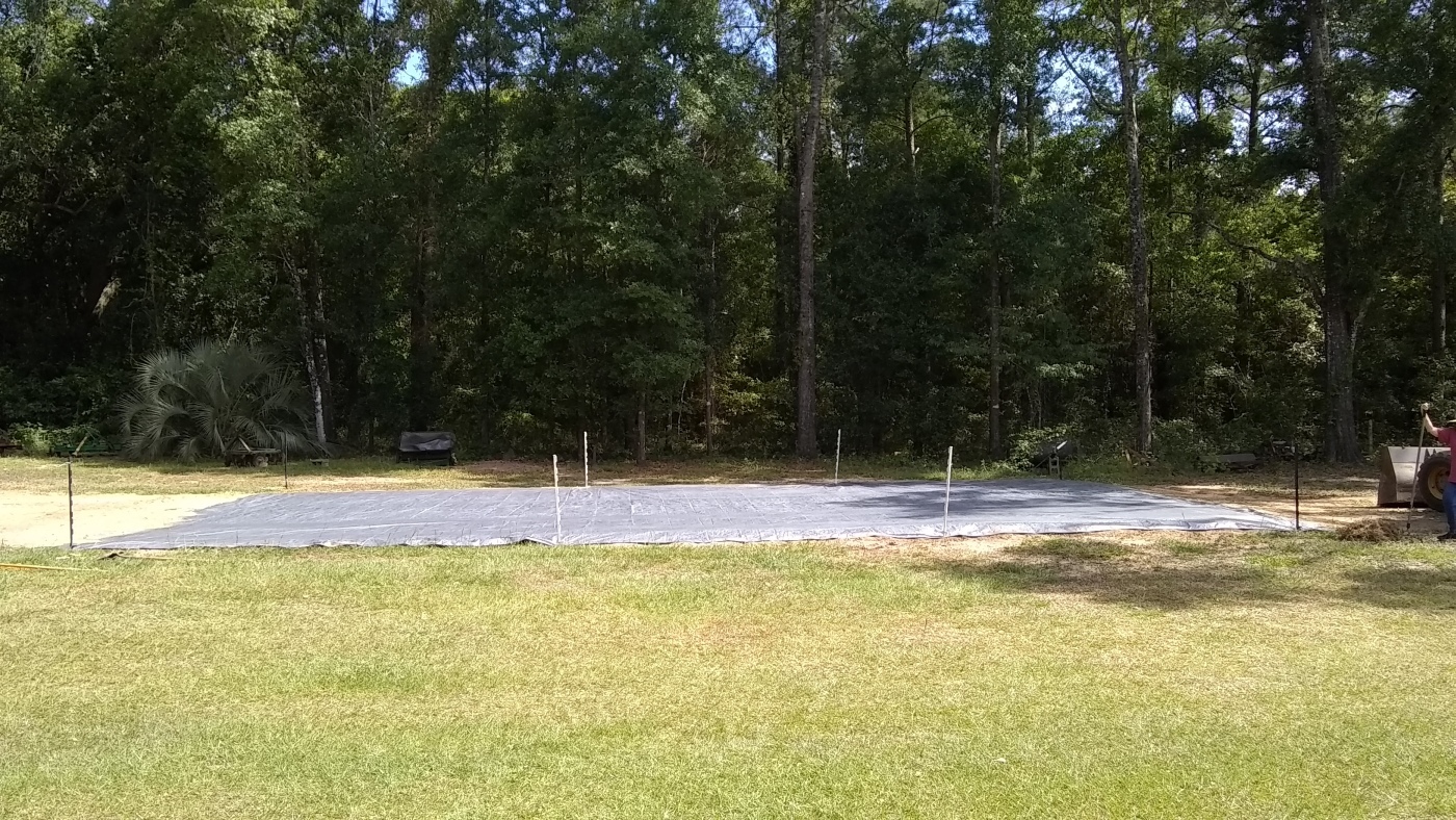

Looked at some different materials today. I think I'm going to put down a layer of crushed red brick.

Ordered a load of crushed red brick this morning. They were a little short of a full load so I will have to see how far I get. It just changes my approach a little. I will run 4 lines where the building runners will go and get them as level as possible. I can always fill in the centers later.
Also got a call from CC this morning wanting to know if the site was ready. I told them it should be by the end of the week and she said she would put the order on hold until I call back. Not sure if they had an opening they were trying to fill or what. I was surprised to hear from them this soon.
This is where I am on site prep. Got the base fairly level, packed, and covered with a 9 mil tarp.
