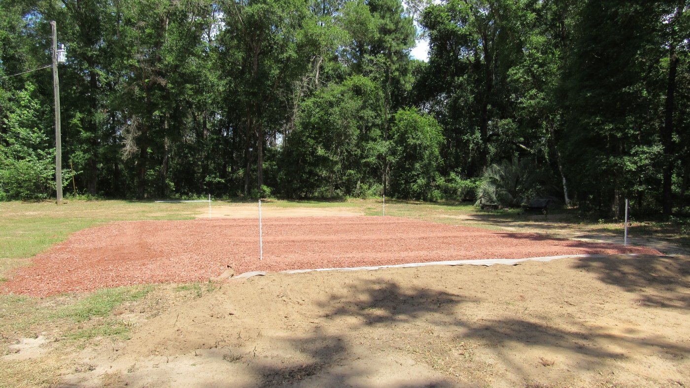

Got the site as ready as I can get it. I didn't have enough material to level the whole thing but I did four 4' wide strips where the frame rails will sit and got them within 3/4" of each other. Then I spread the rest of the crushed brick into the parking areas and just raked it out. I can add and level more later.

Looks good. Can't wait to see the build
   / Prepping for a Carolina Carports Barn #23
May want to tamp/compact it
Looks like you have AC power close by! :thumbsup:

I packed the added fill dirt by driving my 15000 lb backhoe over it repeatedly. I packed the rows of crushed brick with a hand tamper.

I thought I would add an update. We up sized the order to be 42x31. Don't know how i didn't figure it out before but I parked my backhoe in the center area and it was sticking out a couple of feet so I increased the depth. I had to send them new photos of the site after I extended to accommodate the new size.

SIL just came by and checked my foundation prep with a fancy Bosch laser level. All within an inch so I'm calling it good. CC says the legs have about 3 inches of adjustment. I might tweak it a little but it doesn't really need it.
I didn't want to trust my HF laser level setup but I guess it's okay for cheap. His was MUCH easier to use.
