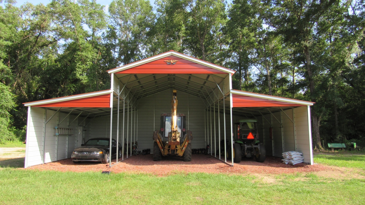

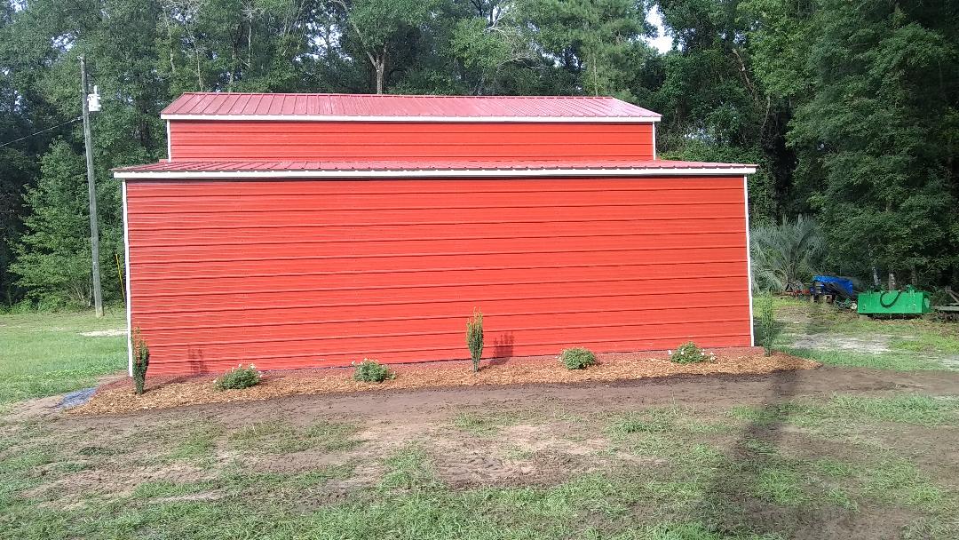

Did a little work to try and limit the moisture coming under the frame yesterday. Will still probably have to do gutters. Also did some decorating.
I pulled all the gravel out from the side and tapered the ground so it slopes away from the building. I put some 6mil plastic down and folded it up a couple inches on the side and out 2-1/2 ft from the building then put all the gravel back on top of that. That should prevent the water from seeping through under the frame but will probably result in a drip line in the gravel.
We also planted some plants along the side that faces the front of our property. I overlapped some landscape fabric on the gravel edge and out another 3 ft to further mitigate washout. We covered the landscape fabric with no float cypress mulch. It's supposed to rain all week so it will get tested.
Wife found this eagle at a junk shop and wanted it on the front.
   / Prepping for a Carolina Carports Barn #48
Looks like the grade on the left side is low ? Build that up and add a small berm ? Nice shed . Kevin .
#49
Yeah the land slopes left to right. Left side is the high side. I have it lower outside the brick line but I still need to do on the left what I did on the right.
They didn't have enough of the crushed brick to build a level pad so I made four 4' wide runners for the frame to sit on. When they process more brick I plan to fill the inside level and make a apron on the front.
