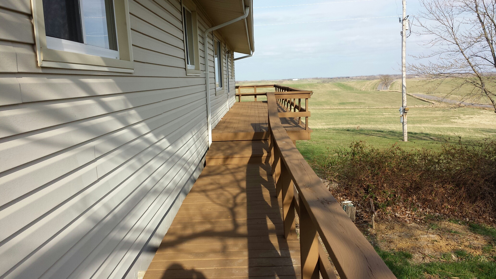

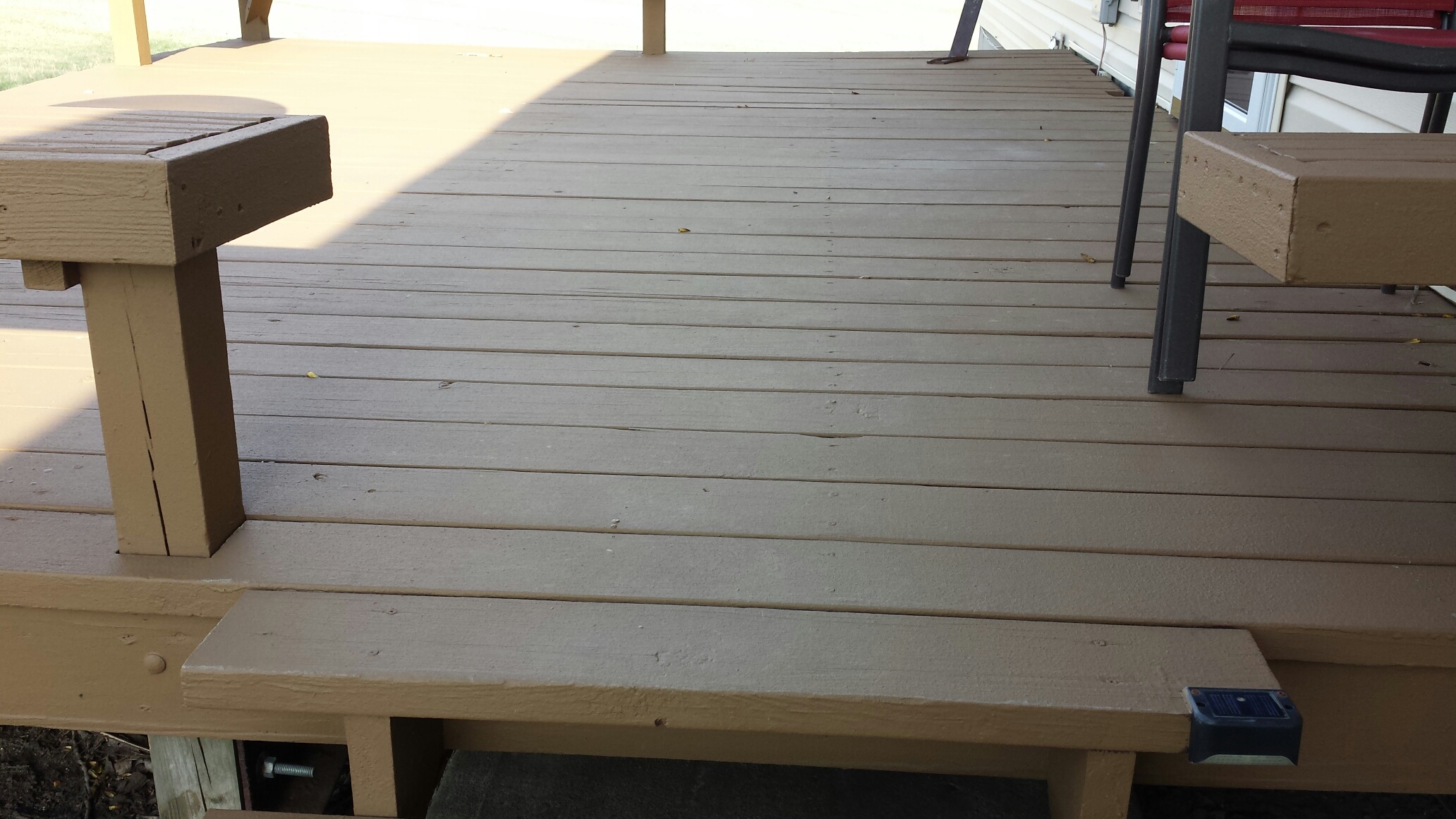

Olympic Rescue It. Has fine sand in it. Fills cracks larger than a toothpick the first coat. No splinters. Non slip. My front deck is 33 yrs old. Looks like it's good for another 33. It's the first pic. Second pic is rear deck, it's 15 yrs old. Comes in a wide variety of colors. Don't let price scare you. When you figure the coverage, it's worth every penny.
That finish looks good. Looks like it was just done. How long since you finished it and how did you apply it? Brush, roller or??
Two years, roller.
