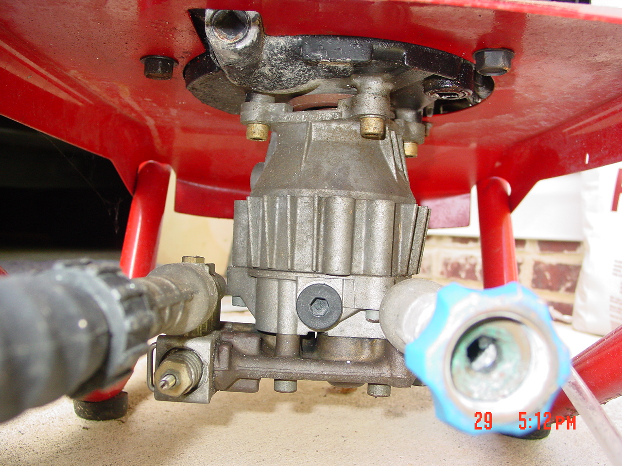

Are there any places that can repair the pump on a pressure washer? I have a Troybilt unit with a 3000psi pump that seems to have crapped out, a new one from TB is right at $220, plus shipping. Was wondering if there was somewhere I could send it to for repair? I know, most of them are not worth it, but if I could get it repaired for about $130 or less, I might be willing to go that route, especially if they give a like a 30 day warranty. Thanks.

Thanks for the link, and the other info fellows, you guys are aok. :thumbsup: Also been watching some vid's on youtube about repairing pressure washers. I suppose the unloader valve could be stuck open? On the picture of my pump, is the unloader valve that threaded shaft with the spring around it, down on the bottom of the pump? Or is that something else, maybe it sets the amount of pressure? If that is the unloader valve, would it be worth it to loosen it, and run it in and then back out to the same point? If it's not the unloader valve, does anybody know where it is at?? Sure would like to get this thing going by next weekend, got some time off and would like to do some cleaning up with it. Thanks.

I'm not familiar with that pump but when you find it you should take it apart and lubricated with white lithium grease.

Well, thanks to the link provided earlier by JimRB, if you scroll down there is an exploded view of the pump that does show that the threaded shaft with the lock nut and the spring underneath it is indeed the unloader valve. It's listed as Item A, "Unloader Kit", and if you zoom in, you can see where it's located at on the pump body. It also says it is a serviceable part. Guess I will see about taking that puppy out tomorrow and see if there's anything obvious wrong with it. I will load it up with grease for sure and see what happens, I can't make it any worse, right?

If that picture is your pump, it's a axial cam pump.
Unfortunately these do not last that long. I wouldn't put money into this unless you find a good deal. I would put the money towards a better PW w/ a triplex pump (preferably a CAT triplex).
I found a nice used heavy duty PW w/ a CAT Triplex pump for about the price of a new cheap PW w/ an axial pump on Craigslist.
